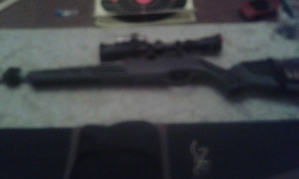

Any Viper Express owners out there? I have had mine for about two years now. It has a nitro piston conversion. Anyways. How long have any of you had yours and how much pesting/hunting experience have you had. What have you reloaded the shot shells with and why? I mostly reload with #7-71/2 and BBs as a mini "buckshot" I use the buckshot on larger birds like pigeons and it works well on rabbits

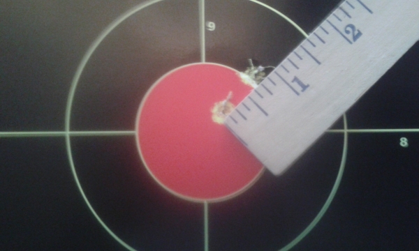

some of my groups
20 yards, with Predator Polymags
man that's pretty awesome. How did you riffle the barrel? Was the bore choked I've tried different things as the rear cup. I was some what successfull with those red cap gun caps but 30-40% of the time they would jam about 3 inchs from the muzzle. The other 60-70% where much more power full and the groups were much tighter. With 7 1/2 filled to the top of the shell topped with 2mm card stock. Do you still use shot shells? I kinda wish Gamo or someone else would build another with the newer more powerful gas ram technology and maybe go up to a 25 or 30 maybe be able to use 9mm/38 brass as the cartridge ....

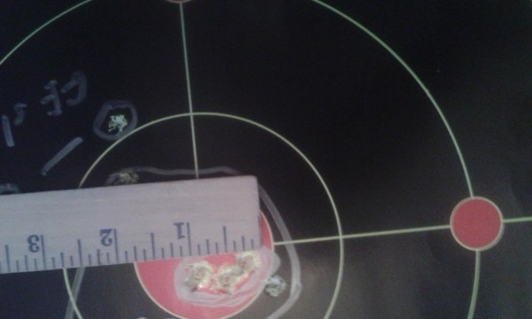

here are my original postings:
The first attempts with rifling, the button was too tight, but after diamond filing the button down a small amount, I could get it through the barrel without damaging the gun. I am very happy with the results. What used to be a 5 inch spread at 25 yards with pellets ( remember this is a smooth bore shotgun ) is now down to 1 inch at 25 yards, freehand. Now I can shoot relatively small groups ( for what was a shotgun, if you call it that) with pellets (no tumbling) and still use the very limited shotgun function….snakes!
