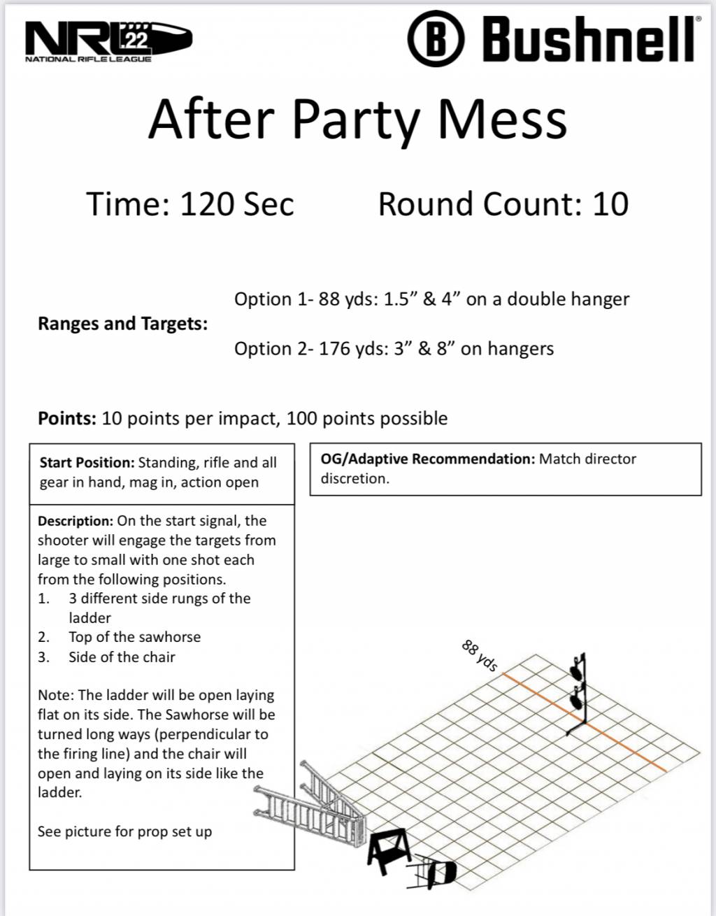

That looks like a lot of fun, really enjoyed the video. Could you post a link to that target. Thanks
I think the club orders those through NRL22.org as part of the official target set. They usually have two different sets of targets (in the CoF, they're referred to as "option 1" and "option 2"). Our club in Renton, WA always uses option 2:
