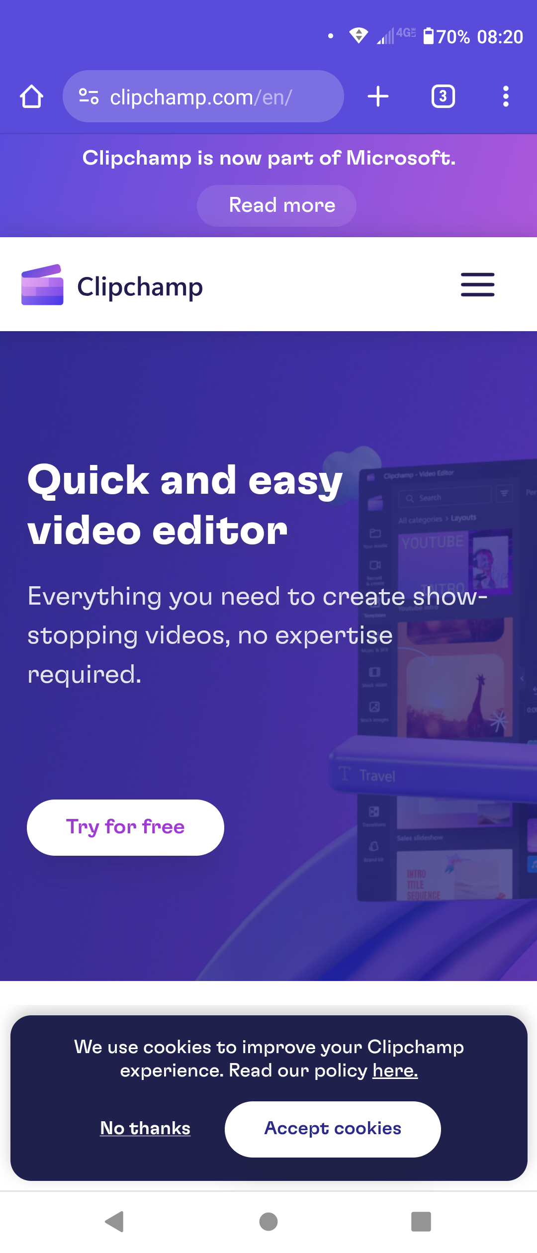

I just found clipchamp on my windows machine. It does what you requested. Get it FREE from the Microsoft app store.

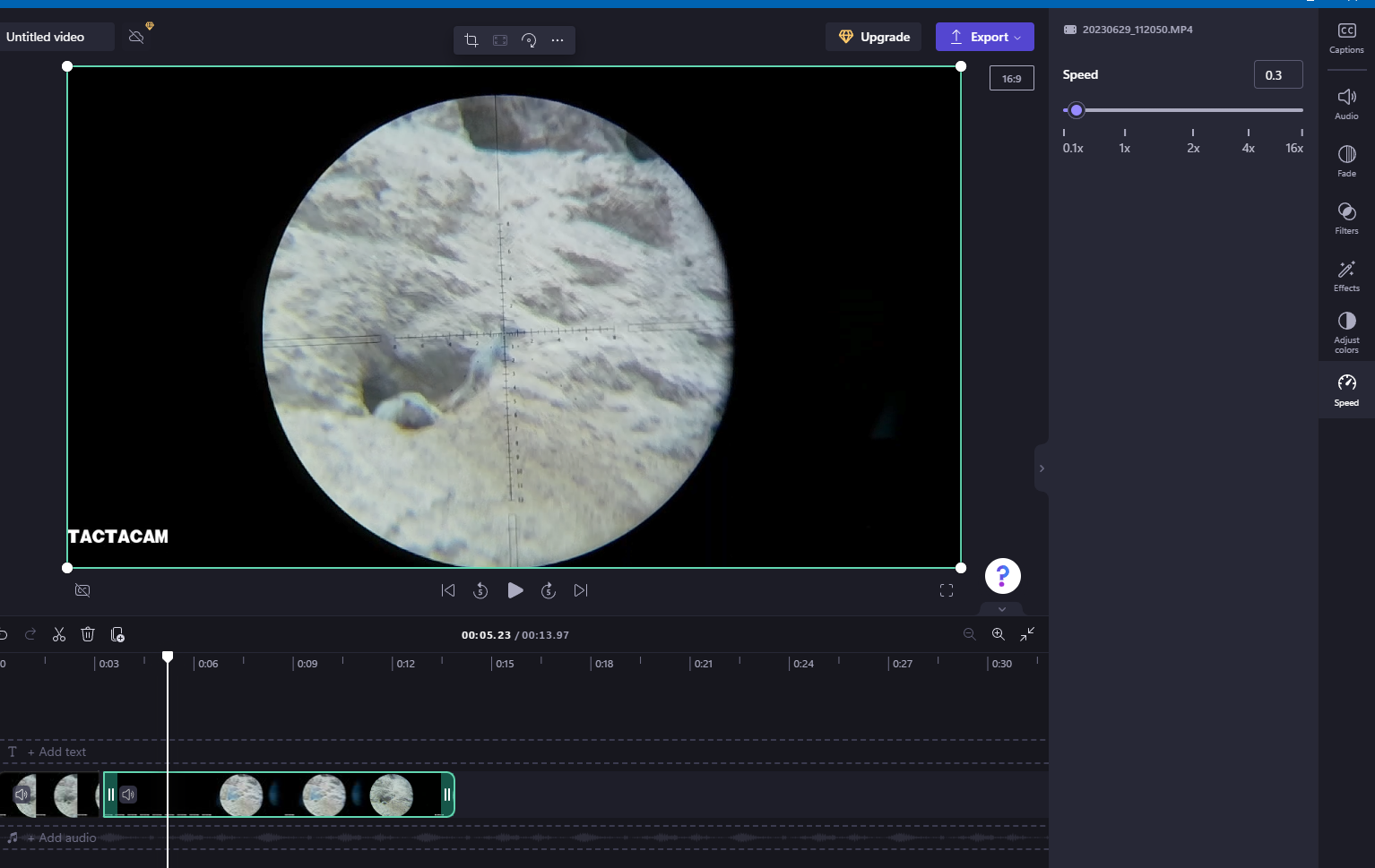

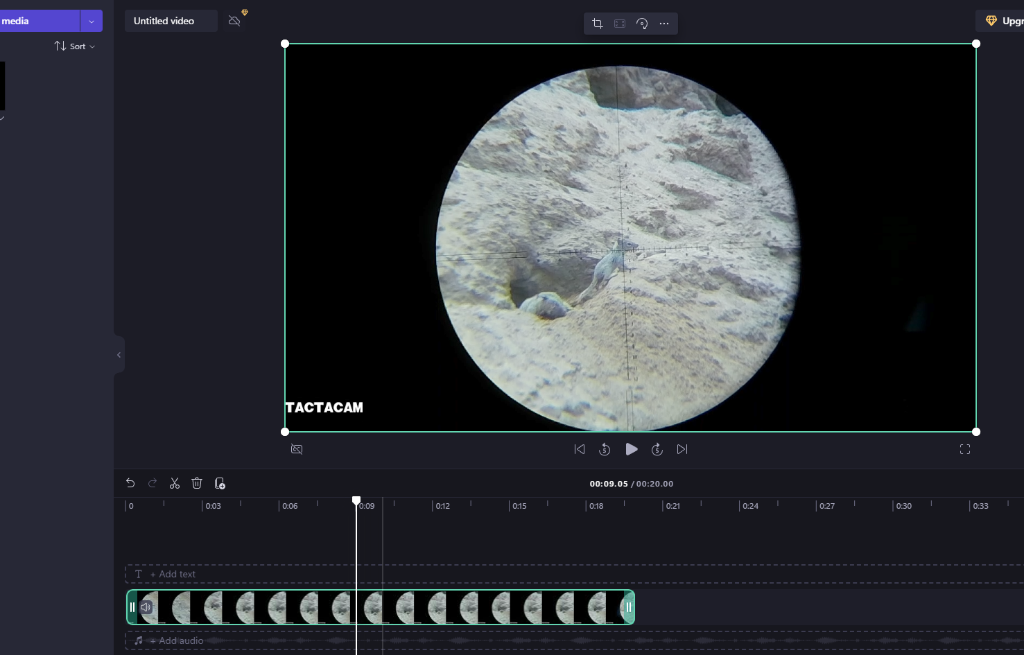

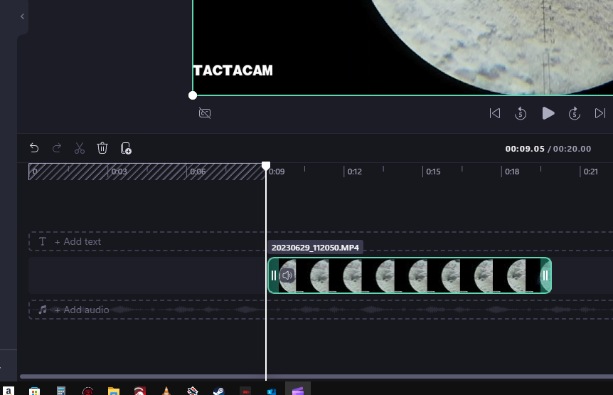

Here is how I would approach the question - full speed clip with a slow-motion follower.
Open a new file, choose the video you want to edit.
Find where you want to trim the excess off the front end of the clip - getting on target, focus etc.
Then grab the left side of the frames in the bottom window and drag to the right to trim.
Right click on the blank space that is left over - it will delete the empty frames.
Repeat the process for the right side.
I now have a 3.2 second clip
Right click (ctrl-c) to copy the clip, paste to the timeline (ctrl-v)
Highlight the new clip and adjust the speed.
Us the same logic to trim the slow motion clip for tight action
