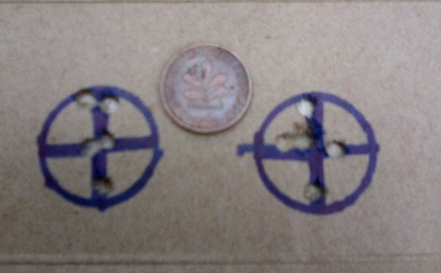

Shot tight 5 shot group yesterday with 177 H&N FT 4.51 at 20 yards but today a 5 shot 2" nice vertical string down the middle with same pellet. What causes that? On the internet, just talks about firearms vertical stringing. One post says you get it when you pull the trigger at different times in your breathing cycle. I am sure it is something I am not doing consistently but cannot figure it out. Thanks in advance for all replies.

Using iron sights. Did better today. Balancing the gun over a sand bag with a sock worked better than the palm under the end of forearm under a sandbag. Will try at thumb straight foward on next shooting session. Best 5 shot group at 20 yards was nickle size with H&N Light Match. Still some vertical stringing trying other pellets but definite it is my consistency of hold. Really liking iron sights on the HW35E.
