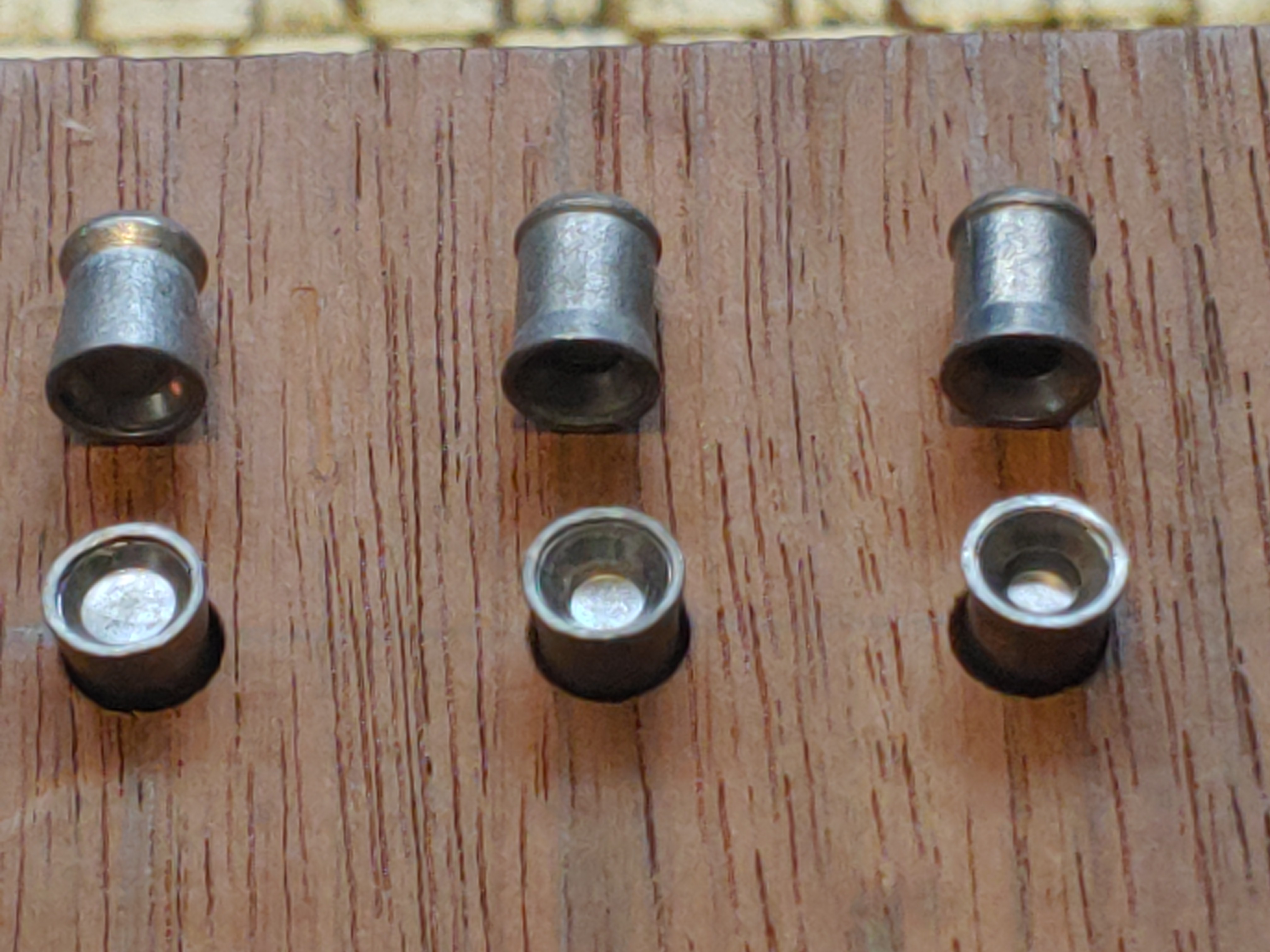

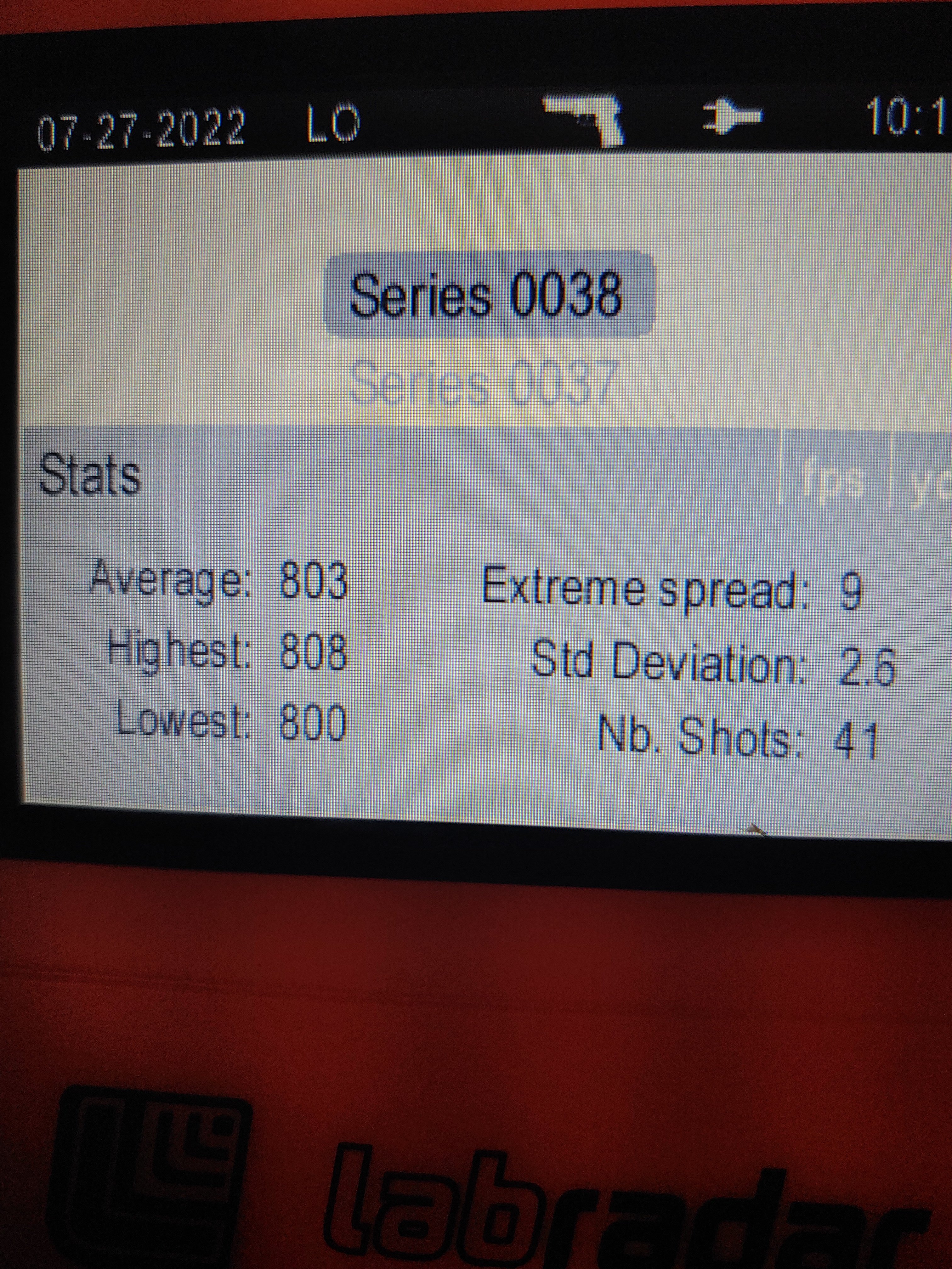

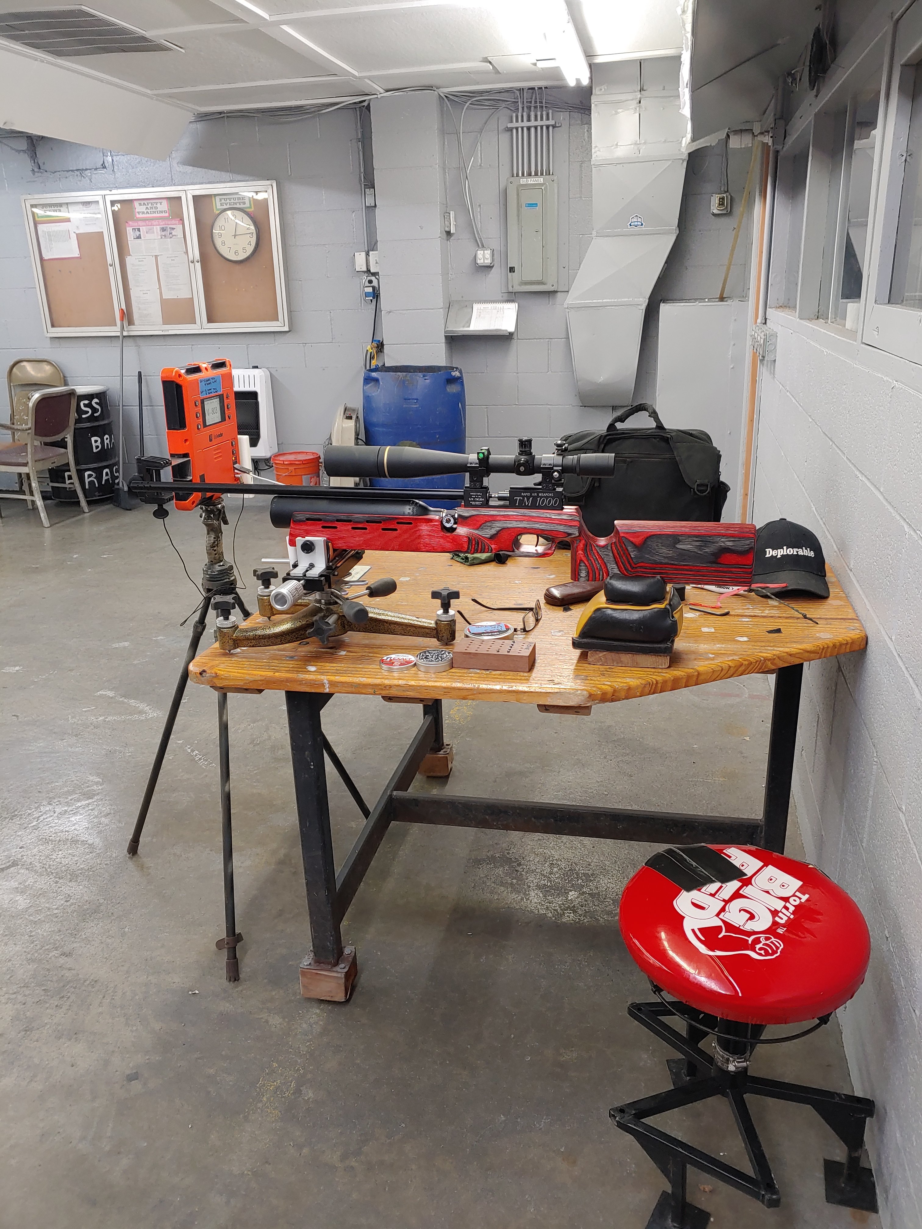

Shooting 13.4 out of my TM1000 RAW and shooting thru a Lab Radar unit. Had it shooting the new redesigned at 795fps. set up as a sub 20ftlb. Accuracy seemed to fall of some so turned up the hammer spring to shoot them at 810 thinking maybe alittle faster my help accuracy. I then shot some 13.4 redesigned I bought in early 2019. They averaged 824fps. over a 10 shot group. Then shot some of the 13.4 that aren't the redesigned I just bought to try out and they shot 834fps. over a 10 shot group.Then shot the new 13.4 again and they shot 810fps. The newest redesigned seem to shoot quite a bit slower so I'm assuming it's because of air loss around the skirt? I've checked all screws and cleaned the barrel trying to figure out why it's not shooting the 13.4 like it has done before.Ive got a Daystate Huntsman .22 that shoots better at 25 yards than my RAW right now, and that's not normal. That's why I tried speeding up and trying different pellets. The left pellet is the new redesigned. The middle pellet is the 2019 redesigned. The right pellet is the non-redesigned. Advice?
More contact are with bore on the new RD's
More of a contact band at dome and the shallow angle skirt as well has more surface area once it folds in to bore diameter.
I still feel the Original Trash can MONSTERS shoot better than RD's in the sub >20 fpe speed.Thats what another member told me and I bought a couple tins. I know all barrels are different, but around what fps. would you push that pellet at ? So slower means more contact with the rifling ECT. that makes sence.Thanks.

In reply #35 I have a closeup photo of an original and a redesign side by side. Can see much more contact with the bore with the redesign.

It was originally set up as 20ftlb to shoot the 13.4 redesigned and shot them great with the pellets from a couple years ago. Now even with the SD from 1 to 4, the 13.4 redesigned just won't shoot as accurate as they did before. No matter what speed I try, the SD will be really good but the pellet just doesn't seem to cooperate. Cleaned the barrel really good and gonna try the 13.4 non redesigned. Maybe shot some 10 shot strings from 770-810 and see how it goes.
