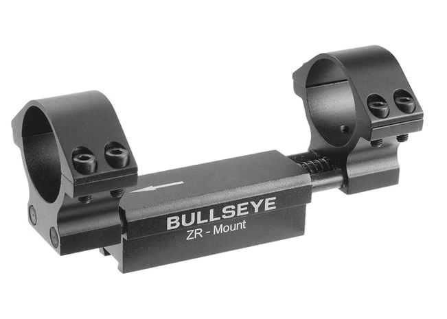

They have 'moving mounts' that allow the scope to 'float' when the rifles recoil..
They're most definitely recommended for springs - especially magnum versions:
1554245151_17374242885ca3e61febecf2.67802585_bullseye-zr-1-pc-mount-1-quot-rings-11mm-dovetail...gif
https://www.airgundepot.com/bullseye-zr-1-pc-mount-1-rings-11mm-dovetail-004.html
