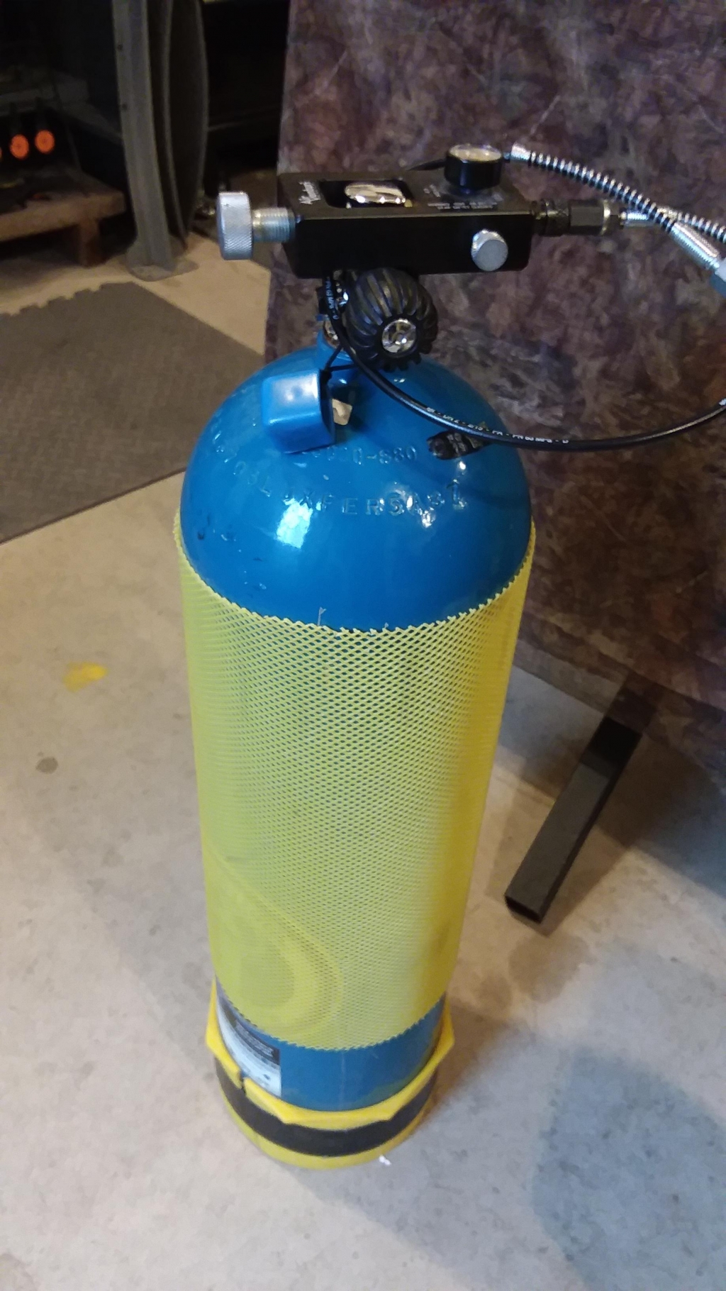

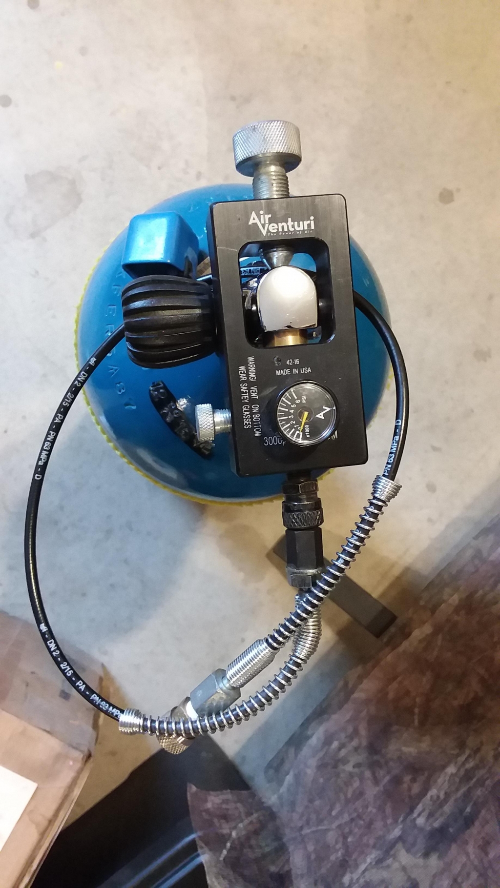

@bubblerboy64 I agree! I spent 200$ on a Benjamin pump that failed after a year and have went through 2 cheap 50$ pumps in 2 years, by then I could of bought a dang scuba tank. My research has led me to find that 3000psi tank will definitely be all I need, I just don't know what exactly I need so that I don't get a tank that I can't get filled. I've heard I can buy them from local dive shops direct and then just slap on a fill adaptor but again I have no clue so we will see what AGN tells me and thanks for the input!

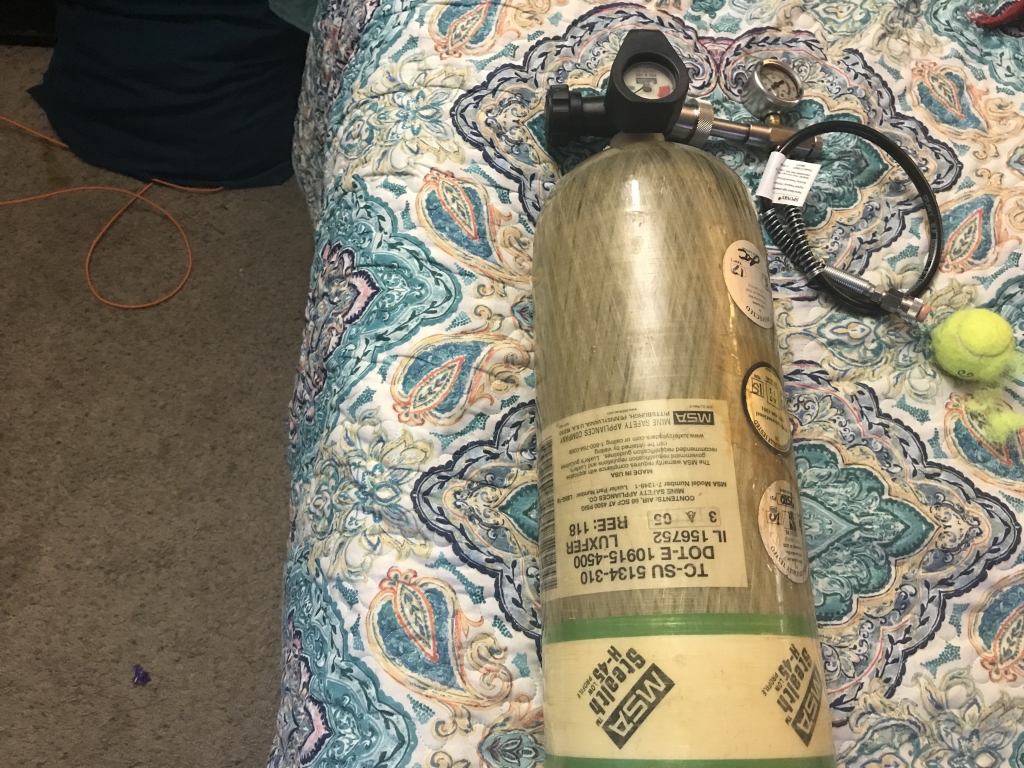

You might also consider getting a used 4,500 psi carbon fiber fireman tank which can be found for $60-120 dollars depending on the "use by date" and supplementing it with a small pump like the Yong Heng ($200.) As leadfoot said, that will give you many full pressure fills instead of just one. It will also be a smaller lighter package and give you independence and save you time running around to fill shops.
Amazon Yong Hong and eBay fireman self contained breathing bottle and eBay for fill adaptor all for under $500.00
