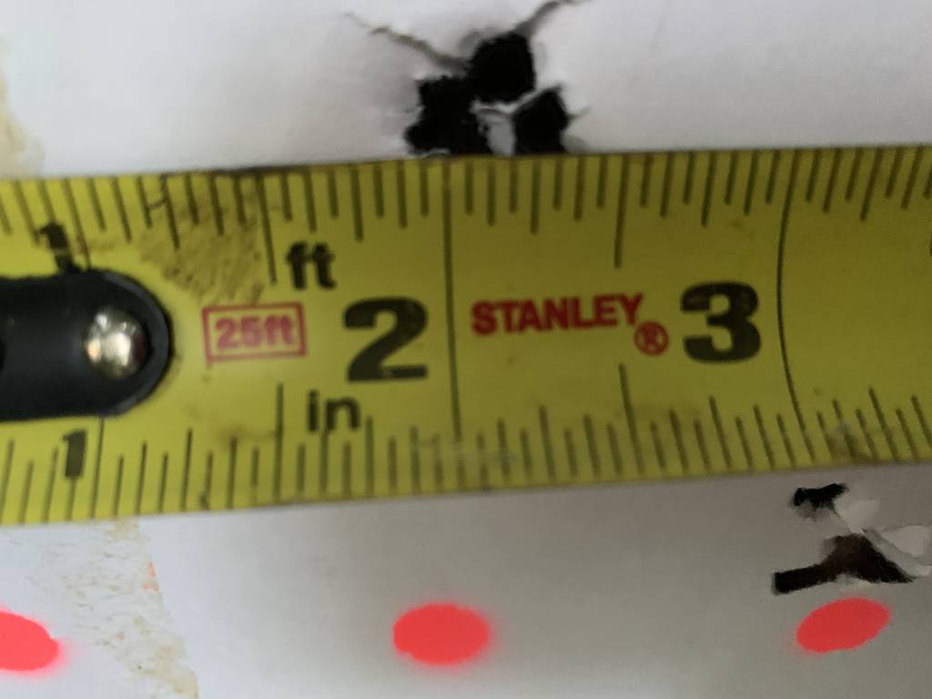

8 shot group last week @ 100 yards using the FX I mpact 700 mm barrel

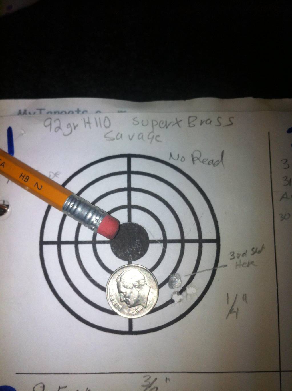

17 Hornet @ 3475 FPS 3&5 shot 100 yard groups.

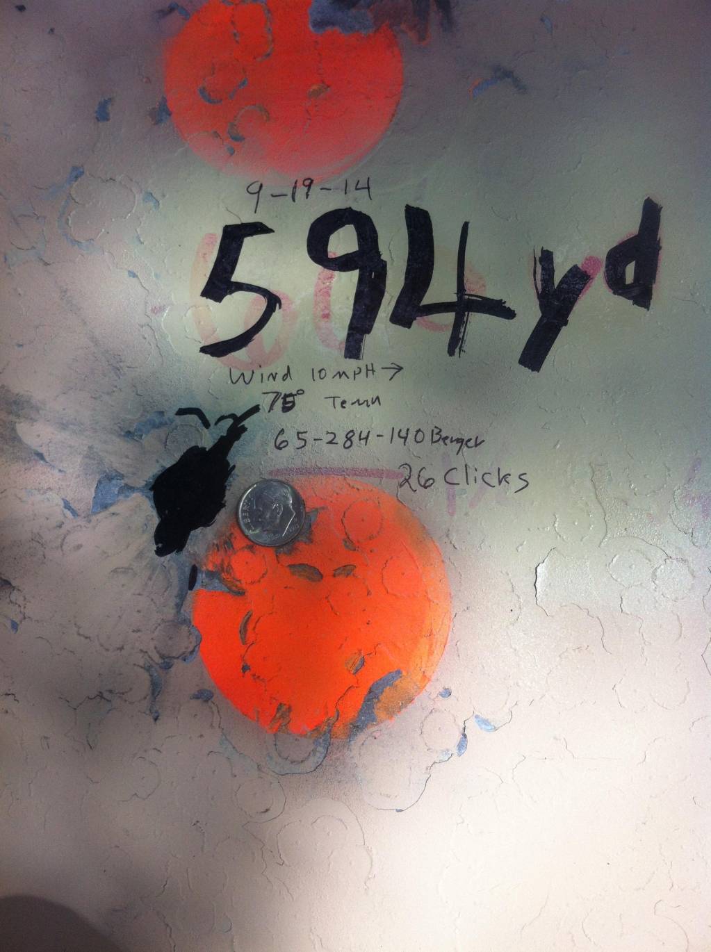

65/284 @ 2980 FPS 3 shot groups from 200 yards to 722 in 100 yard increments in consecutive order as fast as I could reasonably shoot them

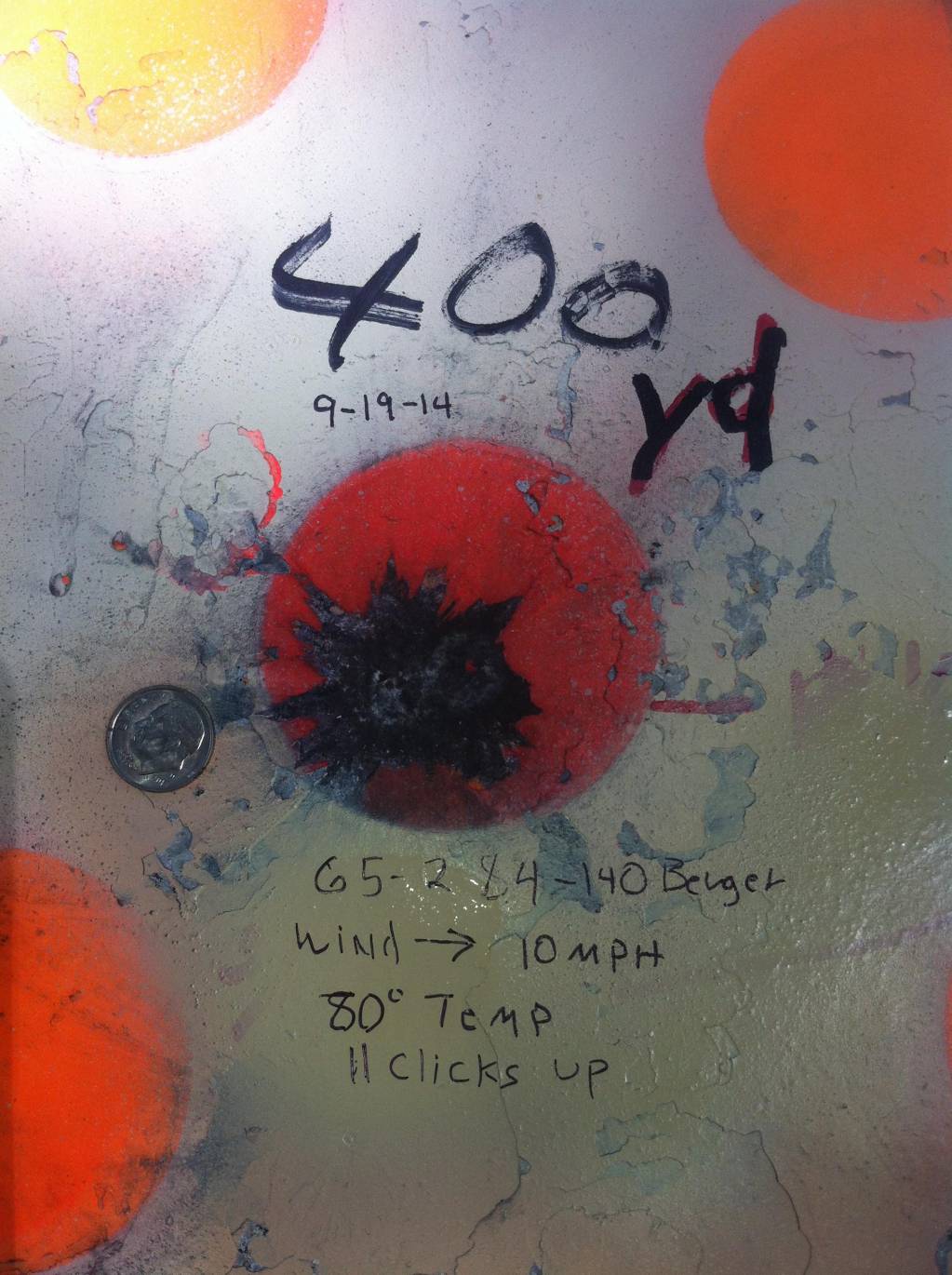

400 yard group

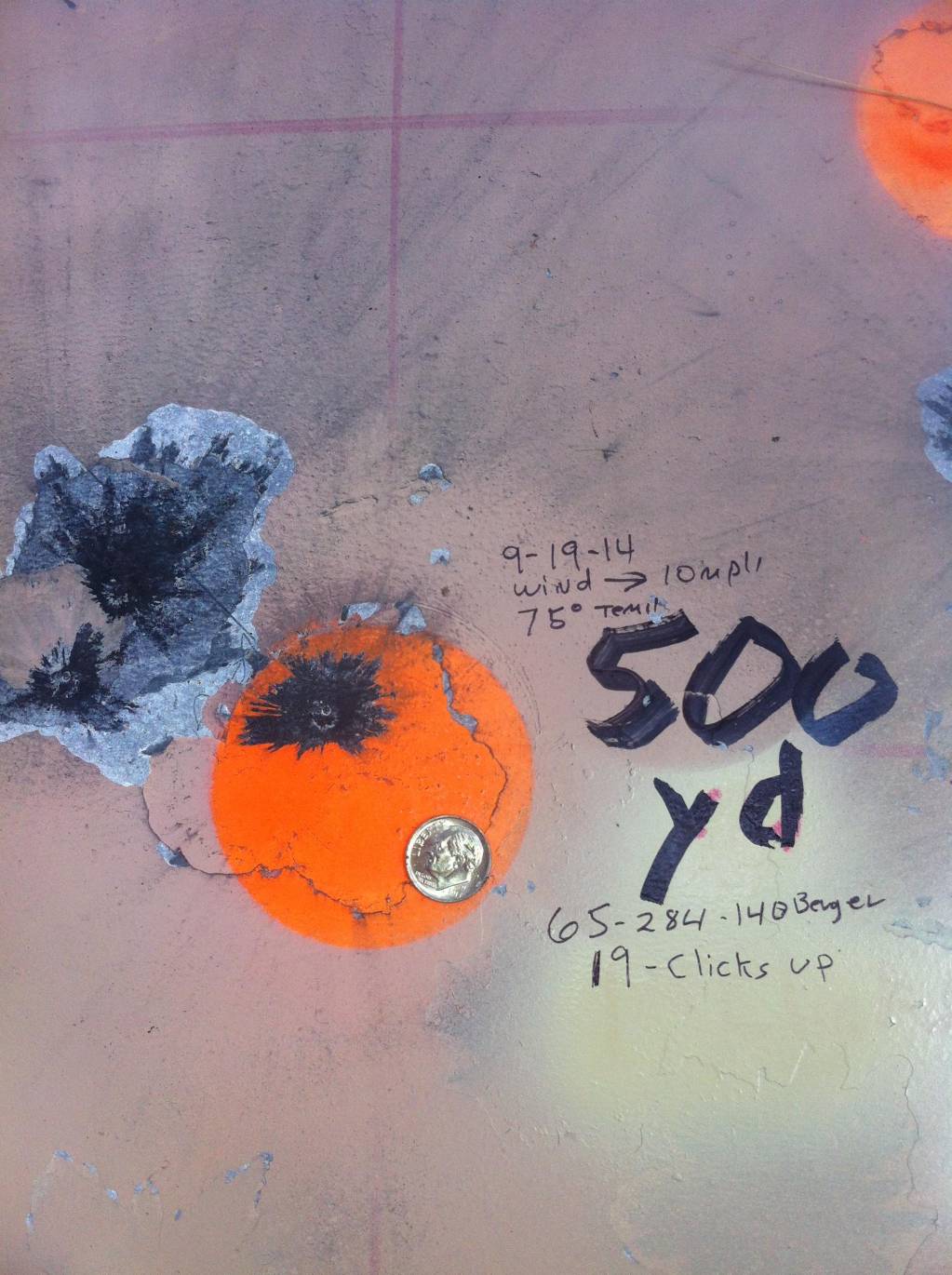

500 yard group
600 yard group
722 yard group

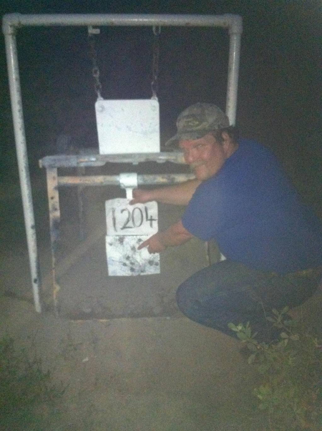

65/284 1204 yards 10 shot group in 10 to 15 mph wind on a 9x12 inch plate. (at this distance a 5mph missed wind call will miss the target 4 feet.
