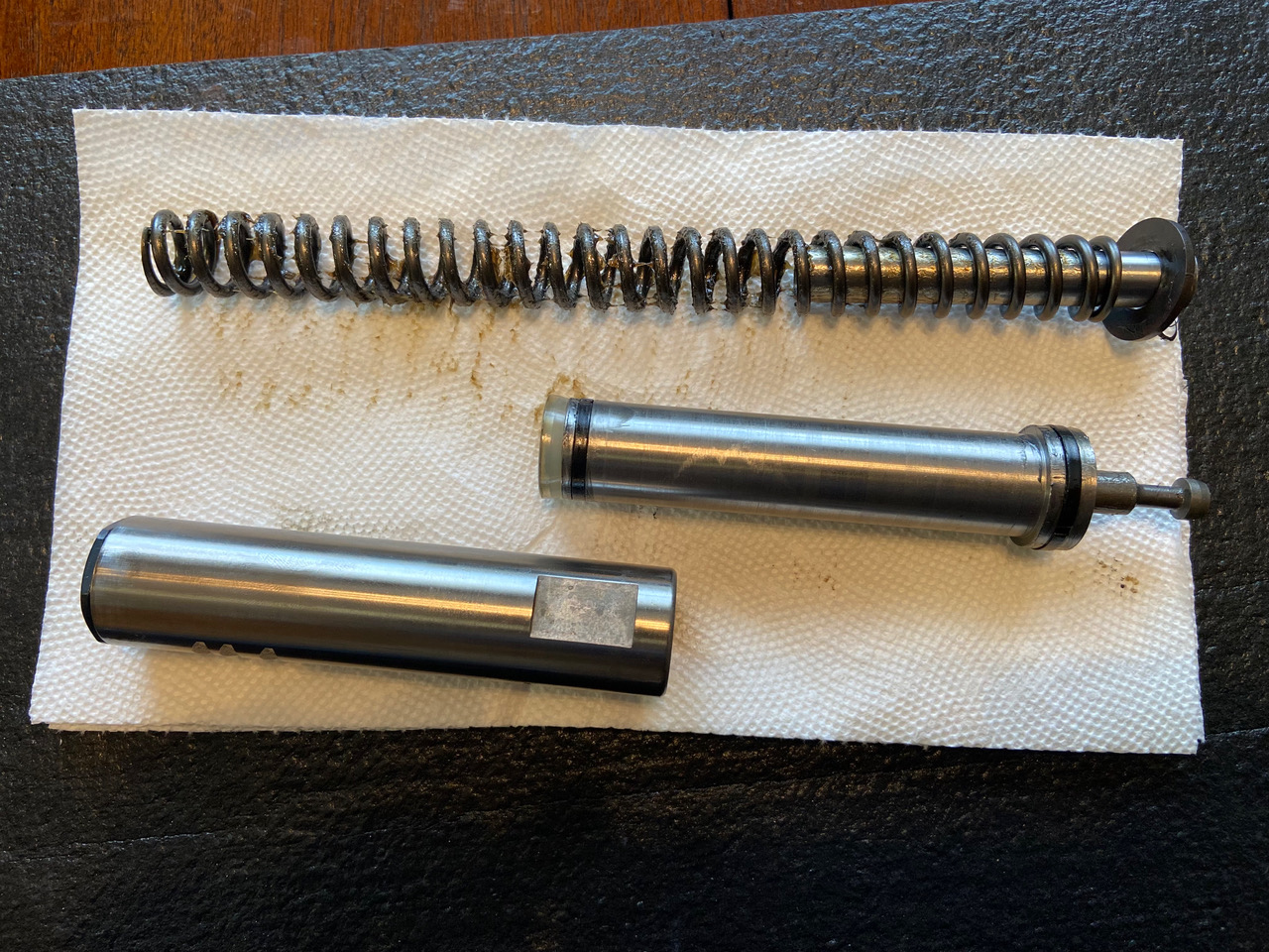

I haven't shot my TX 200 much. I bought new 5-6 years ago, probably less than 100 shots. Shooting again and loving it!
I watched lots of videos about maintains and upgrading.
I took the rifle apart last night. There was a bunch of sticky black grease on parts which I removed. There are two black rings, not o-rings, one on each end. Both have an open seam. Doesn't look broken? I guess the seam is to aid in removing and installing new?

The two black rings, I believe your are looking the piston? Those are piston bearings that are on each end of the TX piston. They are supposed to have a little gap kinda like a lock washer would have I guess you could say. So if thats what you'r talking about....thats normal. Below is a pic of the piston, compression tube and spring out of a newly opened TX before cleaning and install of an entirely new kit. And your TX is shooting really close to 14 FPE based on the pellet weight and velocity you stated. That is actually a good place to be with that TX if you are gonna hunt with it. That is close to my higher powered TX that I have killed many squirrels and other critters with. You can easily get too much power and lose accuracy with the TX. Shooting close to 14 FPE should be real good!

Cleaned up and lubed with a good moly paste will have it shooting great for a long time without a kit. They actually come with pretty decent springs, unlike some other makes.
A tune kit will get rid of any spring buzz you hear after the shot and usually makes the shot cycle a little quicker/smoother.
I wouldn't expect to gain much power over where you are now, sounds like it's about where it needs to be.
Personally, I hate the Vortek kits and have been disappointed with the ones I've used. But apparently everyone else loves them. I'd normally recommend a kit from Air Rifle Headquarters instead, but for whatever reason he no longer offers one for the TX200.
Moly paste is what you want, and it will work for lubing the entire inside of the rifle, particularly the piston seal. When applied right, it acts more like a dry lube and doesn't burn off and helps with tighter shot-to-shot velocity spreads.
Clear Tar from Air Rifle Headquarters is nice to have for the outside of the compression tube sliding surface, but any decent grease will work here. Just pick something not black or ultra sticky since it may creep up onto the exposed portion of the compression tube. You don't wanna be wearing it ya know ;)

Bowwild, I personally would not use that tune in a tube grease stuff. It's like a band aid on an issue....doesn't fix anything. Thumper is right about the moly paste for sure. I use the moly paste from ARH on nearly everything in the springer.....no thick grease/tar for me. It has ill effects on other things in my opinion. Now, I have actually been pleased with the Vortek kits in my TX. I have used Air Rifle HQ or otherwise known as Maccarri kits in the past in other springers. I'm sure I misspelled his name...Jim Maccarri? But, I have used his spring kits with great success...but not in the TX. Can't get them any longer.

You'll be fine if you want to tune it. They are very easy guns to work on, and not really anything you can mess up by just swapping the spring and piston seal out. Certainly nothing we can't help you through over the web or phone. Even any issues with the Vortek kit, which likely won't be a big deal.
The biggest part is lubing it right, with the right stuff. Basically just not overlubing it. But even that can kinda fix itself in time.

While you have your TX apart polish the ends of the springs and deburr everything inside that has sharp edges.

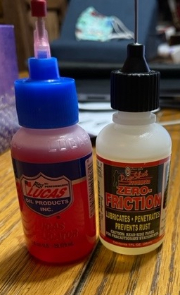

I received "Tune in a Tube" today from Pyramid air. I'm planning to use this on the spring of my TX200. This afternoon I bought two brands of light oil.
ProShop Products Zero Friction and Lucas Oil (red). I would be planning to apply tiny amounts of this to the junction points of metal parts in the cocking mechanism.
Are these plans sound? Is it ok (advised even) for these oils to find their way on an O-ring?

None of those products would damage anything on your TX. There aren't any orings inside the gun, and if there were those oils wouldn't hurt em.
The oils would be fine on all the pivot points too.
Myself, I don't care for the Tune in a Tube, but it certainly won't harm the gun, especially if used sparingly.
I'd still want a moly paste for lubing the piston seal and piston. And maybe use the Tune goo LIGHTLY on the spring. That sounds like a pretty decent recipe to me.
Sounds good. I will get my paws on some moly paste then. One thing for certain, It seems as if very light applications are the key.
I was pleasantly surprised when I opened up my rifle that it wasn't heavily greased or lubed. The irony will be once I go through all this and I don't notice any change in FPS or feel. That will be fine too though because I have learned a lot by going through this.

Just finished putting my TX200 in .22cal. Back together. As you can read above, I was a bit intimidated doing this for the first time, especially regarding oils and "grease". I didn't change any parts. The spring looked fine with no burrs. The seals looked good too. I just thoroughly cleaned all the internals of any greases and oils and then reapplied as per advice above. I didn't get any moly. I used the very sticky, red "Tune in a Tube" to grease the spring (very lightly). I rubbed with my hands a film of same on the cylinder that goes in compression tube. Wiped think oil on other parts.
Put it back together. Yep, I had to search for that durned "clip" as it slid under a pad I was working on.
Feels good when cocking, maybe a bit smoother? I put a handful of shots through the gun. I didn't expect any gain in FPS but I was hoping not to have reduced performance with just this cleaning and relubrication. Shots where 625-640 (640, 637, 622, 629) in that order. I could smell a bit of burnt Lub on the first couple of shots and then none.
