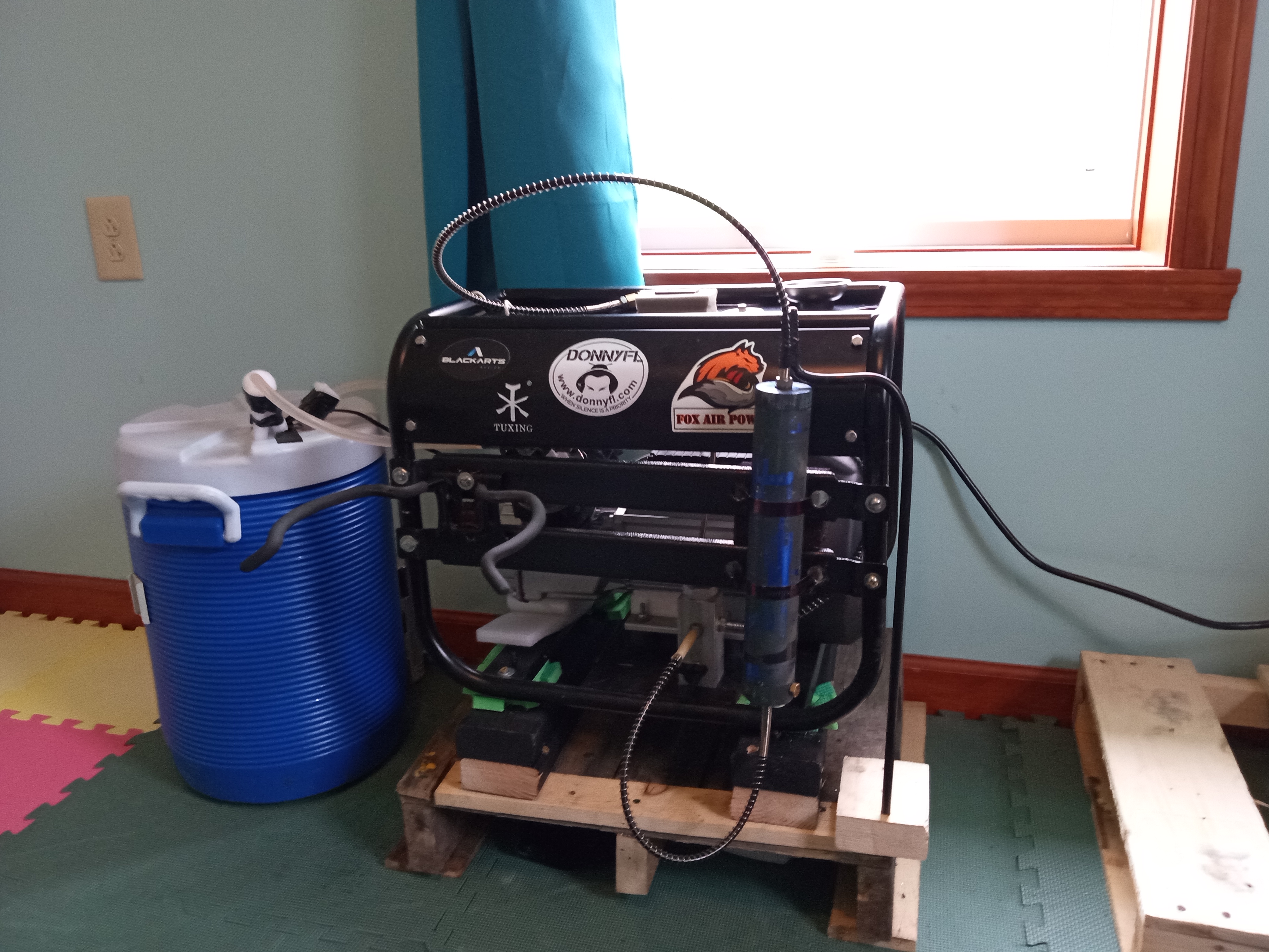

Ok, so how does this compressor manage to stay cool using just that little radiator when mine goes very quickly to 70 or 75 celcius when using a much larger radiator and a lot more water? Even with a constant supply of tap water mine can't stay under 70C. I have to use ice in my water.
They're basically both compressing the same amount of air per minute, so they should be generating the same amount of heat. I don't get it.
Here's my setup:
Any ideas?

Cylinders are separate and each cooled. Also oil quality, heatsink design, cooling channel design etc make a difference.

I live in Texas and I have a Yong Heng that I cool with a 5 gal bucket of 50/50 distilled water and radiator coolant aluminum compatible. I never run it more than 15 min. If Temps get past 50 C (122F) I wait 5 min for it to cool off. The Tuxing double cylinder I'm running on 2.5 gal, but with a double fan PC cooling radiator. For the Tuxing double in a 20 min run the temp goes to 49C (120F). However, I believe what makes a difference is also the oil I am using. The Royal Purple brakes down and turns black only after 30 min of running. It also leaves black carbon deposits on the piston rings. At times when I first changed the oil with RP, the safety pressure vale/copper membrane popped for over pressure. This indicated to me that the RP oil combusts around 4000 psi. The Nuvair oil after 4 hours of runtime it is still clear, and compressor runs smother with less noise and the safety valves never pop.

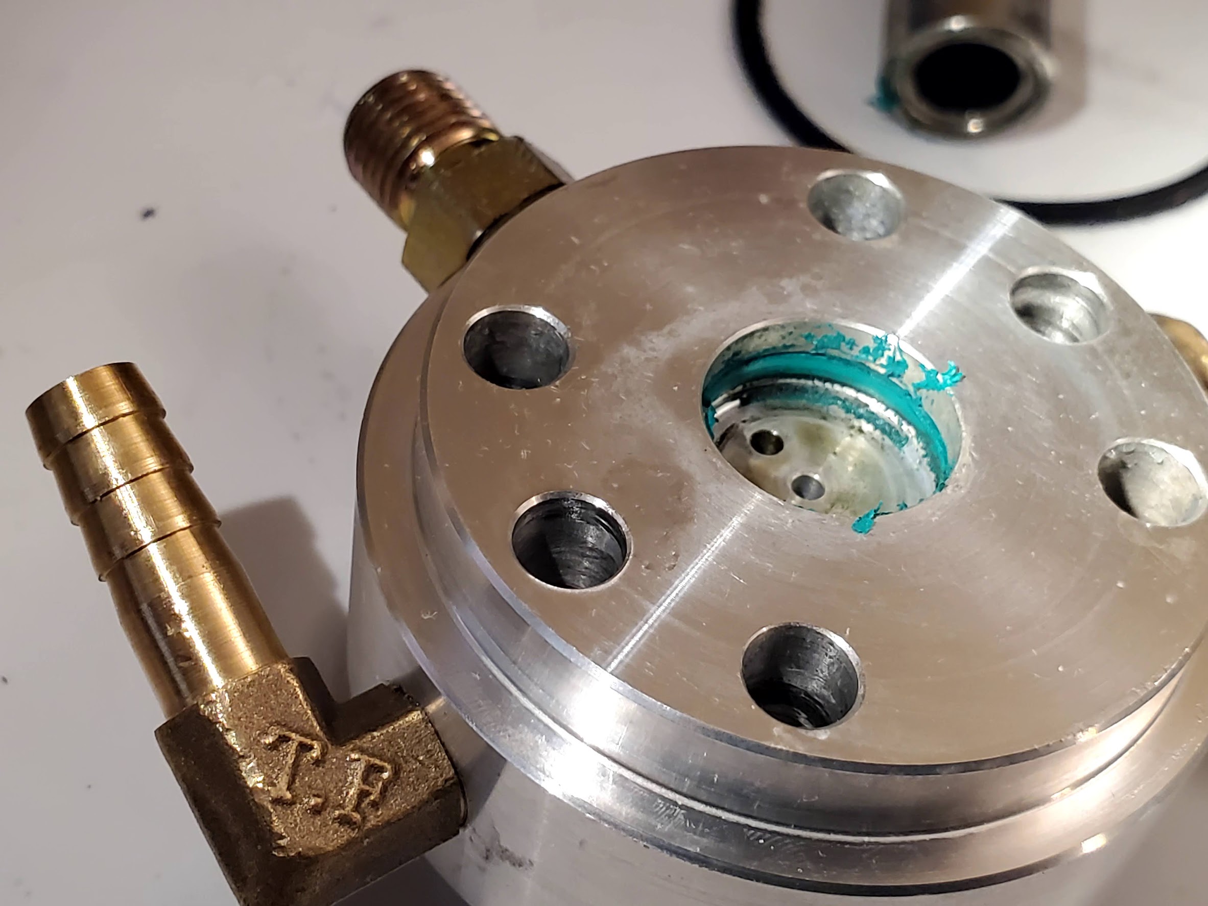

With that said, a friend of mine gave me a Yong Heng compressor that gave out with only 1 hour of working time. It could not build pressure past 2000 psi. I run it and the temperature shoots up to 75 C (168F) in 3 minutes. The temperature gets so high that the high pressure tubing turns dark blue. I cleaned the lines, and the high pressure check valve, and replaced the piston and rings. It still overheats. Still no idea why? I now bought the entire high and low pressure bleed valve blocks to replace to see if it fixes the problem. I do not need this compressor, I just trying to solve the problem.

Well yes. Tore it apart and found that the green o-ring that seals the top of the HP cylinder is not in great shape at all. Pieces of it came out when I pulled out the cylinder. Does anyone have specs for this o-ring, perhaps suggestions for something more durable?
Did anybody ever figure out the proper size, and type of oring we should use ? I am tired of replacing the ones tuxing sells.
