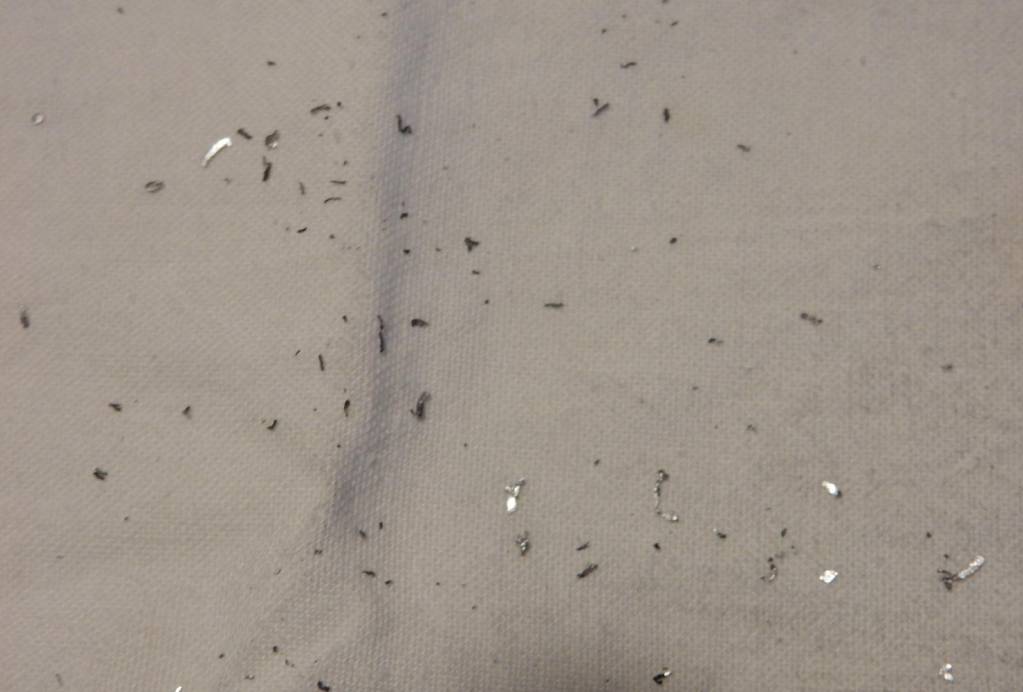

I did do some further inspection this morning. I dumped the remaining slugs on a clean white rag and rolled them around and found a lot of slag left. had to repeat this several times until there was very little showing up. I then took a fresh unopened box of 33.5 gn slugs and spread them out on the rag and rolled around. Only a very small amount of slag showed up.

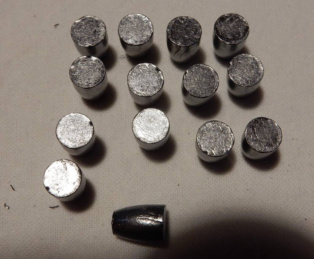

I also did some closer inspection of the slugs and I found that the 33.5 gn slugs were much cleaner looking on the base. A few had slight dimples along the edge. The 36.2 gn slugs showed dimples on 50%. I did also find a couple that had wrinkles on the side.

Attached are a couple photos I took this morning of the 36.2 gn slugs and slag.

I sent an email to NSA explaining the lead flack on my slugs. I got an answer back from Nick this morning. Here's his reply back
Thank you. We like all feedback good and bad so we can dial in our process, make changes and strive for perfection. I don't think it missed a step but I think we were washing too many at a time not allowing the flakes to make their way to the bottom and would get caught in the pile of slugs in the basket. We have made that change recently but obviously not in time for your ammo.
If you feel the ammo is not up to par we will send out a replacement, just let us know. I really do appreciate your feedback and we do take all feedback seriously and try to take appropriate actions to correct issues.
