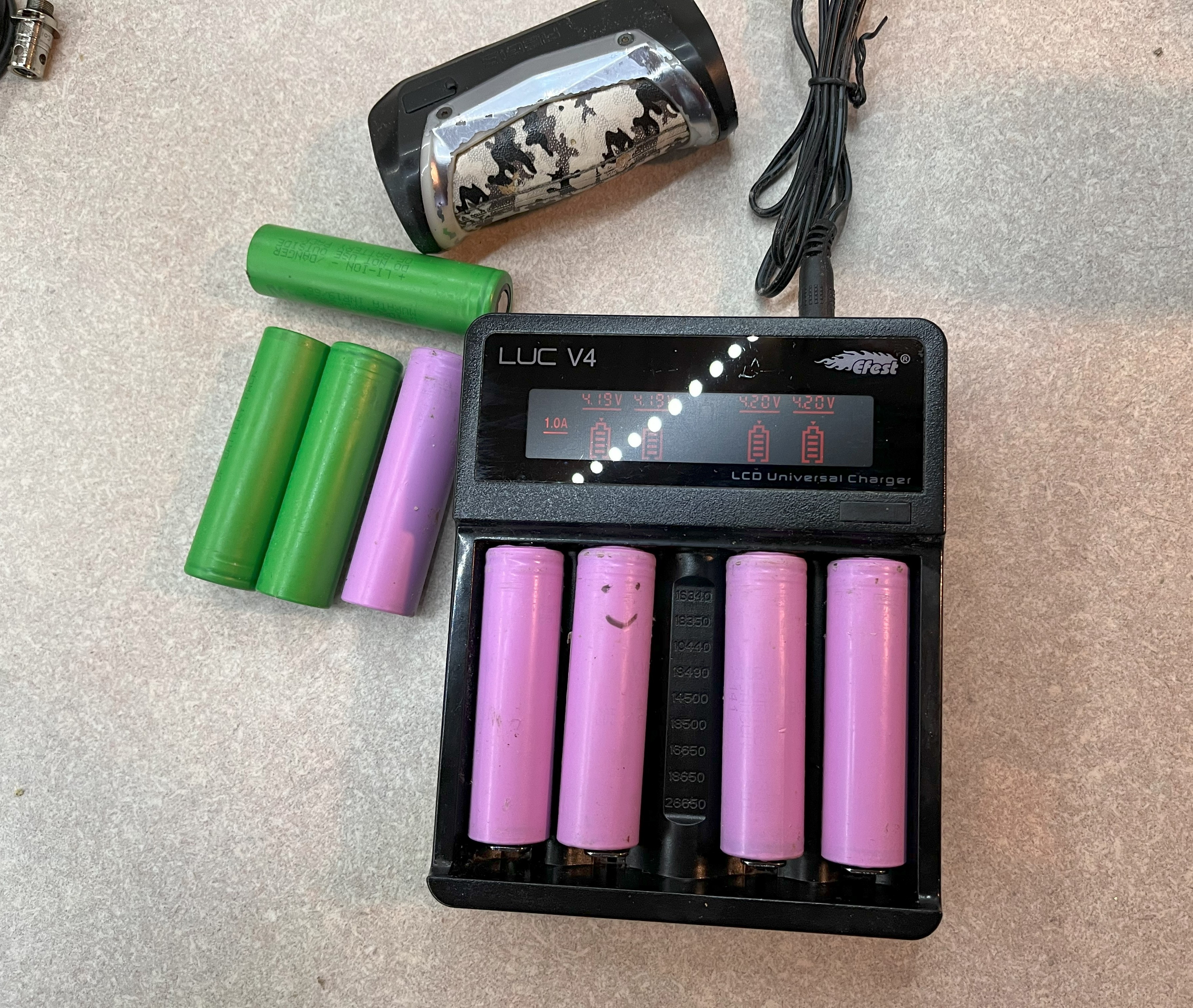

This is the battery I use for the zulus and pard.
Flat at both ends.

Guess I have a sign that I have to get on one these.. We started vaping about 10 years ago and moved to devices that take the flat top 18650. Now we vape with devices that have internal batteries so we don't have to swap batteries all the time. But, we have a great charger and about 10 good 18650's sitting there on the counter asking to be used by something. huh.. I don't believe in coincidence. 🥳

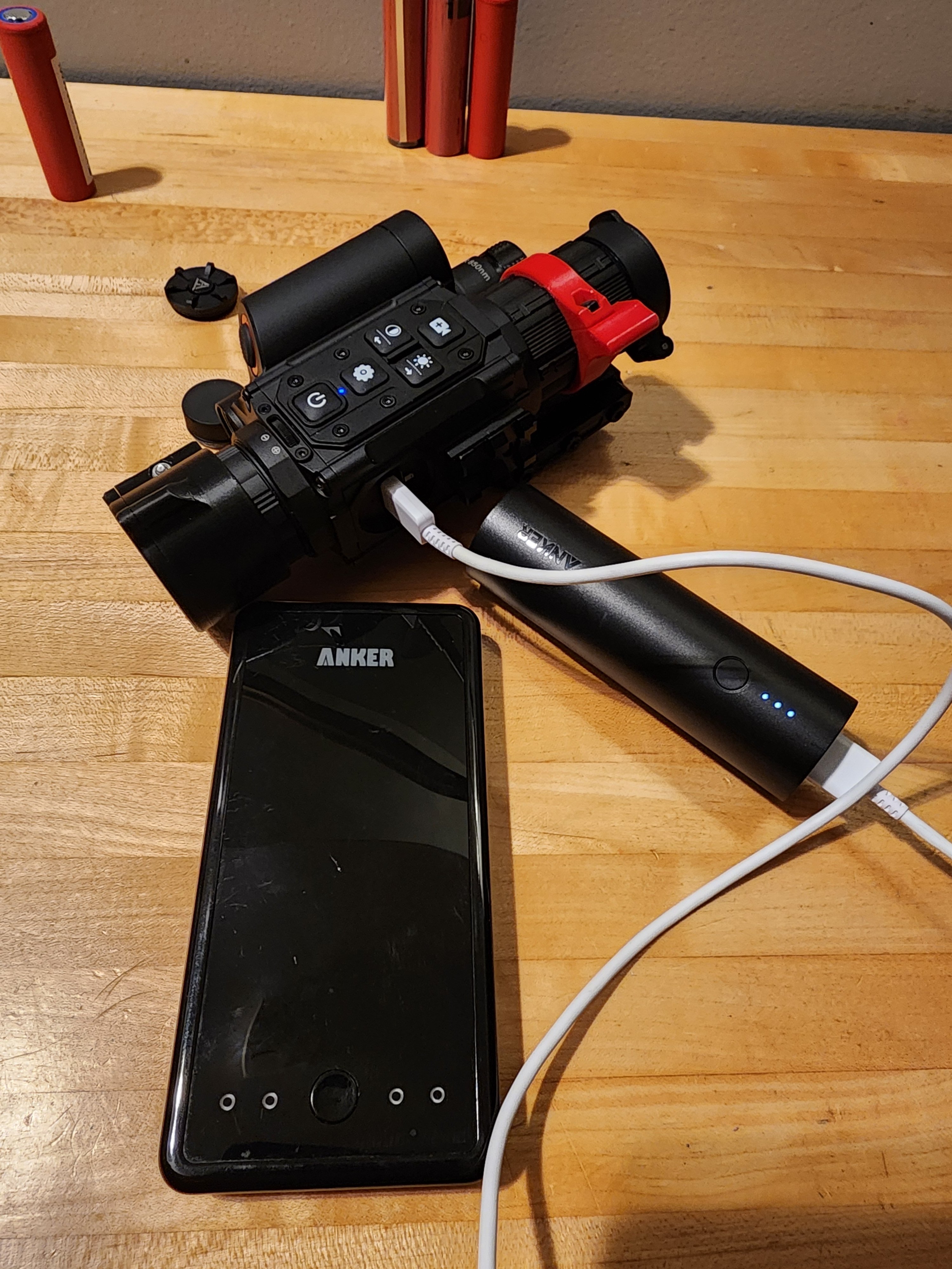

Glad they got back to you and let you know what's going on with them running out but a note should have been sent to you and everyone that purchased it. In the mean time you can remove the side cover and use a power pack and plug directly into the unit to get started. As mentioned button top protected batteries will not fit. My favorite battery is the NCR18650GA green is made by Panasonic China, and red is Sanyo Japan both are great and essentially the same battery. Before my airgun hobby I was into high powered flashlights yes that's a thing and still enjoy them so I have batteries in all shapes and sizes. If the OP or anyone has any zulus questions just send me a message I have had one since September and have been trying to relay information back to the company when possible.

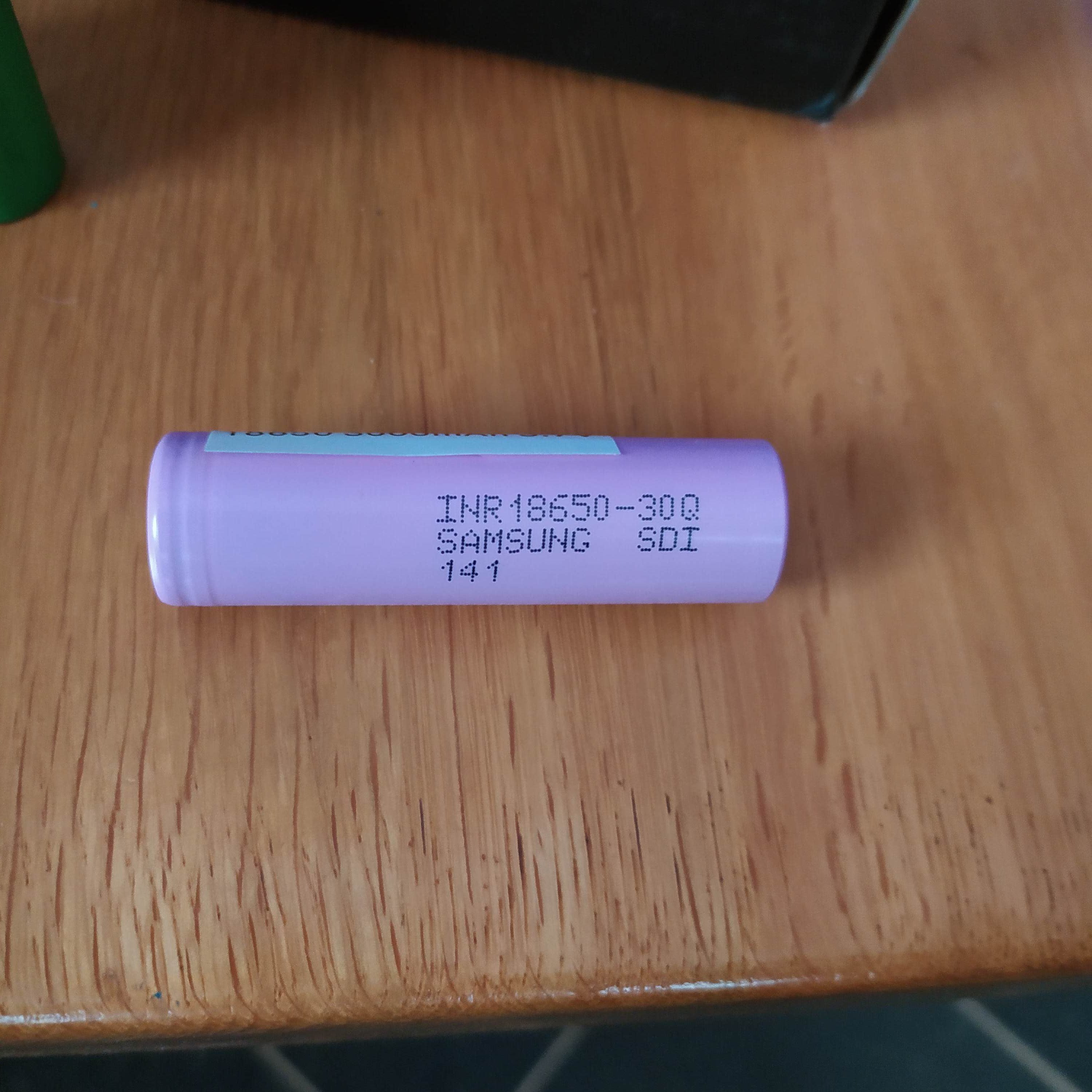

My Zulus came yesterday and I am going through the same thing. Ordered the batteries last night and they won't be here till Monday or Tuesday. They say to get good name brand batteries but do not suggest which that might be. I guessed that the Samsung 30Q would be good and ordered 2 of them and a charger. I had not seen this thread yet or it would have helped me but I am pleased to see I ordered the right ones. Also ordered a 128 Sony TF card. I was a little disappointed that they did not come with it but some of that is I just want to get started with it. I have never had an electronic scope before so I am a bit excited. My best scope was a Hawke 3x12. I noticed one post suggested checking for them at a vape shop so will try that today.

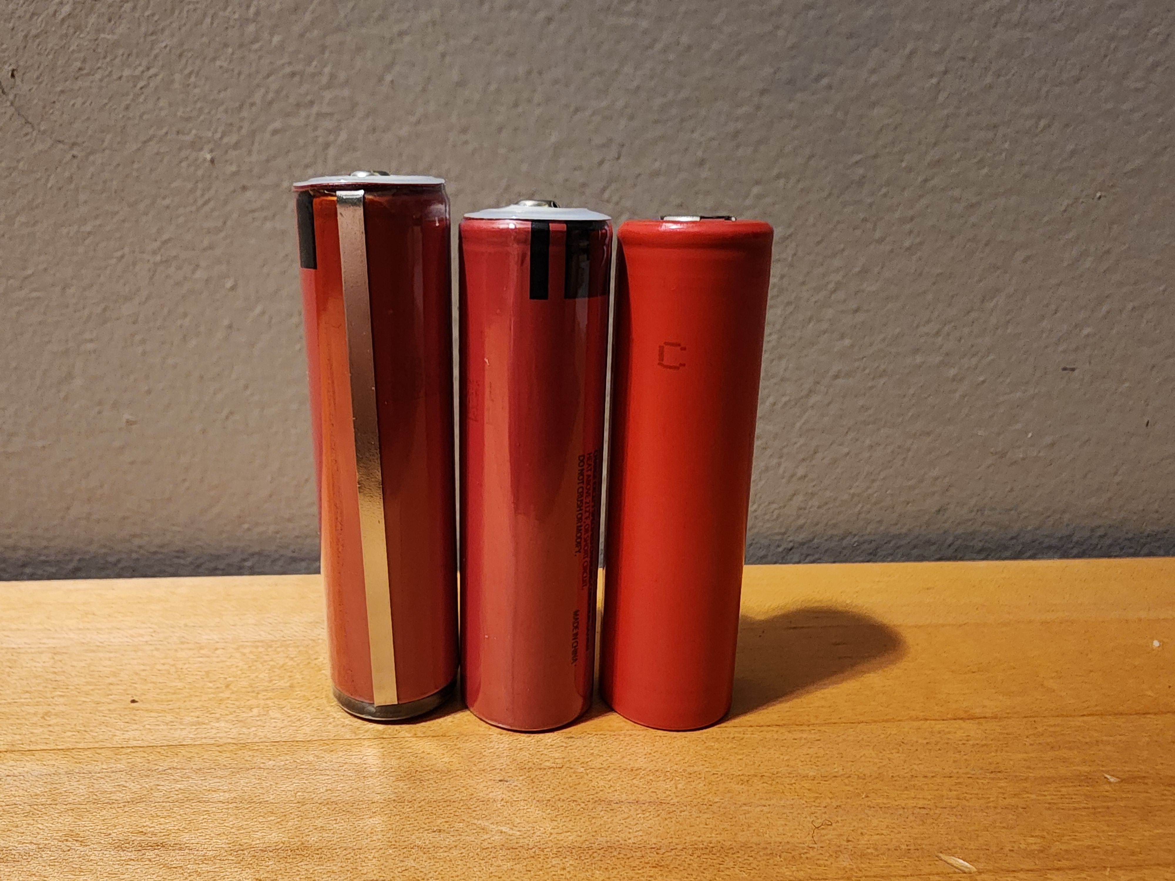

Most vap shops will have protected batteries and some can even be flat top protected. Attached is 3 of the same exact battery one button top protected, one button top not protected, and one not protected flat top. Batteries from a vape shop will most likely be protected but doesn't hurt to look also note that the Samsung 30q is a 15amp battery and will work but not 100% needed as it's not a high drain device like a vape. The ones I mentioned are 10amp. If you have a power pack like I mentioned you can get power to the scope and start learning it while you figure out your battery situation. The battery tonthe right that you want is right around 65mm.
