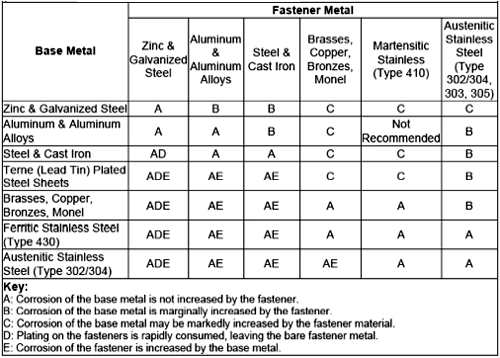

Just so all knows, in our trade we used to make galvanized drain pans that went under any piece of equipment that went up in the attic that carried an evaporator coil, as a back up should the factory interior pan clogged up. The drain pan was piped to a janitors sink, where if water was seen coming out of this pipe that meant there was a problem. The plumber who piped off of the pan used copper, so in the shop we would solder a stub of 3/4” copper out for him to attach to.
iif you look at the charts, copper and galvanized do not mix. Just because the two touched didn’t mean electrolysis would start. It needed a third ingredient, and that was moisture. If a gun gets wet, like most all guns do cause us boys like to go out with weapons in the elements, we just need to do our due diligence and give it a good oil wipe down, like we did with our powder burners.

Yes, and that’s why after I posted those charts I made it clear that even in my trade, dissimilar metals are used all the time provided no moisture, condensate, etc will ever be in the area, so as not to speed up the oxidation process.

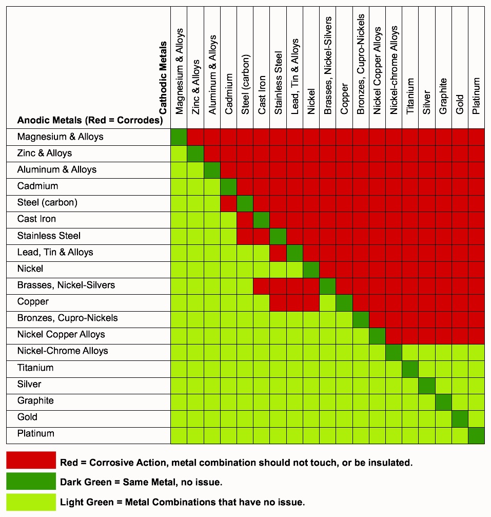

Yeah they are making lots of things in titanium. But you yourself said that the salty air corrodes blued steel quickly, so it’s the perfect environment for galvanic corrosion.
To help you understand that table a bit better, that list of metals is in that order for a good reason. It lists the most active metals at the top and the more noble they are, the lower they are on the list. Se how zinc is right at the top, that’s why they make sacrificial anodes for boats out of it. That way, the lump of doing nothing zinc literally gets eaten away instead of the expensive aluminium on your boat or outboard. That’s why galvanised (zinc dipped) boat trailers turn to white powder before the steel underneath starts to rust. See how high aluminium is and how low titanium is? That’s BAD.
You can reduce the chances of corrosion by applying an anti corrosion grease (lanolin is pretty good. Bit smelly but quite inert to o rings) to the screws shanks & threads, but go easy on it. This will then prevent the salty moisture (the electrolyte) getting between the metals and starting the corrosion process. But it is a bit of a band aid solution. Better to prevent the unintentional battery to start with.
That black coating on the outside of the aluminium bits is anodising. A controlled and purposefully coloured corrosion process that actually prevents further corrosion from the parent metal. If you have ever owned a mag lite, same same. Mag lites also have other more noble metal bits, and they hold up to corrosion pretty well. But if you get a battery leak, the 1st thing to crap itself is the threaded aluminium areas where the anodising has worn off. I have seen the thread completely seize very quickly when volts, electrolyte and dissimilar metals do their thing.
Take a piece of aluminium (anode) a piece of titanium (cathode) and stick them into a lemon (electrolyte), but don’t let them touch. Then measure the voltage being generated with a multimeter between the two dissimilar metals. Congratulations you hav just made a battery. But like all good things it will slowly corrode the aluminium into a white powder, and then your battery goes flat. Now think of all those expensive bits of aluminium on your FX airgun slowly turning into white powder.
