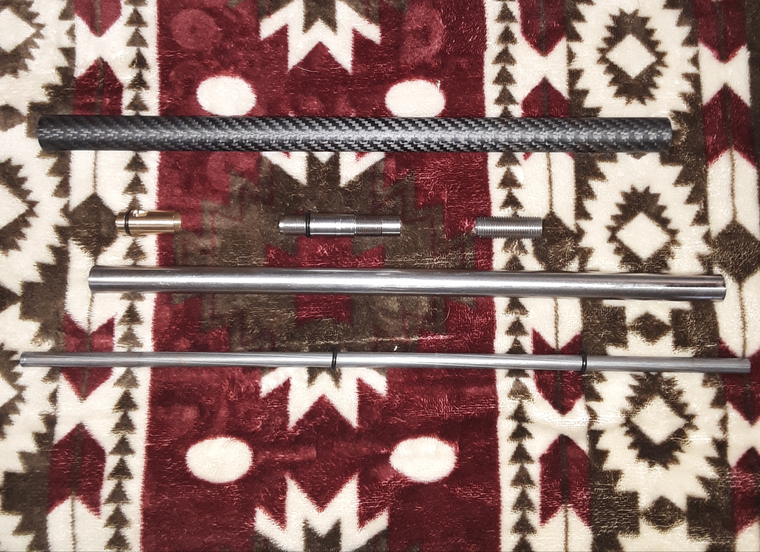

I machined this up after work a couple of years ago for my dreamline compact (made one in 22 and in 25) the straw barrel slides into a stainless steel tube..the other parts lock the barrel in it.. carbon fiber tube slides over it all.. the moderator is used (not in pic) to tension it all in place.... It was a huge improvement.. I do like my dreamline.. and the only FX I currently own that I will be keeping. (just sold the last one) love their rifles... Cant stand the FX barrel system.. that part needs a better more improved system

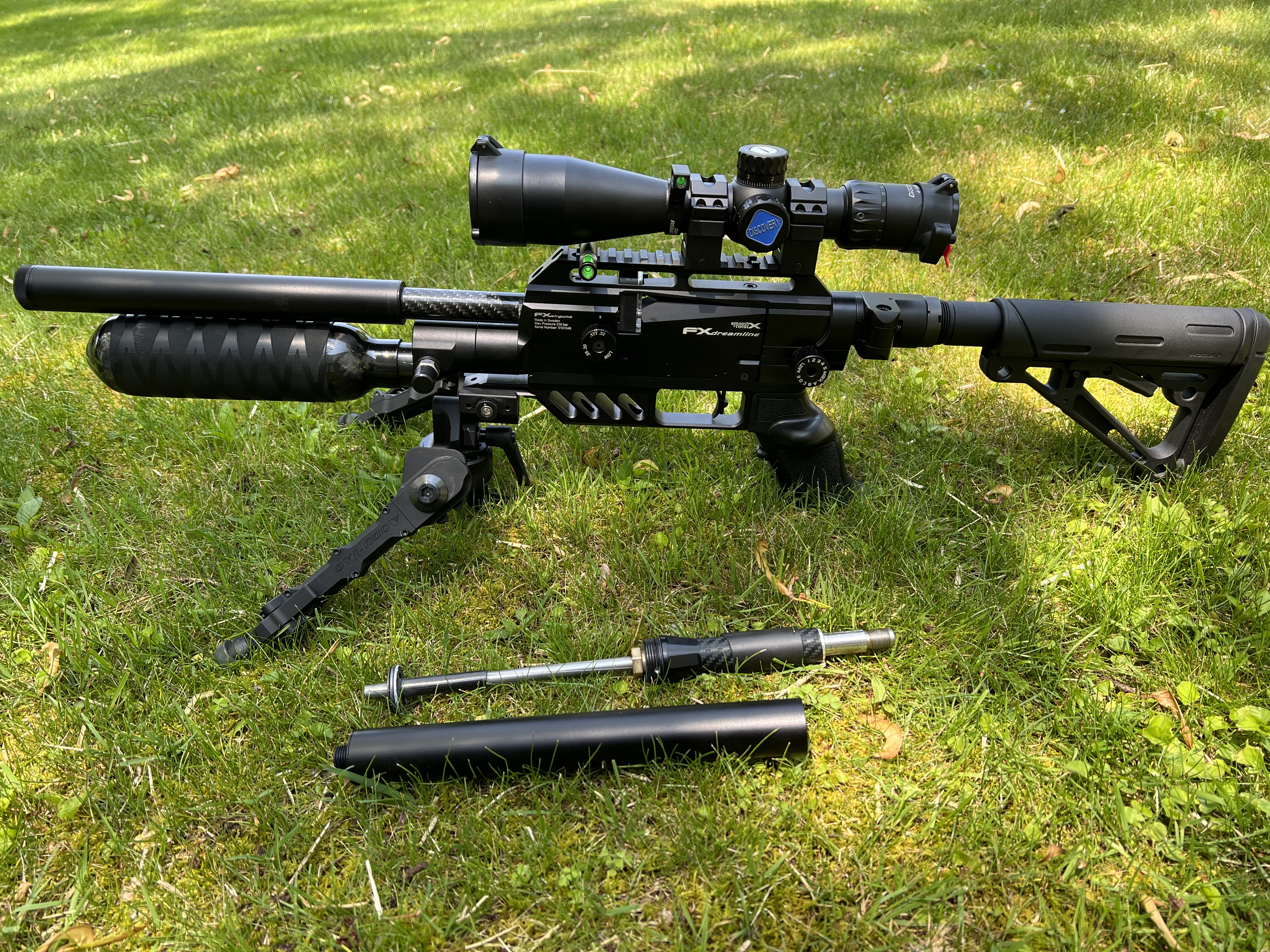

I have a .177 DreamTac (full sized tube version, 500mm barrel) and if compact barrel system is like mine, there are 2 or 3 plastic spacers that slip over the barrel liner. The shroud slides on over them and they are supposed to keep everything centered. But, I have found that the front can slide back far enough to be useless in that roll when you install the shroud. I put a carbon fiber sleeve on mine and the front spacer sits in front of it, right at the end of the barrel, about 1/4" behind the muzzle. It now stays put and has cured the somewhat shifty POI and flyers I used to have.
Now, I am on the fence about how much my CF sleeve stiffens the barrels and all that stuff it is supposed to do. But, I can say that keeping that front space in position is key. If you did not have or want a liner sleeve, you could do something similar with a few wraps of gaffer's tape in front and behind the spacer.
