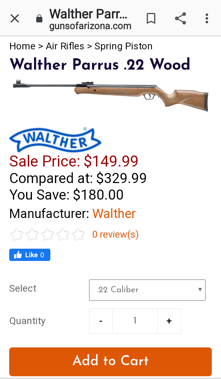

Maybe you find used RWS 54s used for under $240 thats what they sold for last month on sale direct from UmarexUSA with discount code.
Otherwise I would buy THIS... Specifically in 22 caliber.
https://www.airgunsofarizona.com/spring-piston/walther-parrus-.22-wood/
