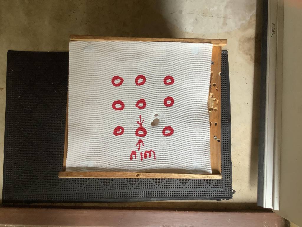

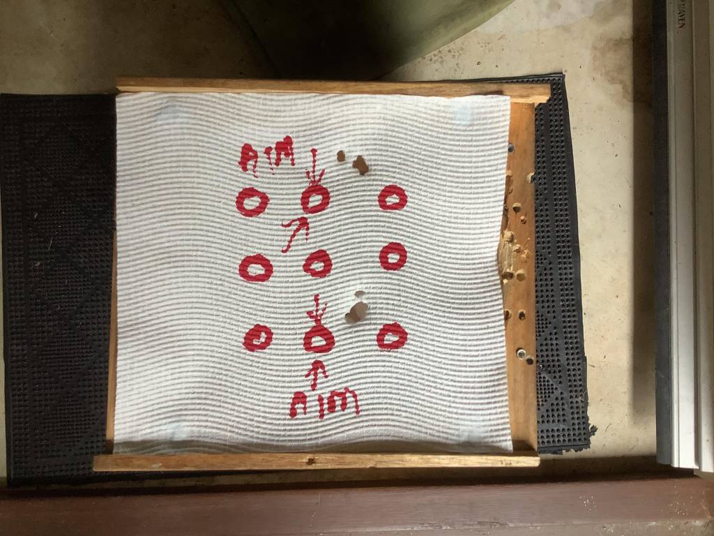

So today was the first chance to test my Titan at 25 metres after shimming the heck out of the scope. The groups on these two photos appear ok. I haven’t cleaned the barrel, but I have checked the stock screws, pivot bolt and everything else that can affect your accuracy. No wind also and same conditions, overcast. Held the same as always so to me ( the uneducated) it appears the scope is the issue. What do you guys think?
This is the first group.
This is the second group. Interestingly the flyer in both groups was on my last shot and my grouping improved on the second bull.
