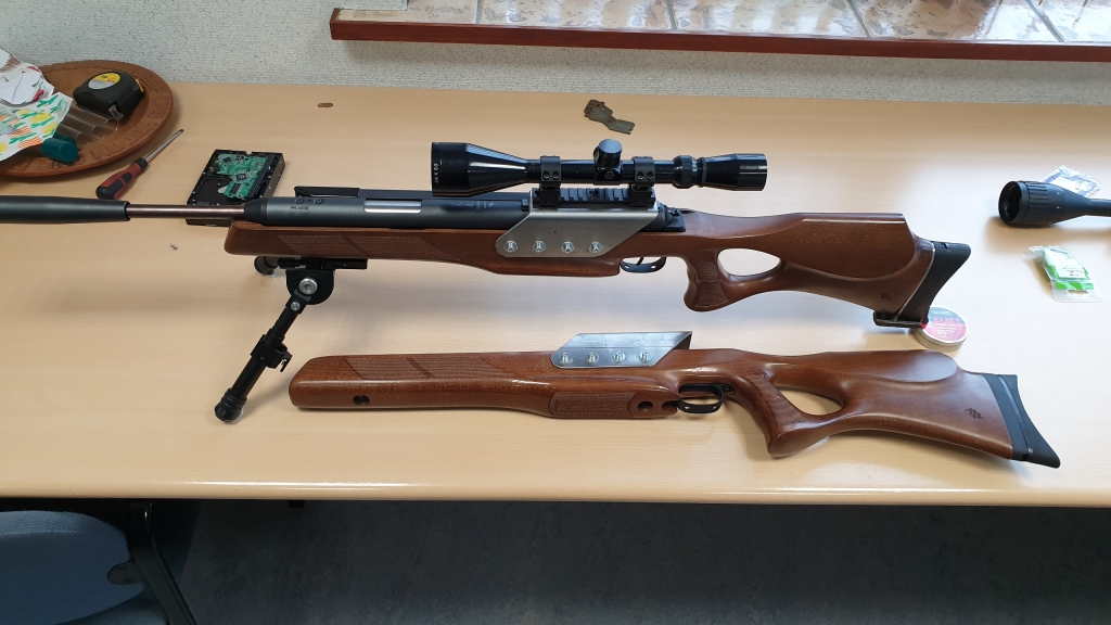

It does not have to be a scope killer:
This idea came from a member of my airgun forum, "De Witte".
I do not like the diana zero recoil mount.
Regards, Robert.
