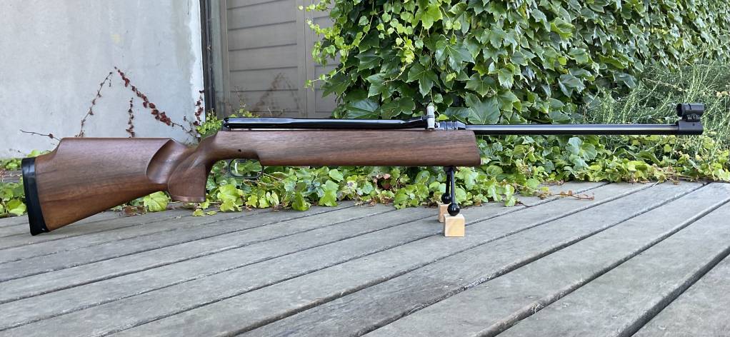

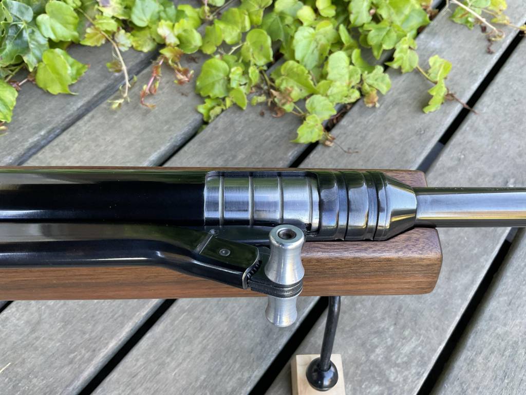

The Remarkable Anschutz 220
Could you image the stir this rifle would have created in 1959. Your at you local shooting club happily shooting away with your traditional break barrel and someone walks in with this exotic.
It’s list of impressive “firsts”
1 Fixed barrel (barrel loading)
2 Sliding compression tube allowing direct access to the barrel for loading.
3 Recoil suppression via rear facing second piston.
4 A ramp that aids in guiding the pellet into the breach.

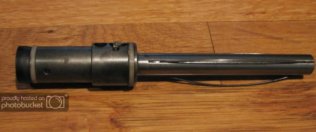

5 “Active spring guide”. The spring guide has 3 high tensile wire springs that run the length of the guide. As the spring is compressed and it’s inside diameter expands the spring guide keeps contact and follows it out.
You can see the springs in this photo.
could possibly be some other firsts. It has a synthetic piston seal which I would have thought could be a first?
The stock is the same shape as they famous model 54 rimfire target gun and they suggest in the 54 manual you might like to have the 220 for practice.
The 6700 & 6702 diopter sights were standard on the 54 and 220 so you would only need to buy one.
This one was made in 1963. It couldn’t push a pellet though the barrel when I got it. There is zero information on the web on how to strip the gun down and no replacement seals available (that I could find)
All worked out to be relatively straight forward to strip and very easy to reproduce the seal on the lathe. I could do it and I’m a very amateur machinist!
As I could find no help on line on how to replace the piston seal I’ll put some photos and explanations in the tuning section.

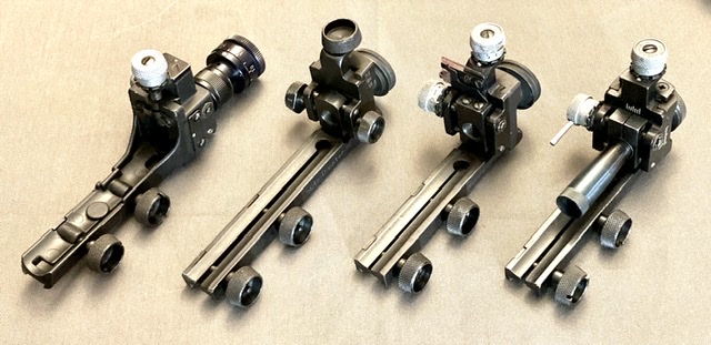

I have several vintage Anschutz rear sights that I used to shoot prone with on my match 54 rifles. Send me a text to 225-933-0220 and I will send you a pics of what I have. Don't know what the 6702 sight looks like, but may be what I have. Sight fits a standard Anschutz 11mm dovetail Rear sight includes anti glare tube and adjustable iris. If you can use it let me know and we can talk about $$. Also have front globe sight with adjustable iris and .3 eagle eye ,anti cant level etc.
Richard

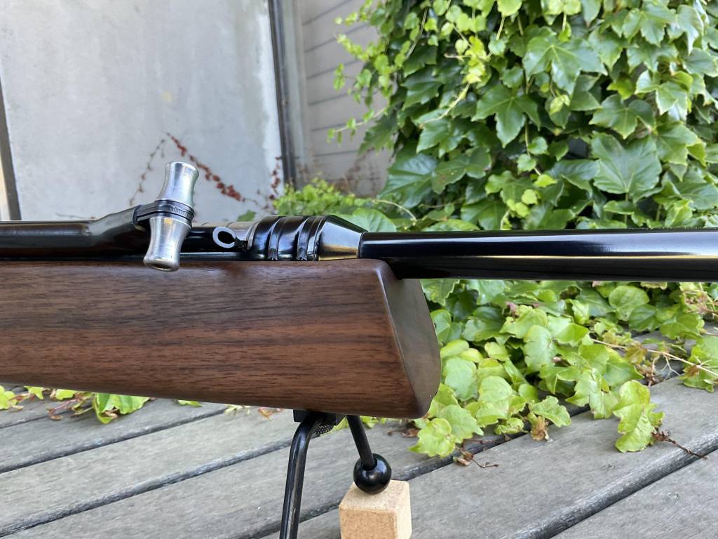

That's a fantastic example, wow! And I quite agree - the 220 was arguably THE single biggest leap in match air rifle design. It started an "arms race" that's still going on, lol. I would add to your list of features: a) the ergonomic, subtly upward ergonomic swing of the sidelever; b) the 220 was also made in a true left-handed action.
The 6702 sight was made for years, with some variations.The first, as fitted on the 220, had a nifty clear acrylic scale for both elevation and windage - a nice touch, as you can see both settings from shooting position behind the gun.
The older 6700 is interesting...the windage adjuster does not click, but works like a Sheridan sight, i.e. to move it left you loosen the left knob and then tighten the right one; capable of extrememly fine movement. The elevation has a normal clicking adjuster.
Later the 6702 lost the clear bit in favor of scales marked on the sight body; you see them with and without a reference lever on the windage knob. Left to right in this pic: 6705 (alloy); 6700, early 6702, and later 6702 (all three steel). The glare tube on the last on is not an Anschutz part.

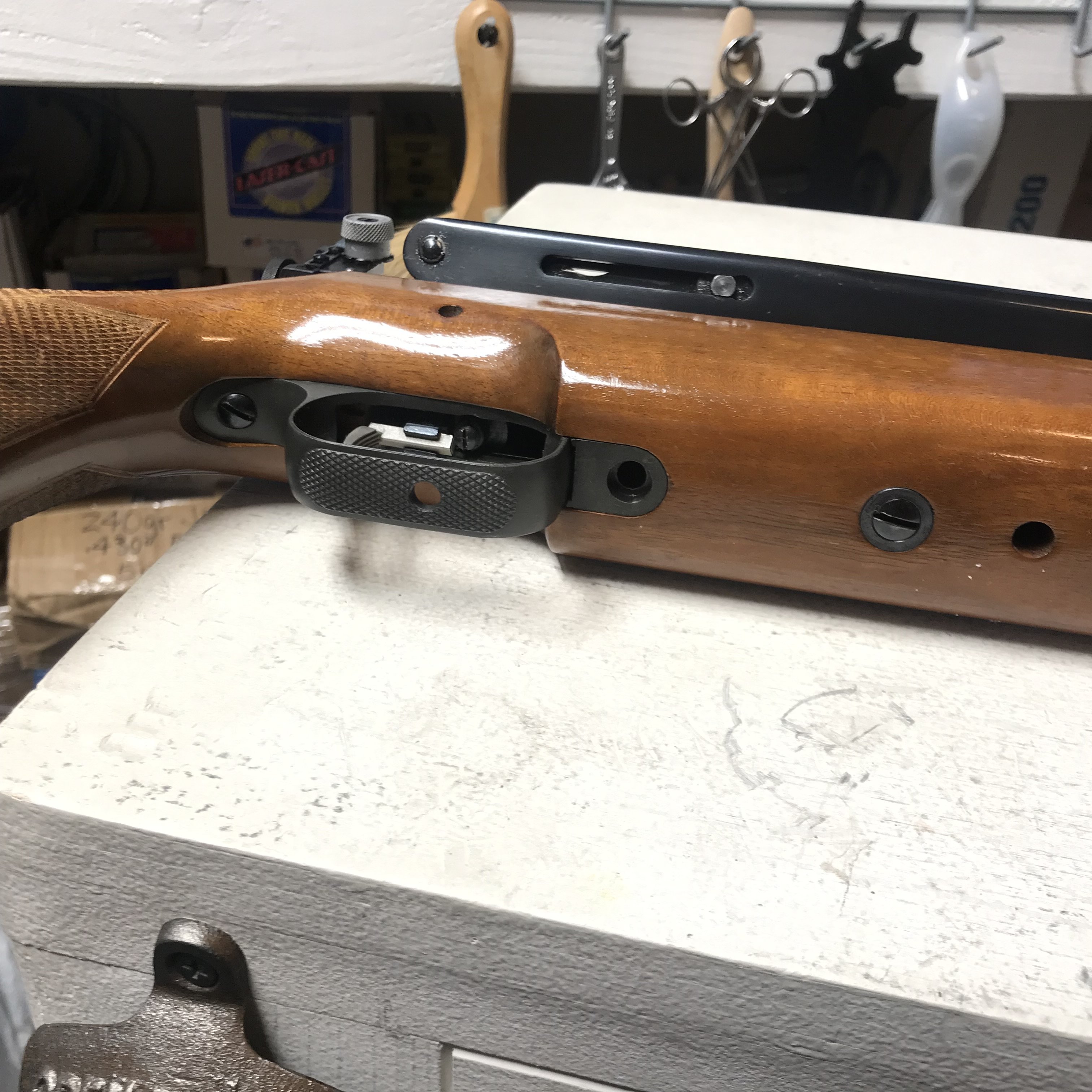

Reviving this thread in hope to gain more information on this uncommon rifle.

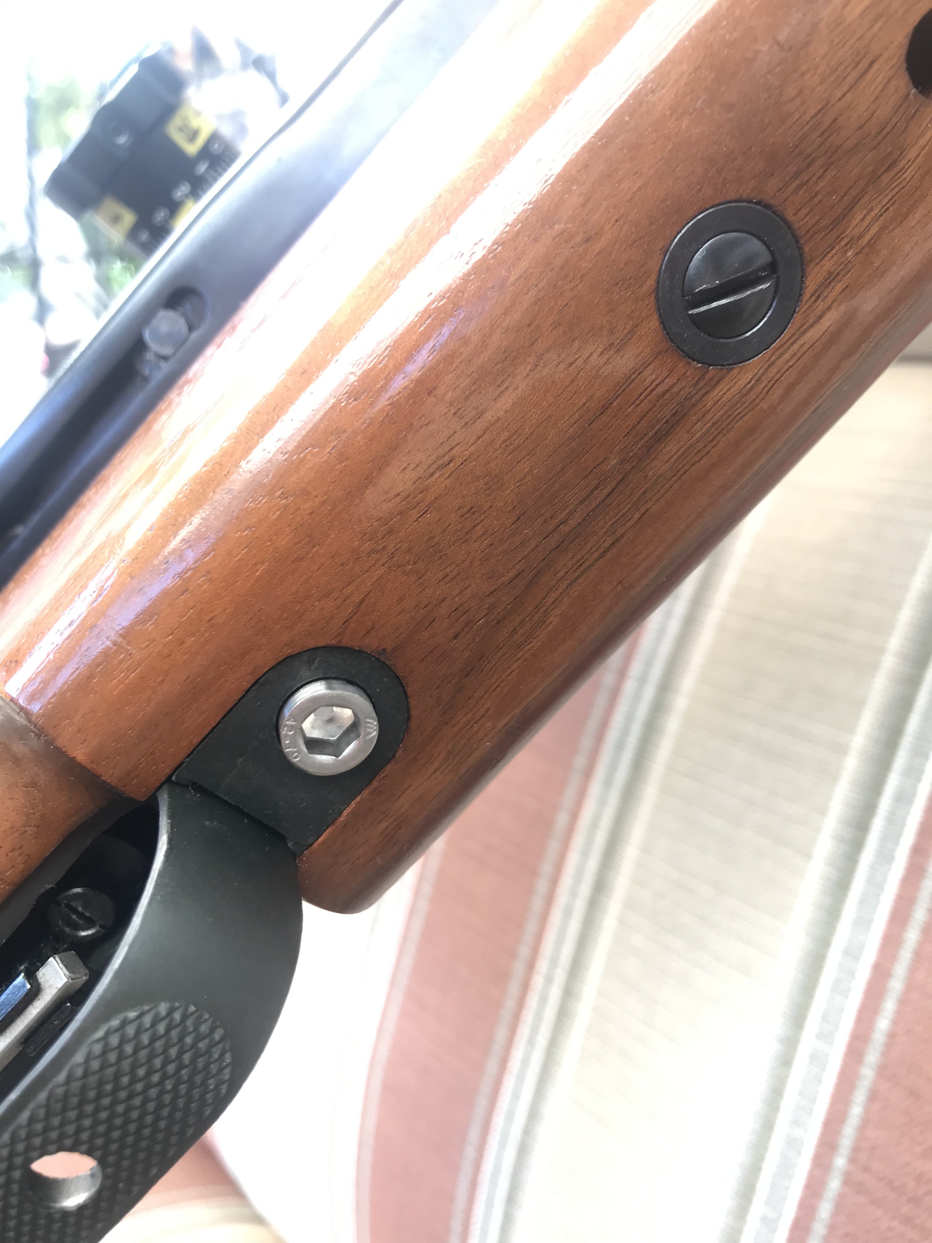

I just acquired one at auction Beautiful gun. Unfortunately a screw is missing. It is the one directly in front of the trigger guatd. Please see attached photo.
Anyone with a schematic of this gun? Operator’s manual? Anybody with knowledge on the size and thread pitch of this screw.
Got lots of questions, but want to fix one thing at a time.
Thanks
Bob H
Tacoma WA
Reactions: JamesD.
There's a PDF English model 220 user's manual on this page, but I'm having a hard time getting it to download to my iPad:
On the screw, I'd be willing to bet it's something more or less standard-ish. It'll be metric of course, but you could take an educated guess at the length, head type, and thread and then pick up several that are close from the many online hardware sellers out there. I successfully did that for HW 55 stock screws a couple years ago, working from this site (but there are many others):
Metric screws are sized by exterior diameter and thread pitch, in millimeters and fractions (the rear sight's eyepiece thread is 9.5mm x 1.0mm, for example). These might be the same as the other big stock screw in your underside photo.
Reactions: MOSOSODBOB
Thanks to a member on this forum I was able to view a schematic and gain the needed confidence to disassemble the rifle and see how things are attached. The stock screws, three of them, all different length, but are the same diameter and pitch. It is 6mm but a fine thread pitch. Not the more common 6-1.0mm found at the box stores. I suspect it is the o.75 pitch. Have ordered a batch from Amazon and will confirm that is the correct size when I have them to try. Thanks to all with your input and leads to info and resources. Will post a report when I get this rifle into operation.
