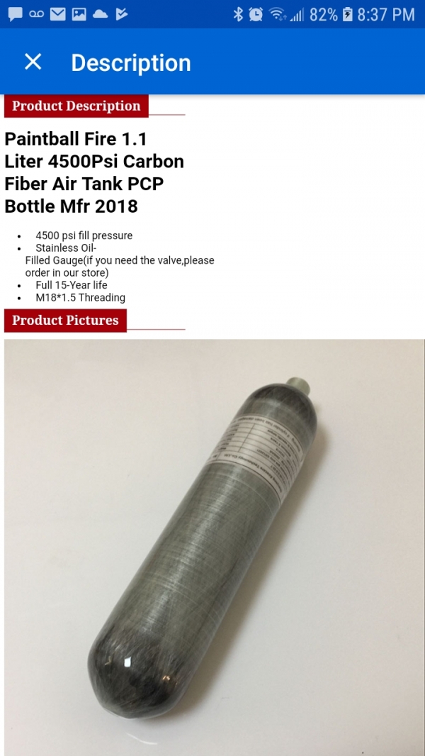

1. Has any one put an after market bottle such as this one on a Texan?
2. What is the threads on an original Texan's bottle? I think they are 1/2 UNF, but am not sure.
I believe with this power an unregulated gun is better, if the shot curve can be flatened. I just think a bottle that is almost twice as large would yield a much more usable shot curve. I'm thinking in .257 or .308 Texan should five or more shots with a 20fps spread. Is it possible? Maybe I'm wrong?
Any input would be very much appreciated! I would like to know more before spend too much $ on a stupid idea. Thanks!

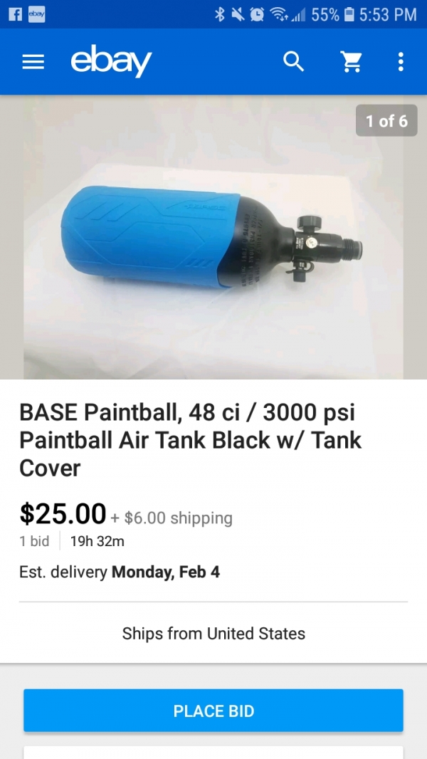

The Texan bottle should be M18x1.5 just like the other AirForce bottles. That paintball bottle is likely NOT M18x1.5 but likely 5/8"-18UNF
