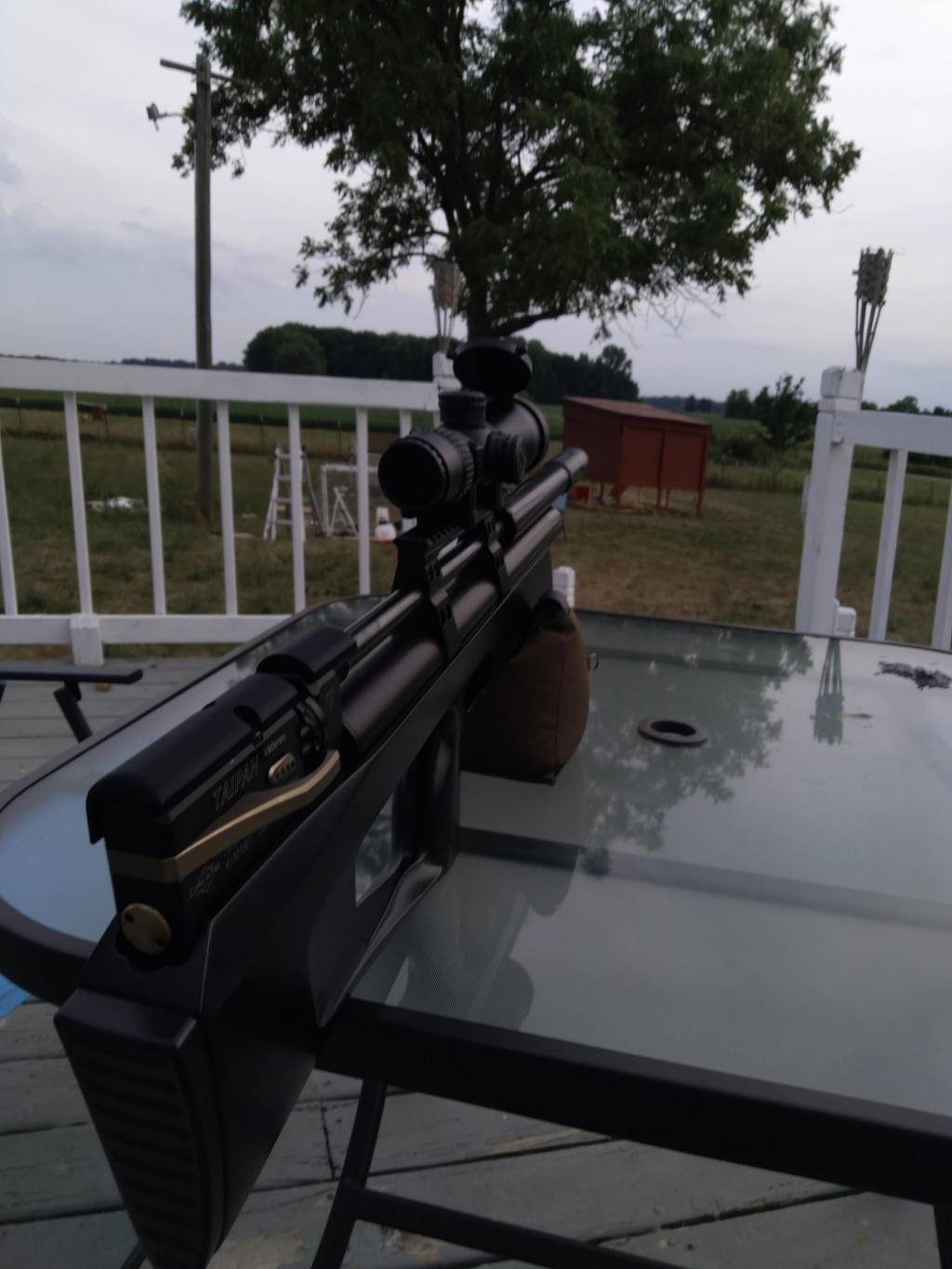

What scope rings are you using?
Thanks!
Hawk Match Mounts. https://us.hawkeoptics.com/match-mount-1-2-piece-weaver-high.html
I switch to a SUMO when a little more hush is needed.
Drop it into a Standard sized stock when target shooting (thanks, Uncle Hoot!).
Use the Shorty stock for carrying.
Below: Standard stock and SUMO.
