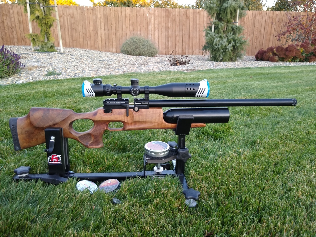

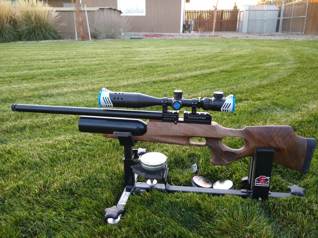

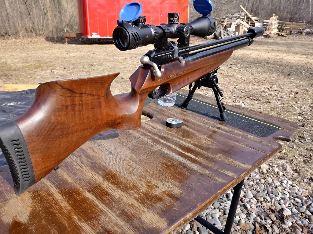

.22 Kral Puncher Breaker update.
Home tune: Polished internals (bolt,hammer,receiver,trigger components,ect.),ported valve,enlarged transfer port from valve to barrel,upgraded cocking lever,Donny Fl Sumo,Lane regulator set to 130 bar.
55+ shots at 32/33 fpe with JSB 18.13's. Half inch 12 shot groups at 45/50 yds and Quieter than a Nerf gun!
Love this little Bargain Blaster!
Mike
Mike there's something about that gun, I too have a 22 & just love it . I have taken 15 nutria with it & its my hunting gun . I have a cricket & edgun among others but it's my go to . For a cheap gun it will perform . Thanks for the post but you just cost me some more money you little bugger .lol Darell P.S. try a Pappy_Yosh biathlon lever on that thing you'll like it.
I have one and did pretty much the same mods except I did not add a regulator. I ported and polished the transfer ports, redid the valve changed the spring, and poppet. Gets about 65 shots at 900 fps with USB 18 gr. Did you check the barrel to get the burrs out? I did mine and get less than half inch at 50 yards.
Yes I did radius the barrel port,also cleaned up the crown. Still have fine tuning to perform,just giving general stats performance wise as I just installed the reg. So far,so good.

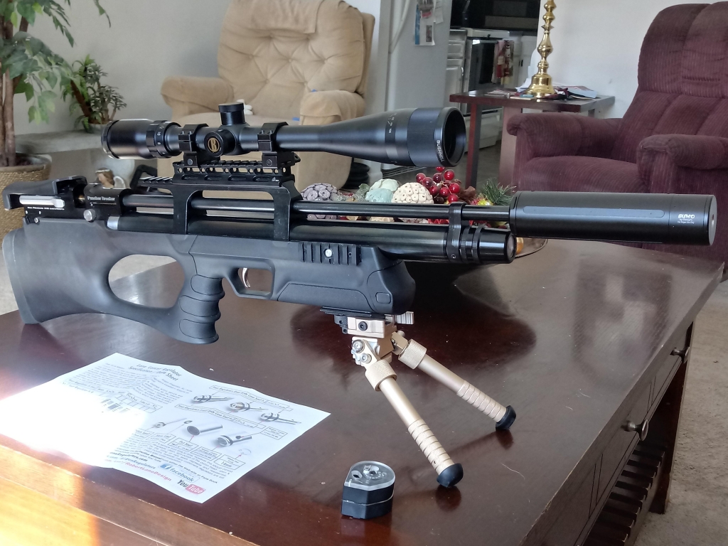

What I did is take the pic rails from the Breaker and Pro and used JB Weld to attach them to each side of the fore grip. The bipod is just an el-cheapo Atlas knock-off from ebay (24 bucks). For the price,it does its job quite well. I plan on getting another in black.

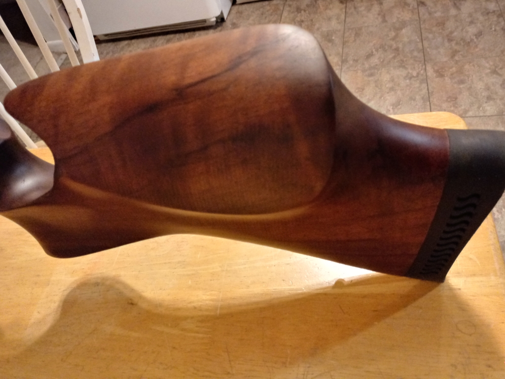

The Krals are a breeze to work on and with a little TLC (not the musical group) they REALLY shine! The Puncher Pro I purchased as a refurb ($379) is a real shooter,as well and the stock is nicer than my Air Arms.
