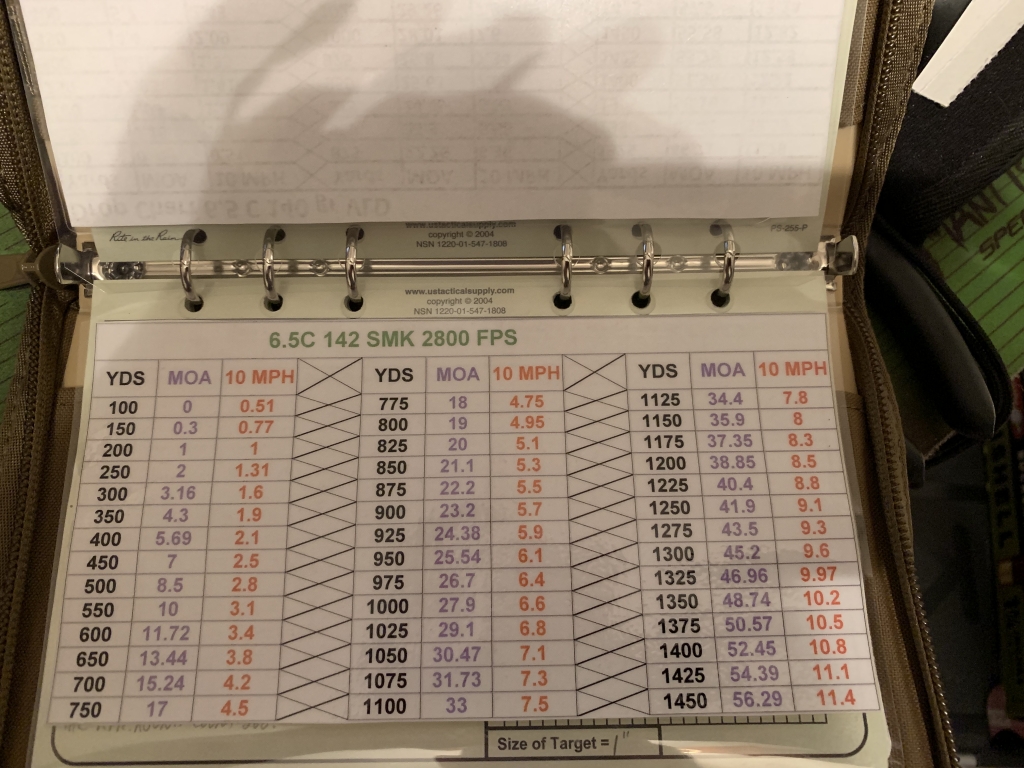

Any shot over 100 yards that I have connected with is due to Strelok Pro. If I can range it this app and my guns will drop it. Problem I have is the time it takes to range the game, input data and take the shot. Not all feather and fur just hangs around waiting to be blasted. Nevertheless the app has made me a much better long range shot. I use it with all my PCPs and 7mm Mag PB. I even have my buddies PCPs in the menu and inform him all the time on holdovers. Best app I ever used hands down.
1555608508_11651219345cb8b3bc52c127.43414309_C329B6B6-90CA-4C15-A624-4915B5029FFD.jpeg
Something like this. The card is apprx 4x7 so it fits my data book. Its pretty fast to use.
