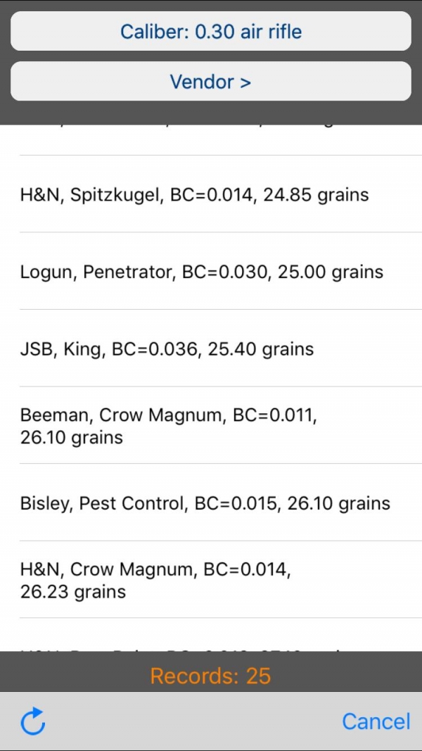

Strelok has a lot of pellets in the databse, but you have to click on CARTRIDGE. Not bullet database.
