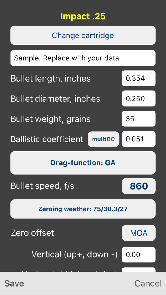

Ok, I'm not having quite the luck with strelok pro as mentioned here, if it says 5.3 pellet impact maybe 6 then two days later an 20 degree temp change and different range it will tell me 4.2 and the pellet will impact 2.8.. All my data appeaser correct, I've change the BC several time bases on pellet velocity at two know distances and using different impact points at known distances and nothing has given me reliable data from day to day.
second the BC monk shine offered was foe smooth twist not CZ barrels of the Vulcan.
i also see you changed the bullet length, strelok tells you 1.25 for .25 cal heavies which is very strange being all the others pellet lengths are correct.
Daxx why would your zeroing weather match your current weather?
