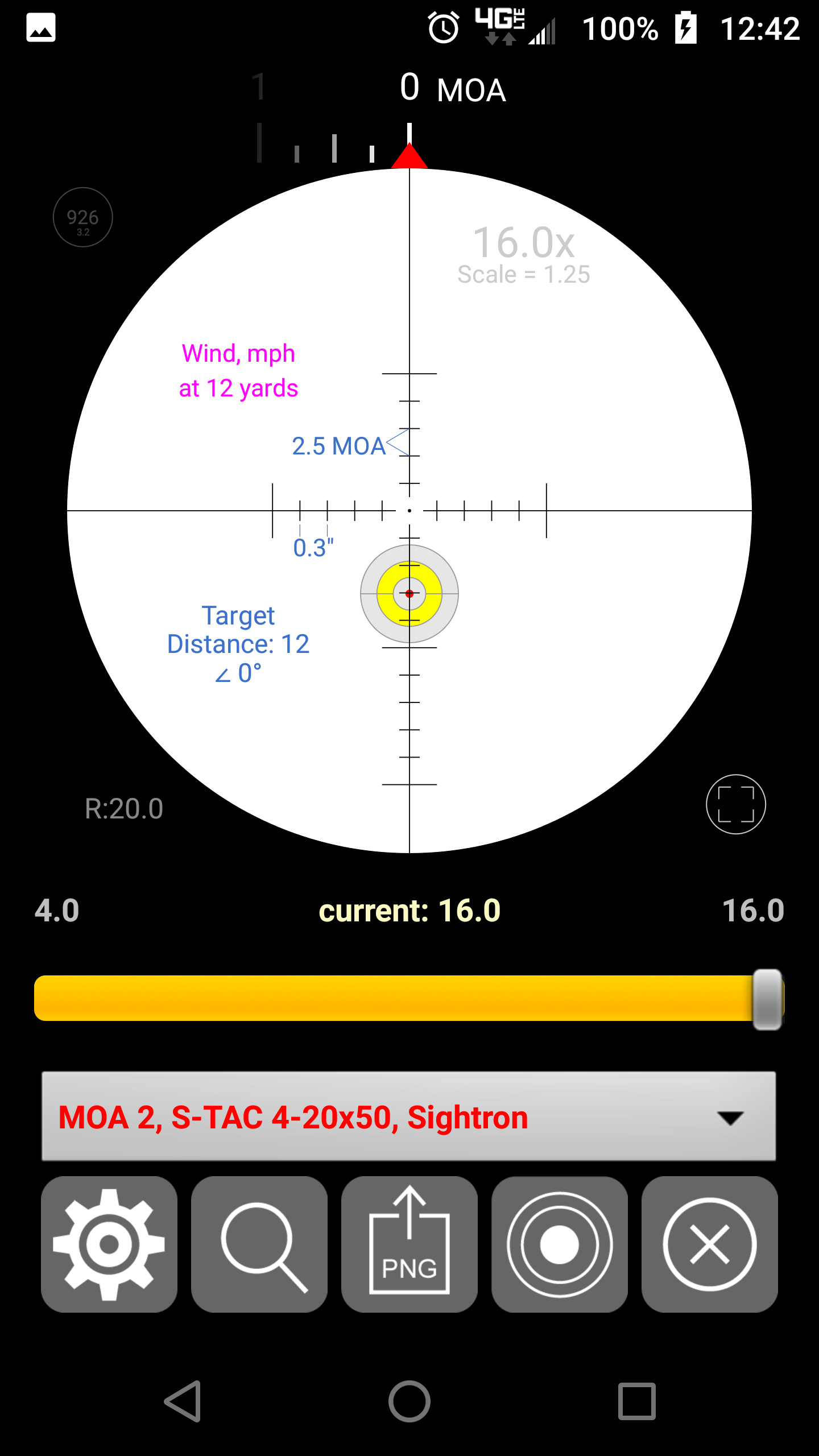

I just started shooting field target recently and have been using my elevation turret to adjust for the various distances of the targets, shooting in unlimited class. When I started out, I used Strelok Pro to determine the number of clicks for each target distance and the numbers Strelok provided are spot on. Now I'd like to move to hunter class, which doesn't allow turret clicks to adjust for each range to target, you have to use holdover. I'm trying to use the reticle feature in Strelok to determine the required holdovers, but the Strelok reticle view is way off. For instance, at 12 yards, Strelok is telling me to holdover two hash marks on my MOA 2 SFP Sightron scope at 16x. With this holdover, the pellet POI is around 3/4 inch high. Through trial an error, I determined the POI is actually only about 1/2 a hash mark hold over. I double checked to make sure something wasn't out of wack, by clicking my elevation turret (the four clicks Strelok suggested) and the pellet hit exactly where I was aiming. I can't figure out why there is such a discrepancy.

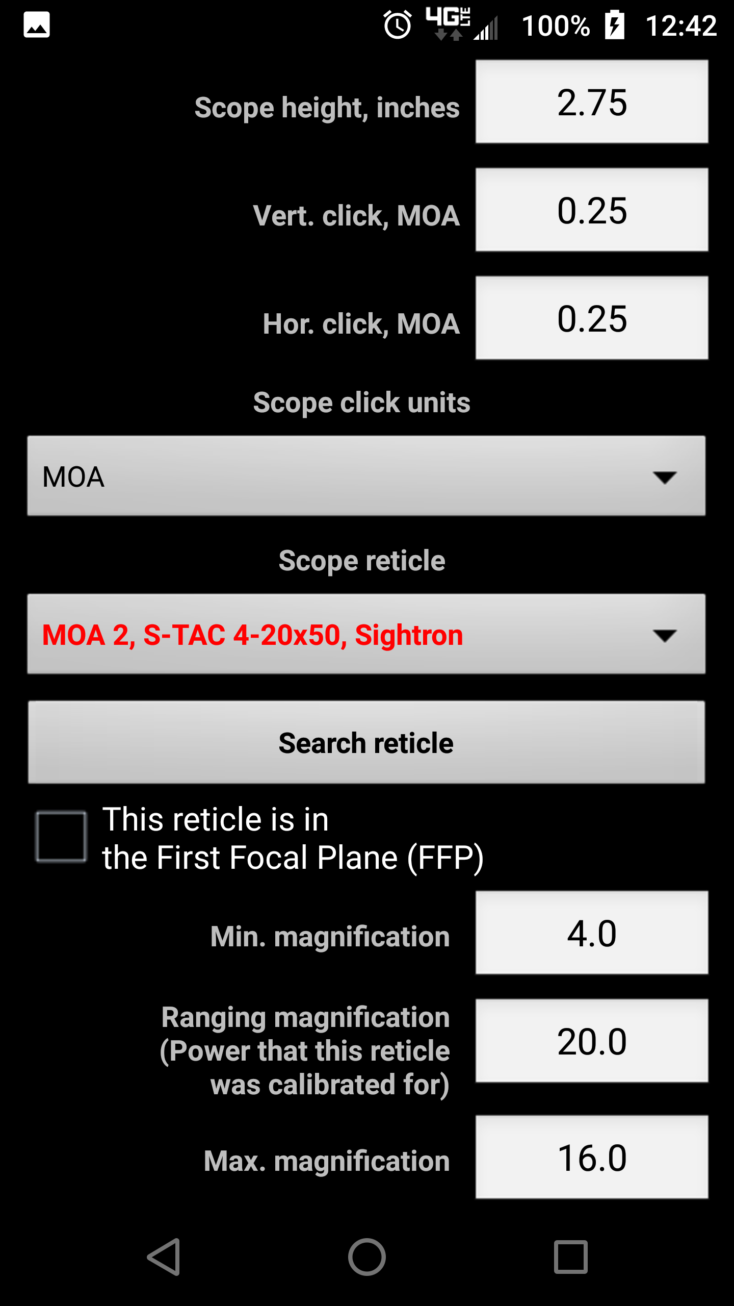

Go to the scope, click on that to set up the numbers as you have it dialed in for. Scope zero distance and scope height are fairly important. Next of importance on that page, at the bottom, is the "Max magnification" setting. That should be set at "16"
Also, when looking at the "reticle view" has a slide bar that needs to be slid olall the way over to the right at an 16X magnification so the reticle appears as it does in the scope (if actually using the scope's magnification at 16X

1) Make sure FFP checkbox is turned off (for your SFP scope as stated) and that the magnification settings are correct. Double check scope height and reticle type. The reticle and reticle units should match, sounds like it should be all MOA.

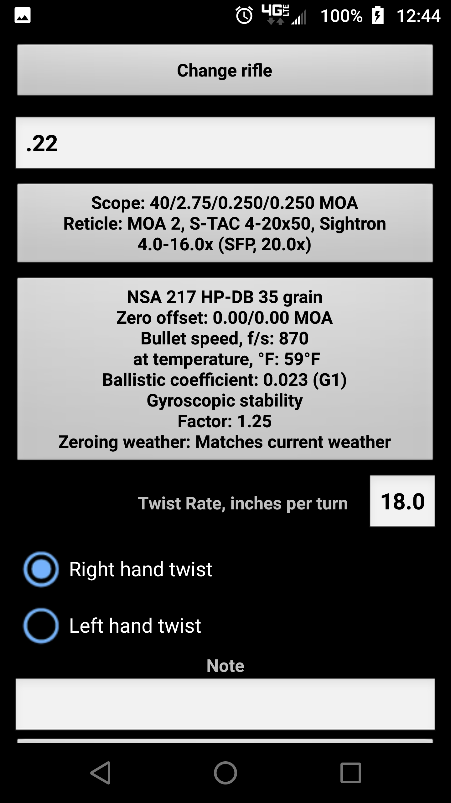

So I'm determined to figure out what I'm doing wrong (I won't let Strelok beat me, Ha!). I went out this morning and figured out that the app's reticle is suggesting I hold over exactly twice what is necessary (ex 12 should be one hash mark but Strelok says two). I checked this at other distances and the ratio (double) held at those too. I found a work around. In Airgun Hobbyist's second attachment, where he has 20 in the ranging magnification spot, I had 16 (which is the magnification I'm using). I doubled it to 32, while still leaving my scope at 16x and moving the slider bar in the app's reticle diagram to 16x. This changed apps suggested the holdover to one hash mark at 12 yards, and I'm hitting the target spot on now. Tested at a couple other distances and worked for those too.
