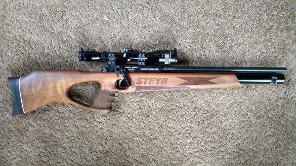

I too have a Steyr Hunting 5 Rifle and ran it across a chrono recently....using 21.14 grain H&N Barracuda, 5.52 head diameter:
935.6 - 938.5 - 939.0 - 945.3 - 934.8 - 930.2 - 935.4 - 938.9 - 941.8 - 938.4 - Avg = 937.8
941.0 - 939.3 - 942.6 - 942.6 - 946.6 - 936.4 - 937.7 - 940.8 - 935.4 - 939.6 - Avg = 939.0
This using the standard regulator with no hammer spring adjustment (it doesn't seem to need any). You can buy an extra regulator for it also, I bought a 12 FP regulator to shoot rats for instance. It's a very easy swap.
Another nice thing about the rifle is that the air tube can be removed while under pressure with a slight hiss upon replacing....bummer is that you need to remove the stock to get the air tube out.
I have heard of certain ones having a lower 5th shot, mine does not appear to have that malady, at least not yet. The trigger is wonderful.
There is a threaded adapter that attaches to the shroud for an LDC to connect. This makes it a very quiet rifle indeed. It is slightly heavy with a full-size 50mm scope and picatinny adapter rail on top.
IMO, it very well built. Much of what I have learned came from this site. Just do a search.
mike
