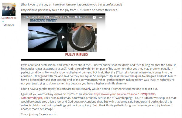

ST barrel is better than traditional barrel when wind comes ???
View attachment MTUzOTU2MjE4Nl8xODg4Njg3NjE1NWJjM2RhY2E3ZjRiMzkuMjcyNTAyNjlf5b6u5L+h5oiq5Zu+XzIwMTgxMDE1MDc1NDI5LnBuZw==
what I read in one thread here really makes me think that I have wasted 10 years in the airgunning hobby . Who can explain ST barrel's superiority in windy condition? I apprecitate it .
"I was adult and professional and stated facts about the ST barrel but he shot me down and tried telling me that the barrel in his gantlet is just as accurate as a ST. And I agreed with him on part of his statement that yes they may preform equally in perfect conditions. No wind and controlled environment, but I said that the ST barrel is better when wind comes into the equation. He argued with me and said no they are equal. So I respectfully said that we will agree to disagree and told him to have a blessed day and that was the end of the conversation. What I gathered from talking to him was that I'm right you're not your just trying to down something because you have a higher end rifle than me. " ——DakotaEnox8
