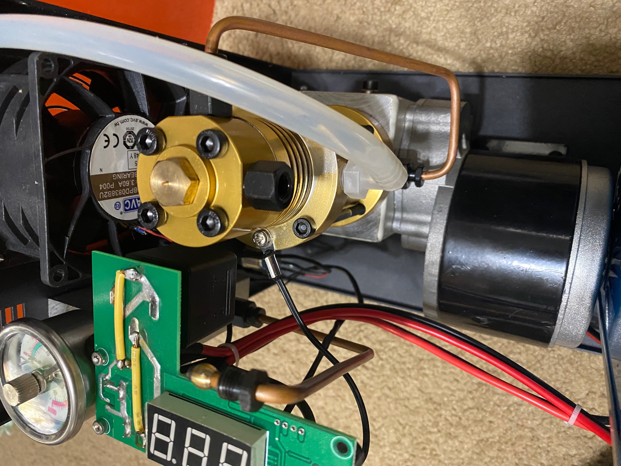

I got mine more than a year ago (with the built in power supply version) and after 6 months it started burning the green fuse at the back of the unit (unit did come with spare fuses). Changed the fuse 3-4 times all got burned within 10 sec. Any ideas as to what would cause this?

the motor is drawing to high of amperage, it might be a short circuit or a bad bearing, tight piston, many things can cause the fuse to blow, could also be a loose wire connection or a corroded connection, best to look inside and see what you can find, an Impedance meter would help to see if the wiring is shorted.

I found several loose terminal connections while repairing mine, which could contribute to that. Probably would be a good time to install the o-ring kit and change out the check valve on the top cylinder. These should all be included in the kit. My check valve caused mine to run high amps. There is a youtube video that covers the single cylinder model but is helpful in overhaul that can be found by searching Spritech daily maintenance (ignore all the electronics removal...it's not necessary). Lightly lubricate the internals and grease the piston rod. It's really an easy job...just take pictures as you go to keep track of things.

Could you maybe point out as to which part is the check valve?

I'm a moron, I believe that I after using the comp' at home at 220 I might have forgotten to to switch it back to 110 when connected it to my car battery out at the range, that could cause a blown fuse I suppose...

It's just a spring/check valve fitting that goes under the bolt with the little spike on it on top center of the upper cylinder, no other disassembly required other than taking off the outside cover. It's the only thing that hex bolt is for. As far as the voltage setting, when hooking up to DC battery the voltage setting doesn't matter since it is DC powered anyway.
