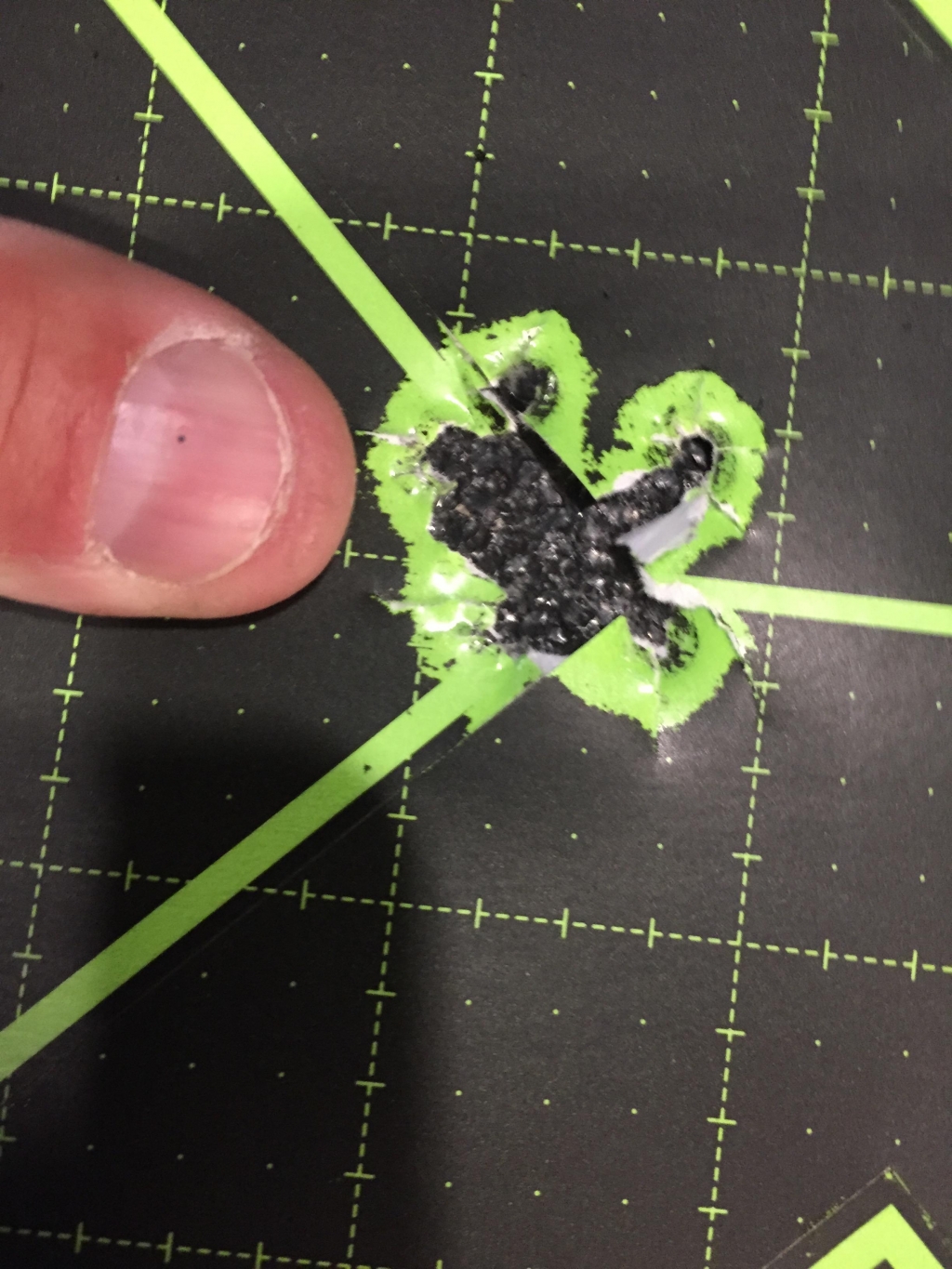

My Impact X, 700mm, 44.75 pellet likes 920fps
100 yard 10 shot
