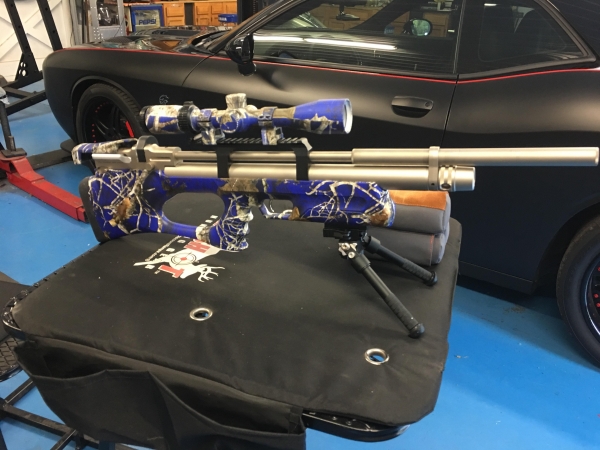

I too own a Kral and my advice if you decide to get one is to buy it from thammer already upgraded with his valve set up,had him do mine and it’s a sweet little gun,have not had a chance to shoot it much at 100yds but it shoots as good as my wildcat at 50yds I have turned it into a project gun.
