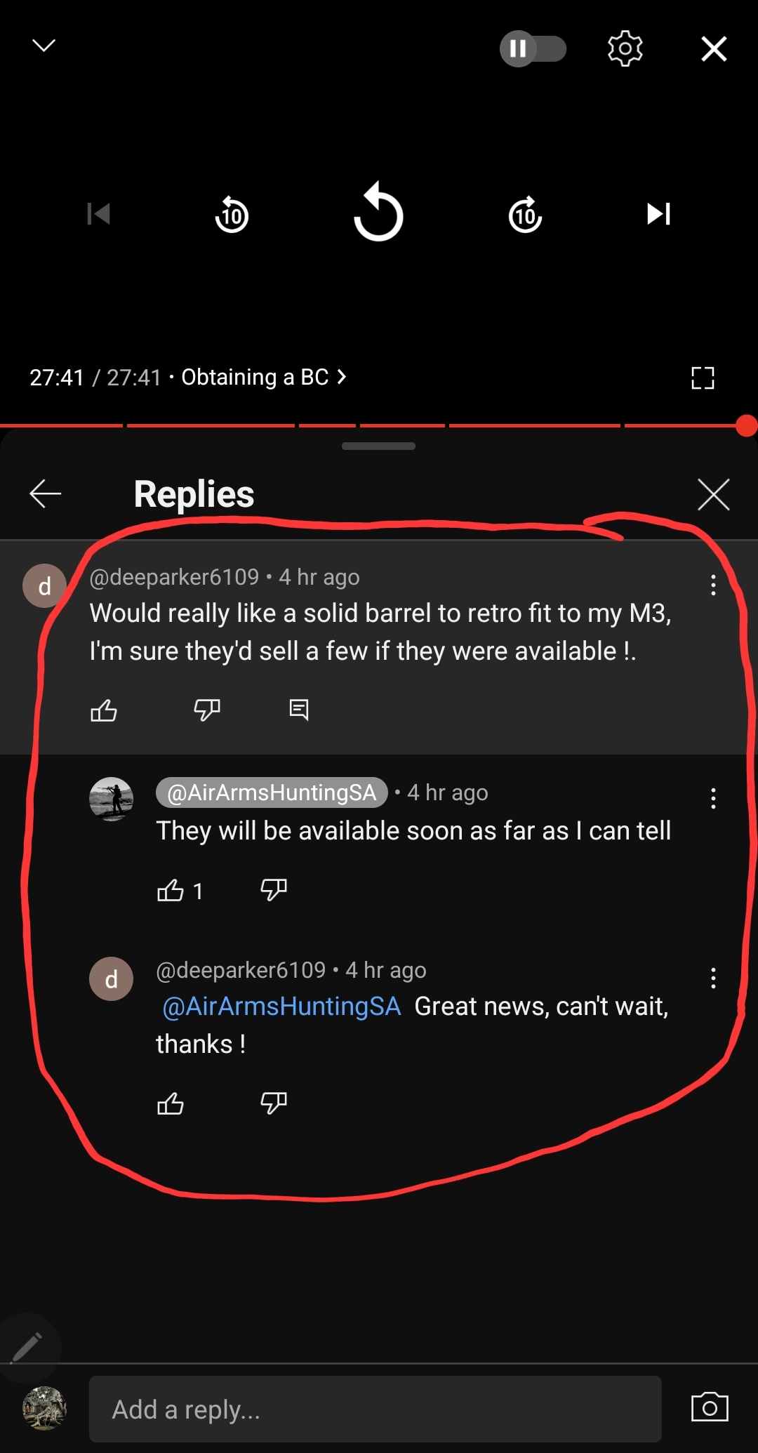

Listen and watch again. That’s not what he said. He said it has an optional stainless steel heavy outer barrel housing that the liner slides into. Same liners as every other FX.

Hmmmm, I think some still don’t get it. It’s a HEAVIER STAINLESS STEEL replacement for the current lightweight outer barrel. It goes together just like the current assemblies except the old part is replaced with the new one. From what he said the Superior Liner fits snugly into the new outer housing so I’m guessing the OD is the same but the ID is less meaning it is a thicker wall. Not sure where this sold barrel notion comes from ? Maybe the liner is epoxied in there but then changing out a few dozen liners and putting all but one or two back on the shelf wouldn’t be possible. What am I missing?

As per Matt Dubber reply as shown above, such sturdy barrels based on FX liners would be available for Impacts and other FX guns.
