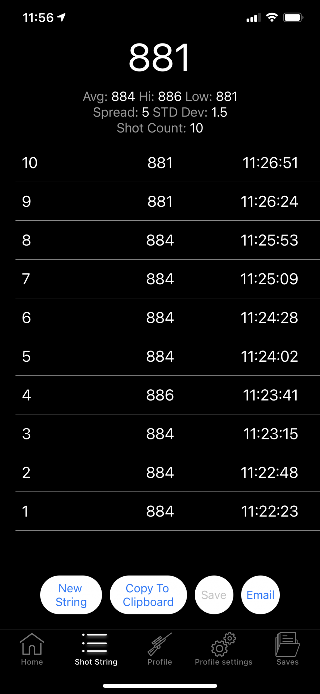

My buddy who I gave my Avenger to has been a gunsmith for a long time. The first thing he did to his new gun was to put some lead into the pistol grip and some expanding foam into the butt stock. With these mods he has told me that he's achieved a better balance of the gun (now right at the pistol grip), a more solid feeling stock and a little more weight for a more stable feeling gun when shooting off the bench.
881, 881, 884, 884, 884, 884, 886. . . . . . talk about consistent. Very nice. and the ideas of putting electricians putty in the butt stock and lead in the hand grip are great too. that is one consistent complaint is balance, but lead and putty should do the trick. Since I have how many pounds of shot pellets sitting in the shop - shouldn't be a problem to find lead.
