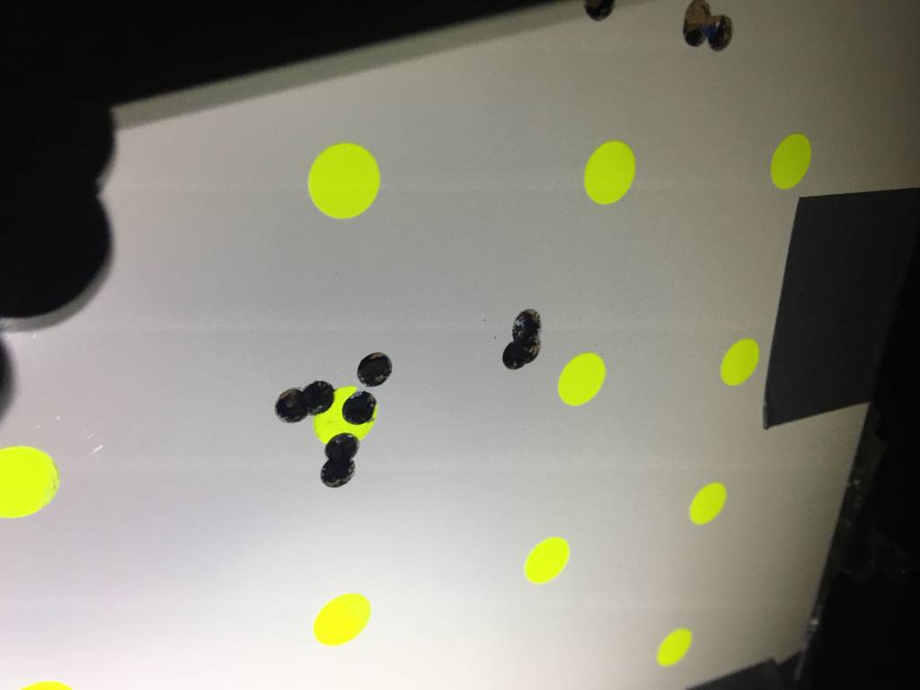

The Javelins .217 26 gr started to show promising results with a group of 4 shots ctc of 5mm (repeated twice in succession) at 36m and a 24mm group at 100m. BUT, the ES was too large for my liking, around 16fps. AND then I ran out of slugs!!

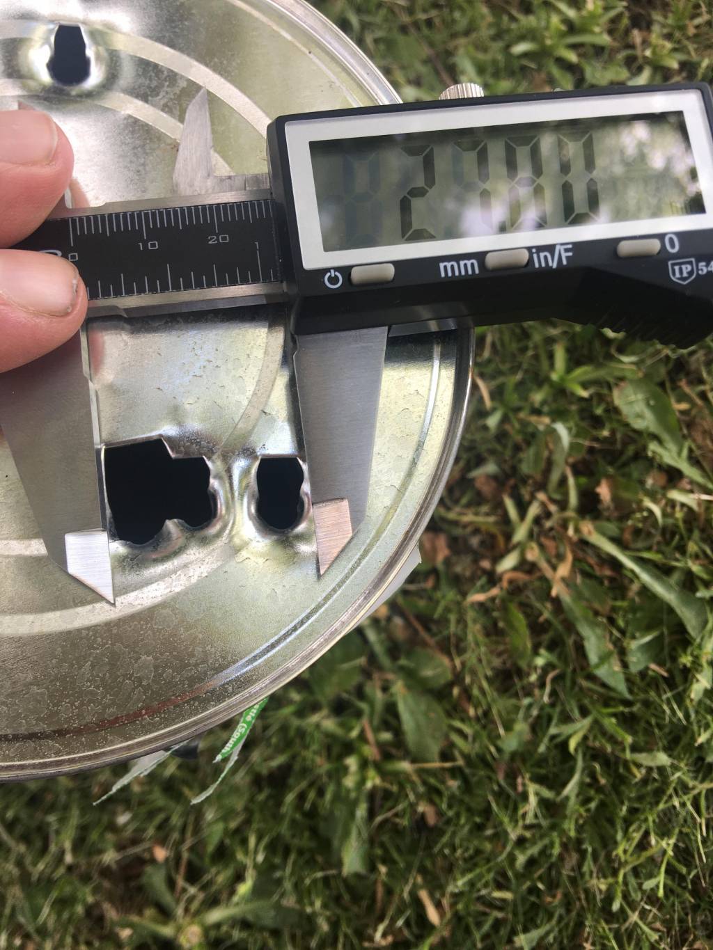

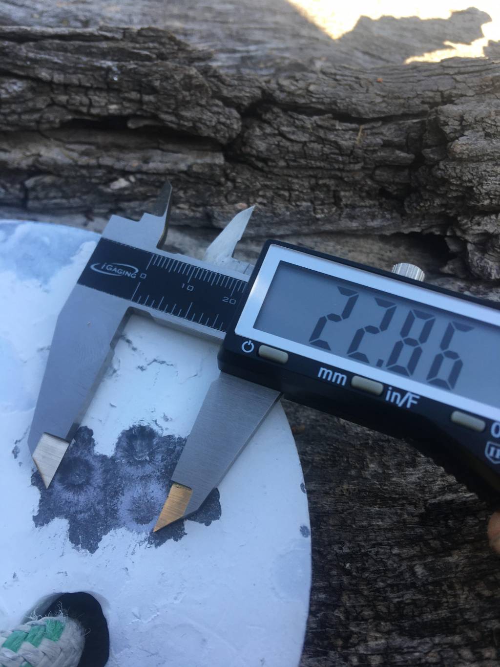

The group on the left on the paper was the second to last group at 36m before the smallest possible turn of the valve adjuster finally got me to the land of accurate slugs. Then confirmed the tune with many 100m groups with most (80%) sub MOA in windless conditions on the gong. The group on the tin was a three shot group at 141m. Most at this distance were MOA.
