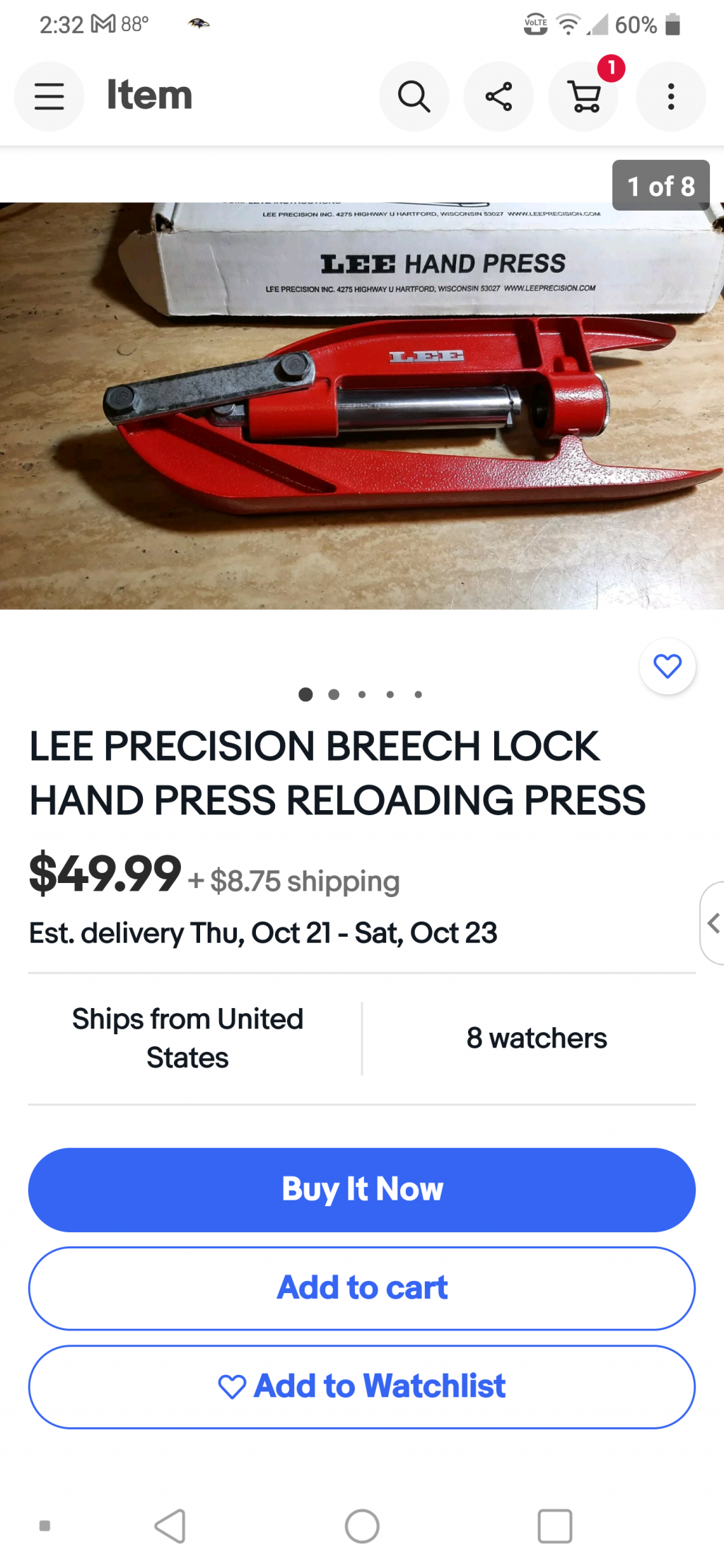

Measure with a micrometer. I have a similar reloading press from Lee, you can size them down so they don't bite so hard in your barrel. Probably 100$ or so in equipment. Lee press and NOE sizing dies.
Just checked Lee’s website. doesn’t look like they have anything for .25. 😩
