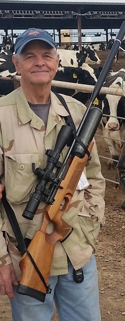

VudongthoaiI have one on my Boss wood stock. I was going to install myself, but I have the same problem to see how thin the wood is. So, I just paid a little extra for AoA to installed it for me. On the other hand, I installed the swivel studs on the Streamline laminated by myself.
Vu
