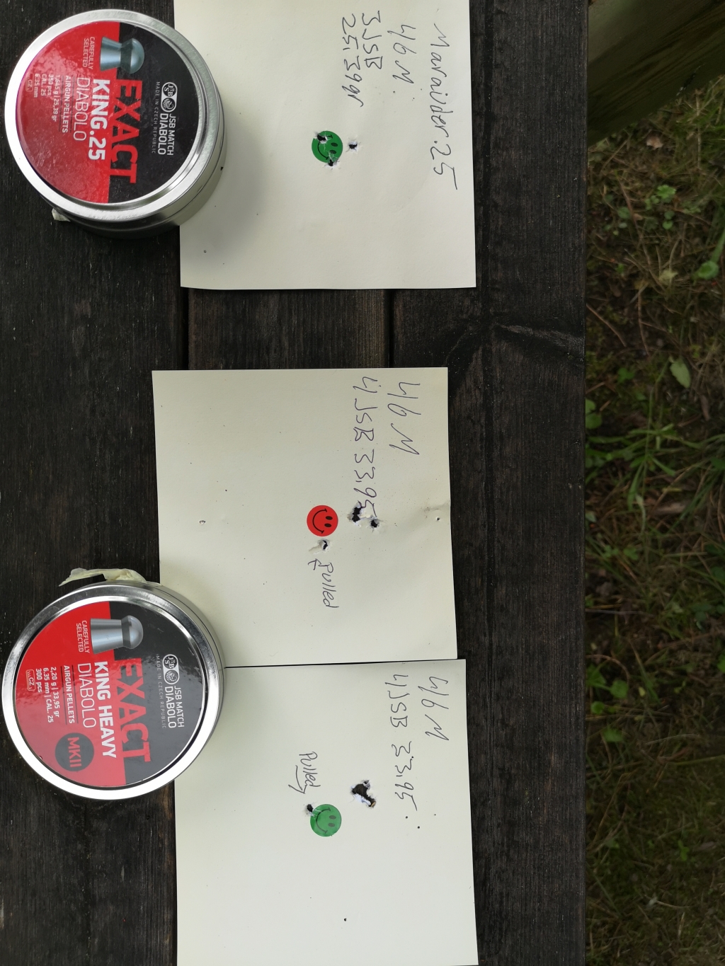

Chronoed the marauder, jsb 25.39gr was about 836 ft/s or 255 m/s, jsb 33,95gr was 738 ft/s or 225 m/s, power is 39 ft/lbs or 53 joule for the 25.39gr and 41 ft/lbs or 56 joule for the 33,95gr, don't have enough air in the scubatank to fill her up completly only to 170+bar so cant do any string, but does that look ok or is it to low? The tune is full opened transferport, hammer spring tension 5 turns clockwise and hammer stroke adjuster 3 turns clockwise
Testing the accurasy with the 33,95gr and no difference from the 25.39gr in groupsize, just me that have to shoot pcp more cause i mostly shoot springers and I pull the trigger when i wait for the kick from the buttstock that doesn't exist in pcp's...

For a completely stock marauder, your current speed with the 33.95's is normal and what I obtained stock.
