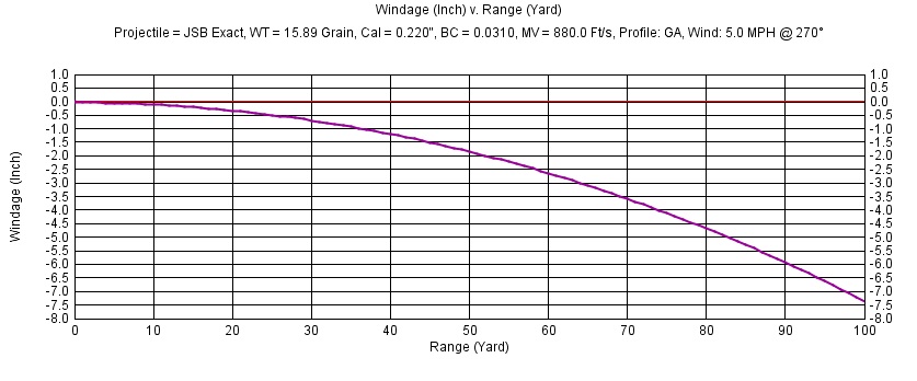

Wind drift for a .22 JSB 15.89 gr pellet shot at 900 fps

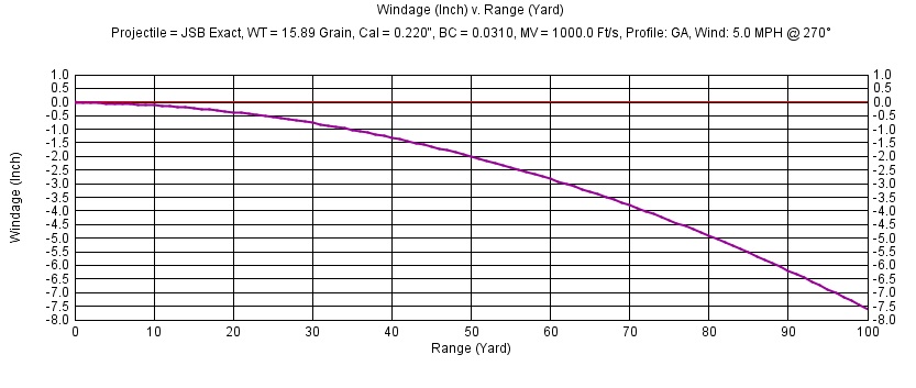

Same pellet at 1000 fps
More wind drift at a higher velocity? Suggests there is more at play here than just velocity.
Not much more wind drift though and if you slow down enough it gets worse again. So there seems to be some "optimal" velocity at which wind drift is minimized. This may not actually be true however because the drag models are not perfect. What we are seeing here may well be (probably is actually) an artifact of the drag model we use itself.

Exactly. IMO, too much focus on this unless one is shooting at extreme ranges. I assume the above charts are accurate. If so, and to the ability of my eyes to resolve that chart, slowing from 1000 to 900 at 65 yards caused a wind drift difference of about 1/4". And IMO that would APPEAR as just NOISE in shooting at that distance, due to variation in the wind, pellet inconsistencies, shooter error, etc. And I assume that drop amount would have probably been a bit more with the velocity drop, which isn't particularly helpful. Is the effect present? Yes. Is it noticeable functionally. I'd say "minimally". Is it possible it would cause an additional miss out of a given number of shots? Yes. Is it likely to significantly affect the number of misses seen? Probably not, IMO.
Dropping further to 850 might well influence the wind drift a bit more, but I bet it would be a very slight impact. Drop would also increase a very slight amount as well, however. No free lunch and as with many things, often a balance to be struck, as you note.

From what I can see on your chart, the bc is the same at 880 and 1000. BC is not fixed and the comparison would be fairly worthless in this manner. It's been shown by a good number of trials that pellets BC over 900 fps begins to go down. I did a good number of tests in the ART project and documented the BC's of each barrel at different velocities with the pellets we were wanting to be the preferred. Can't recall a single instance of them being better at higher than 900. The decay may not have been rapid, but it was there.
