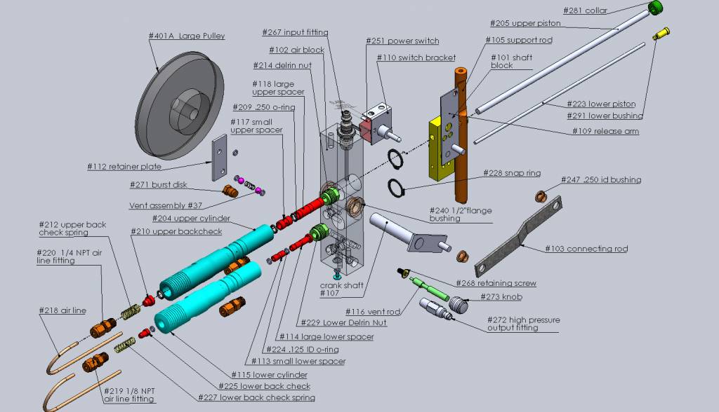

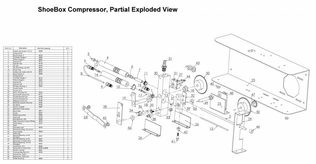

unfortunately the only diagram I have is of the unit itself and the manual.
