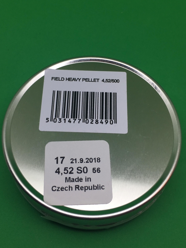

First up, the JSB. I have probably shot 15-20 tins of this pellet, and don't recall any that were really "bad".

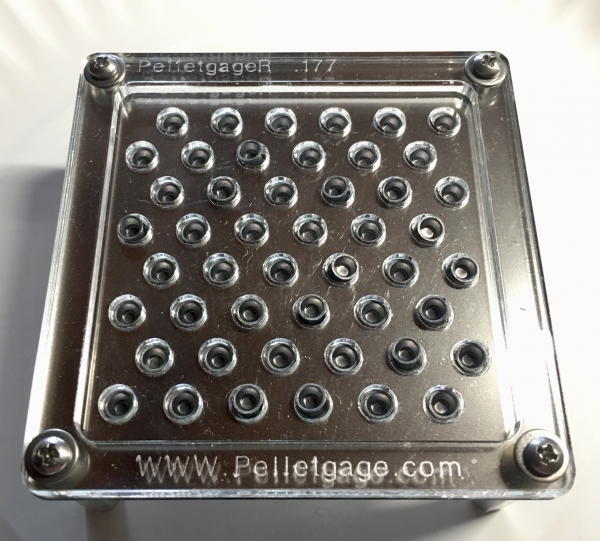

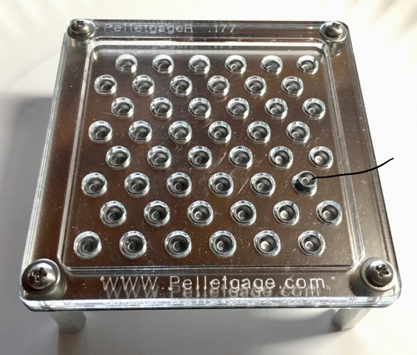

I used my PelletgageR first. My idea was to use this experiment to confirm that a PelletgageR would give me measurement results similar to the normal Pelletgage. I took a sample of 48 pellets from the fresh tin. The PelletgageR was set up with 4.53 upper gage plate, and 4.51 lower gage plate. If the pellets drop through the upper gage, they are under 4.53. and if they catch in the lower gage plate, they are above 4.51. This is what I wanted to see. If they drop through the lower gage plate and catch on the skirt, head size is <4.51.
No pellets >4.53. Just ONE pellet in the desired >4.51<4.53 range (whoa!). 47 pellets under 4.51. Not what I wanted.
I must brag, this took maybe 3 minutes. Should have timed it. I do intend to produce a video to show how this works - it is fast. I believe that if I had the majority of the pellets dropping in the position with the line (above), all would be well.

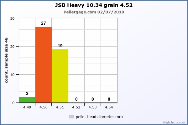

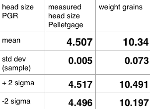

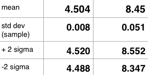

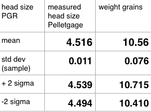

Next, I took those same 48 pellets, and used a standard .177 Pelletgage to check the head size of each one, and I also weighed them on an electronic scale. Here are the results:
1549573931_6933913235c5c9f2b4981f0.74949010_Screen Shot 2019-02-07 at 4.11.12 PM.png
So, the mean size of the pellets in the sample is 4.50 mm and 95% of the pellets in that tin (+/- 2 sigma) are 4.493 to 4.515 mm. The results correlate well with those from the PelletgageR, too (yay).
Weight variance seemed pretty good. 95% can be expected to be between 10.5 and 10.2 grains.
This is a very consistent range, in my experience, but it runs too small. See the histogram below. Note, all the pellets in the sample are <4.51 and the mean is shifted 0.02 mm from nominal. It demonstrates to me that JSB has process control, although they are not taking action to correct a shift. The red peak ought to be on the 4.52 column. I suggest a histogram is the most obvious way to illustrate the issue.
From my admittedly simplistic view of statistical quality control, these pellets are a reject.
My premise is that if the mean was within 0.01 of the nominal (that is, if the pellets sold as 4.52 mm had an average of 4.51) and if the deviation was in the range +/- 0.01 (which notably, this tin DOES meet), that is a "pass". I will work on the other two tins and post results by tomorrow, I have dinner plans tonight.

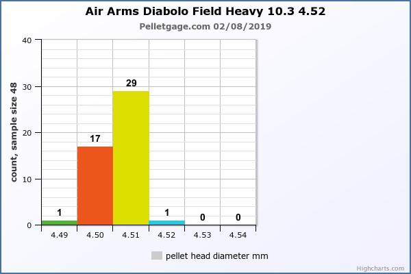

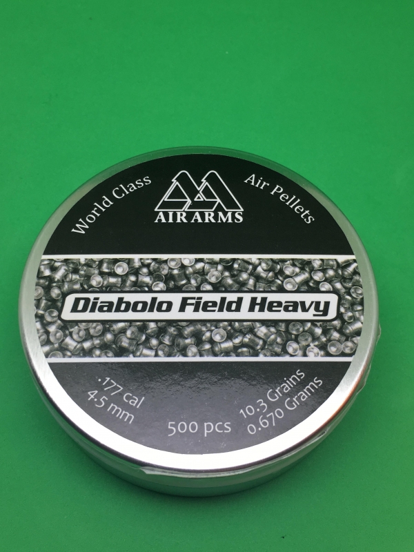

I've finished sampling and gaging the AA Diabolo Field Heavy 10.3 pellets. The results were amazingly close to those of the Air Arms
Using the 4.53/4.51 PelletgageR, the AA pellets look to be a bit larger head size. I timed myself, this took about 80 seconds!
I got this count:
<4.51 34, >4.51<4.53 14, >4.53 0
Then I took each of the 48 sample pellets from the PelletgageR, weighed each, and used a regular Pelletgage to get a head size. I tabulated the results
Statistically, this shows good control!
and here is a histogram (I suggest this is all you really need to see)
I'd say these are almost identical to the JSB pellet tin in both head diameter and weight. The size shows a tight distribution, but they are a little more than 0.01 below nominal 4.52 size. I think they would be fine in my rifle. Those of you who want the "real thing" might not be pleased.

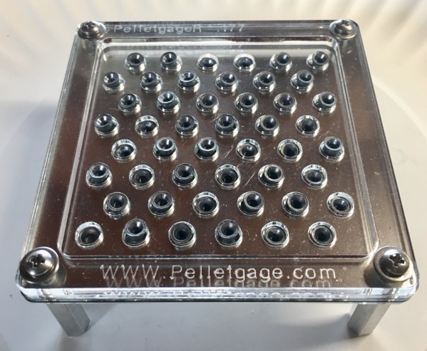

Here's what they looked like in the PelletgageR. I got this result. As for finding some 4.52 mm pellets, it looked much better.
< 4.51 15, >4.51<4.53 33, >4.53 0

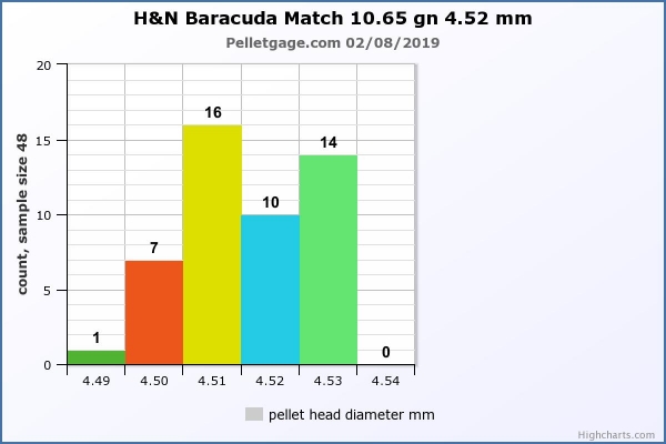

So then, time to weigh and gage each pellet using a regular Pelletgage. I tabulated and found this result
1549661046_18352073635c5df37693cc32.32360284_Screen Shot 2019-02-08 at 4.00.44 PM.png
And here is the histogram:
I believe that two pellets in the sample of 48 would be likely fliers. One had a head size of 4.49, and another weighed only 10.22 grains.

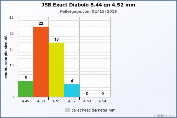

In addition to the three tins of "heavy" .177 checked last week in the first posts of this thread, I had ordered one new tin of JSB Exact Diabolo 8.44 gn 4.52 mm pellets. Yesterday I sampled 48 pellets from the 500 pc tin, used the PelletgageR first and got this result.
<4.51 mm = 45, >4.51<4.53 mm = 3, and >4.53 = 0
I then weighed and checked each of the same 48 pellets with a regular .177 Pelletgage, getting this result, which correlates very well with the PelletgageR result.
1550429669_13072314145c69ade5d2db97.99289397_Screen Shot 2019-02-17 at 1.53.35 PM.png
this is a graphical histogram:
My check of these pellets confirms some other assertions that the JSB 4.52 mm headsize pellets can run quite small. This is a shift from the nominal to the mean size of more than 0.02 mm. I say this, considering that in using the Pelletgage, I identify the pellet size as the largest aperture that the pellet will clear, which means that there is a slight bias towards the results being higher than actual diameter. And again, the process control for head size seems OK, with an unexplained bias for nominal size being higher than actual.
