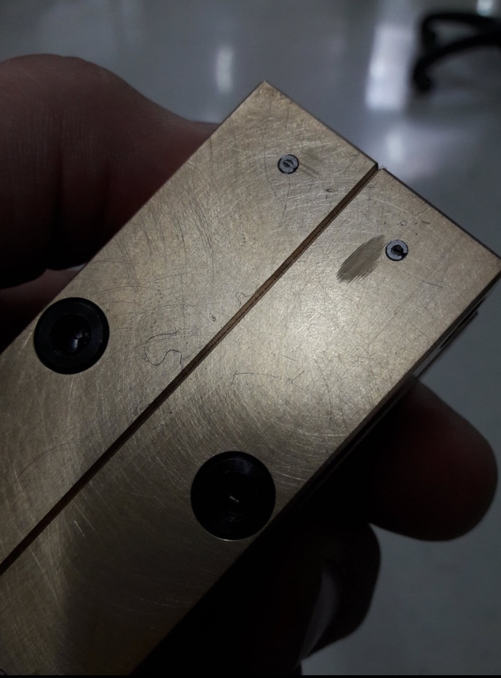

Being a total newbie to slug casting, I have started trying it with a 8-cavity , .22 cal mold from MP Mold. As expected there is a seam line on all slugs but I wonder how big the step along the seam line is considered acceptable. I have tried to measure it by clamping one half of the mold on a machining table, put the other half on the top and move it back and forth with my hand and measure the amount of play with an indicator. The reading is 0.05 ~ 0.06 mm. This is measured when the mold is cold. I am not sure whether it will be larger or smaller when the mold is heated up.
May I know if such amount of play is normal ?

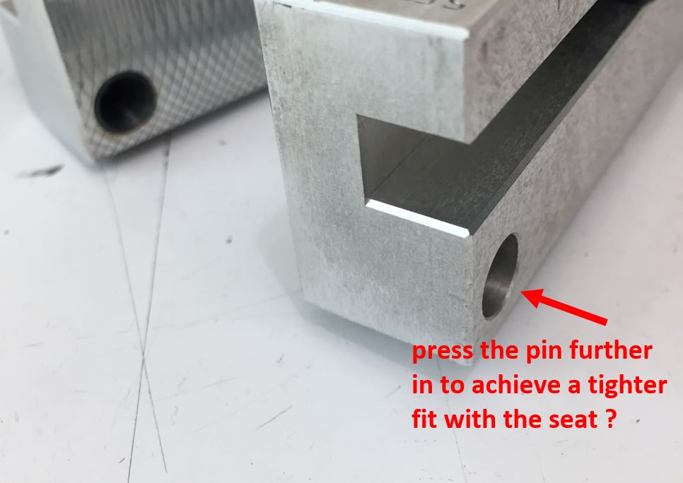

It seems that it is possible to reduce the amount of play by pressing the alignment pins towards the seats with a vise but I am not sure if it is a good idea.

I wouldn't try to press that alignment pin in, it's probably OK. Even with the mold closed if you see a very small hair line space at the bottom of the cavity (that would be the nose of the pellet/bullet) that is OK and actually helpful to allow the bullet to fill the mold completely. There are many reasons to have a seam line. Alloy/lead temp, debris inside the mold halves, not lubing the alignment pins, handle hinge and connecting points to the mold too tight. The mold halves should be a little loose on the handles, so they can find and move into position on the alignment pins.
Believe it or not, how you pour the lead into the mold is a big factor. I've always used Lee bottom pour furnaces. If I let the lead stream enter the mold through the center of the sprue hole I often get a seam. There's just a little too much pressure. I offset the pour (bounce it off the sprue hole actually) the seam goes away and the bullets are perfect.

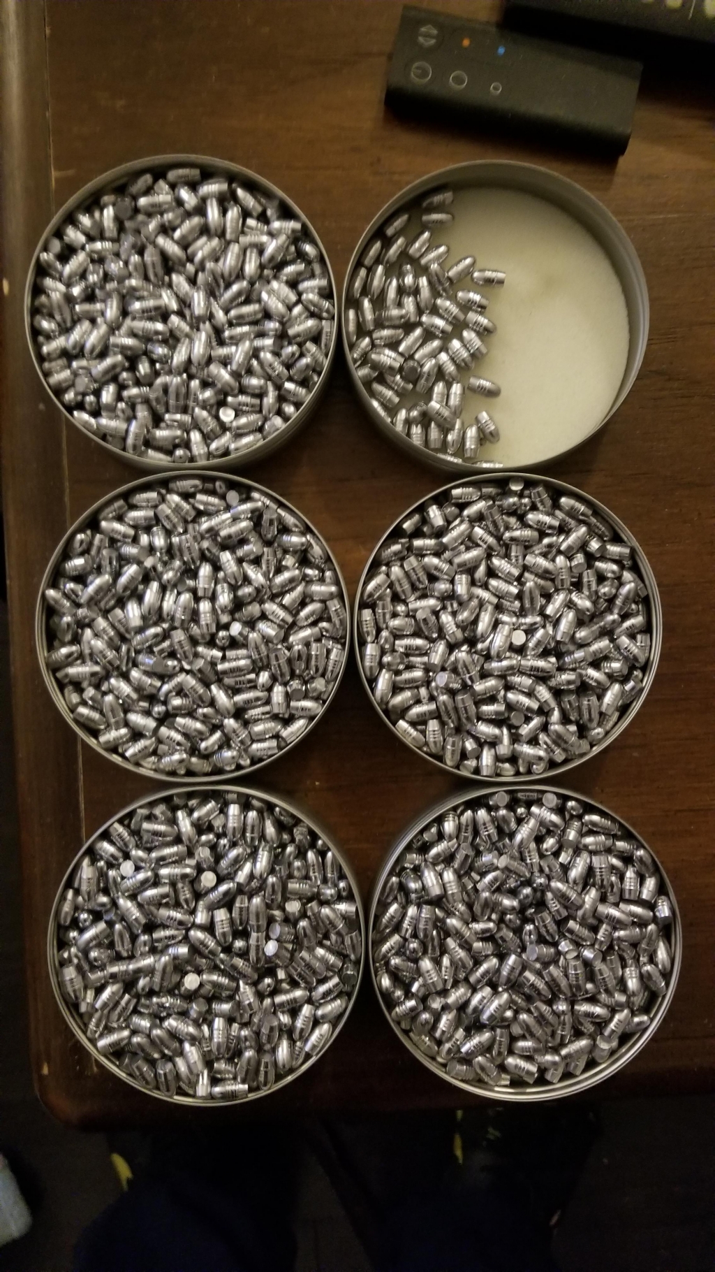

I use the same mold and get great results. I did have one casting session where I couldn't close the gap between the plates tight enough. I ended up with some slugs too big to use, I then noticed there was something smushed onto the plate not letting them come together tight.
Been all good since and pumps out beautiful slugs fast, I use a ladle and works fine.

Then disaster happened. Because of the violent smacking actions, the aligment pin moved outward and made it impossible to close the mold completely ! I thought that's the end of it. The mold was permanently damaged after less than 30 pours and producing just a handful of usable slugs.
As there was nothing more to be lost, I heated up the mold , put it into my table vise and pressed the two halves together. Much to my pleasant surprise, the play previously seen is now gone ! The fitting between the mold halves is now perfect ! I went on to cast some slugs and this time I sooted the cavities to ensure good release. DA DA !!! . No more seam lines ! All the slugs look just perfect ! I am so pleased with the quality of the mold that I ordered another one of slightly smaller head diameter ( 5.52 mm ).
