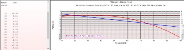

Chairgun by Hawke Optics is another good free tool. Your FPS, pellet weight and scope height are a few of the factors in determining point of impact. Here is an example
for a gun shooting 790FPS and using 7.9 Crosman CPL pellets. This setup is zeroed at 18 yards and scope height is 2.7 inches. At 30 yards it would shoot about 5/8 inch high then at about 43 yards it would be back on target.
Great advise from al, one important thing is your scope height. Bullpups will put your scope higher off the bore. This makes close range shooting involve more calculations, and more foregiving at longer ranges. A disco with med mounts and a bugbuster the scope sits 1.5" over the bore this gives you a pretty flat shooting gun from 10 yds to almost 40. Learn Chairgun, and don't get frustrated if your reticle is not listed. Try using generic and take note of the holdovers in inches
