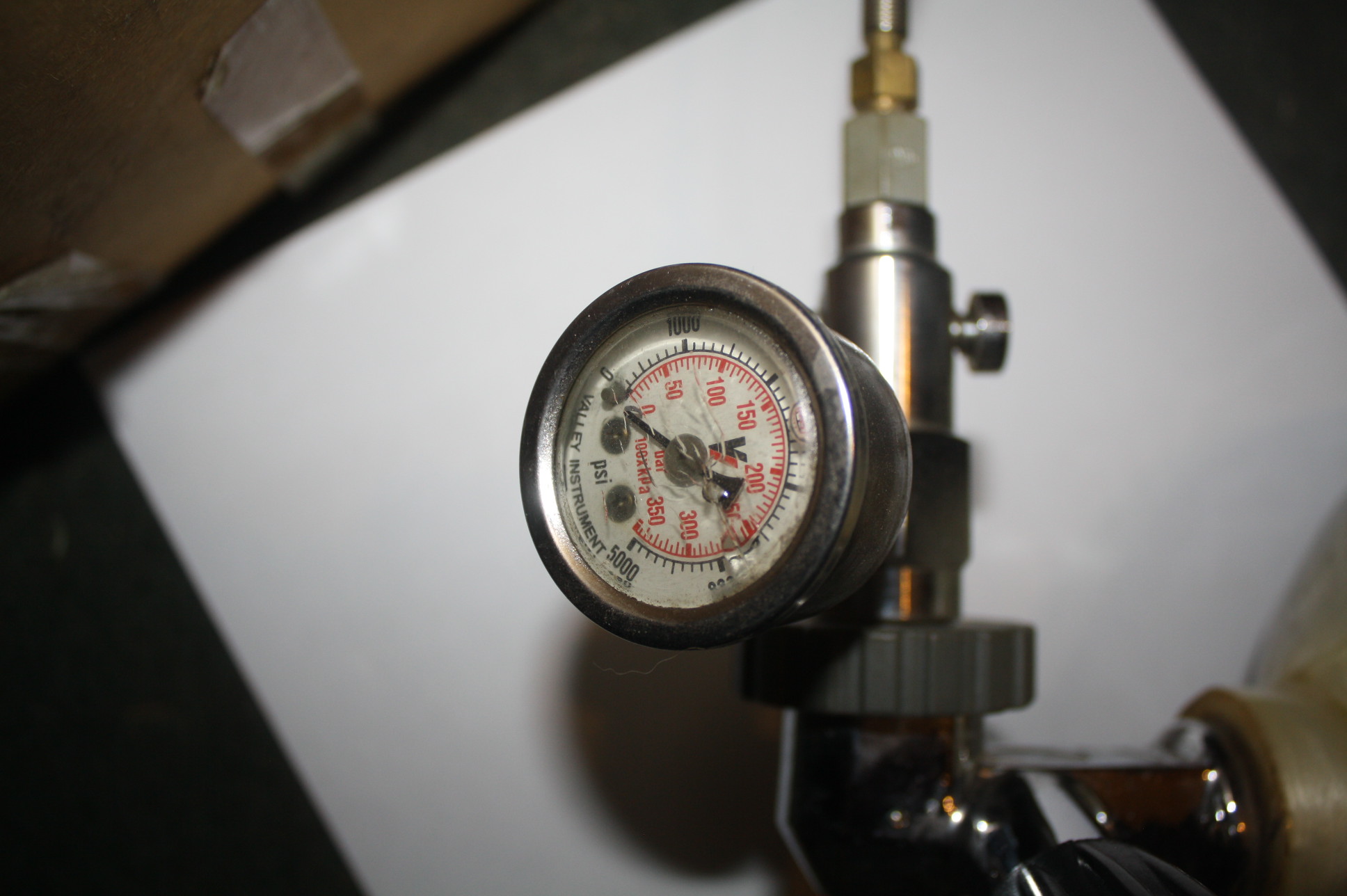

I am in the market for a new valve assembly for my SCBA tank.
Photo below of my old valve, with push button release, and worn out gauge with bent needle tip. If you look close, the tip of needle is actually bent from releasing pressure too fast. Its easy to do, due to the push button style release knob. Its difficult to gently press the push button and release pressure, without releasing pressure too fast! I DONT LIKE THE PUSH BUTTON RELEASE.
I prefer that my next valve assembly include:
1. LARGE GAUGE ....4" would be ideal for my old eyes.
2. A knob that screws to release pressure...No more push button that releases pressure much too fast, and bends the gauge needle.
I see the $200 Saber Tactical Valve Assembly, and Im leaning in that direction, and then probably upgrading to a larger 4" gauge due to my eyesight.
Is there another valve assembly that anyone would recommend, over the Saber Tactical, that offers a larger gauge?
Is there anything better, that would include a larger gauge, and maybe be priced less than $200 ?

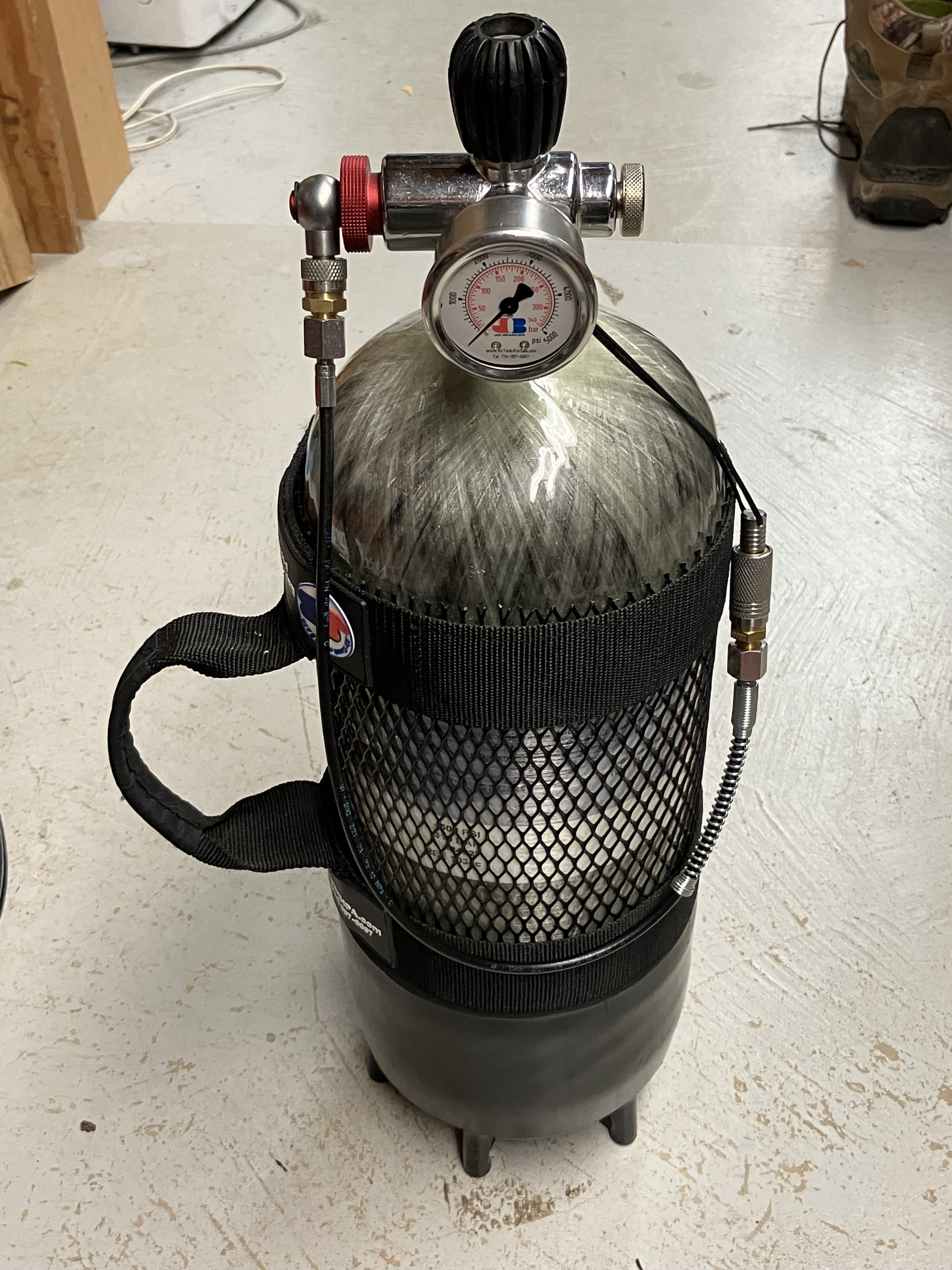

I’ve had the Joe B valve on my tank for 7 years now with no complaints, it’s not cheap but nothing about this hobby is. I don’t mind paying for quality. A friend of mine told me years ago, “quality only hurts once “.
X2 as scubajeeper said. One nice feature on Brancato valve is there is a restrictor for when you are filling your gun. But when filling your tank the restrictor is bypassed. Its design is similar to a check valve except it has a tiny orifice in it. Buy once, cry once. I know Brancato occasionally takes a beatinng here, but for the most part he sells good stuff.
I too have a JB valve on a JB Guppy tank that I have had for about 6 years. It did develop a leak after about 4 years of use, and I has to buy a replacement valve stem for JB to get it back in service. I do like the slow fill nature of the valve. Some things about the JB valve are better, and some things about the ST valve are better. Such is life . . . .
