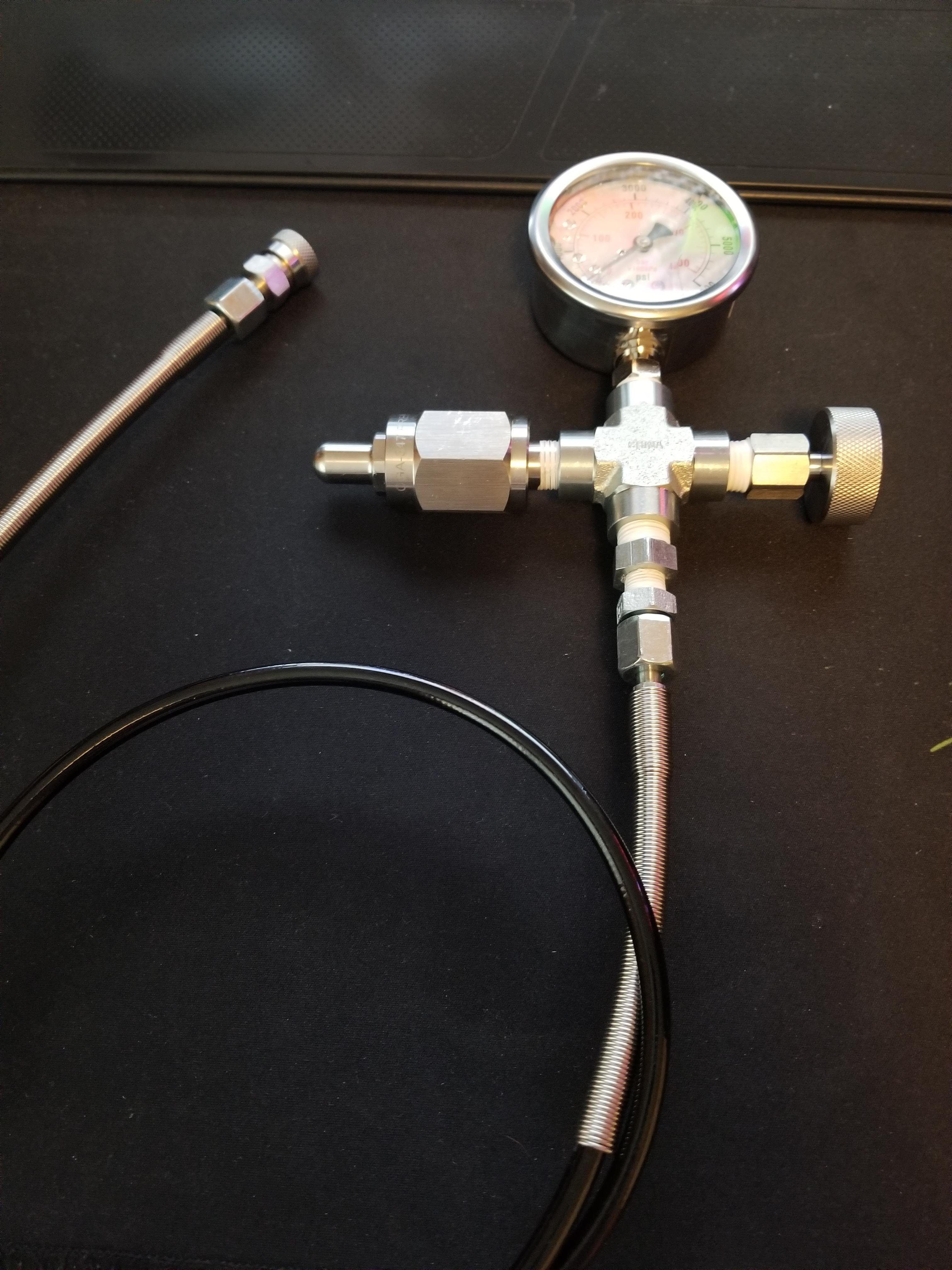

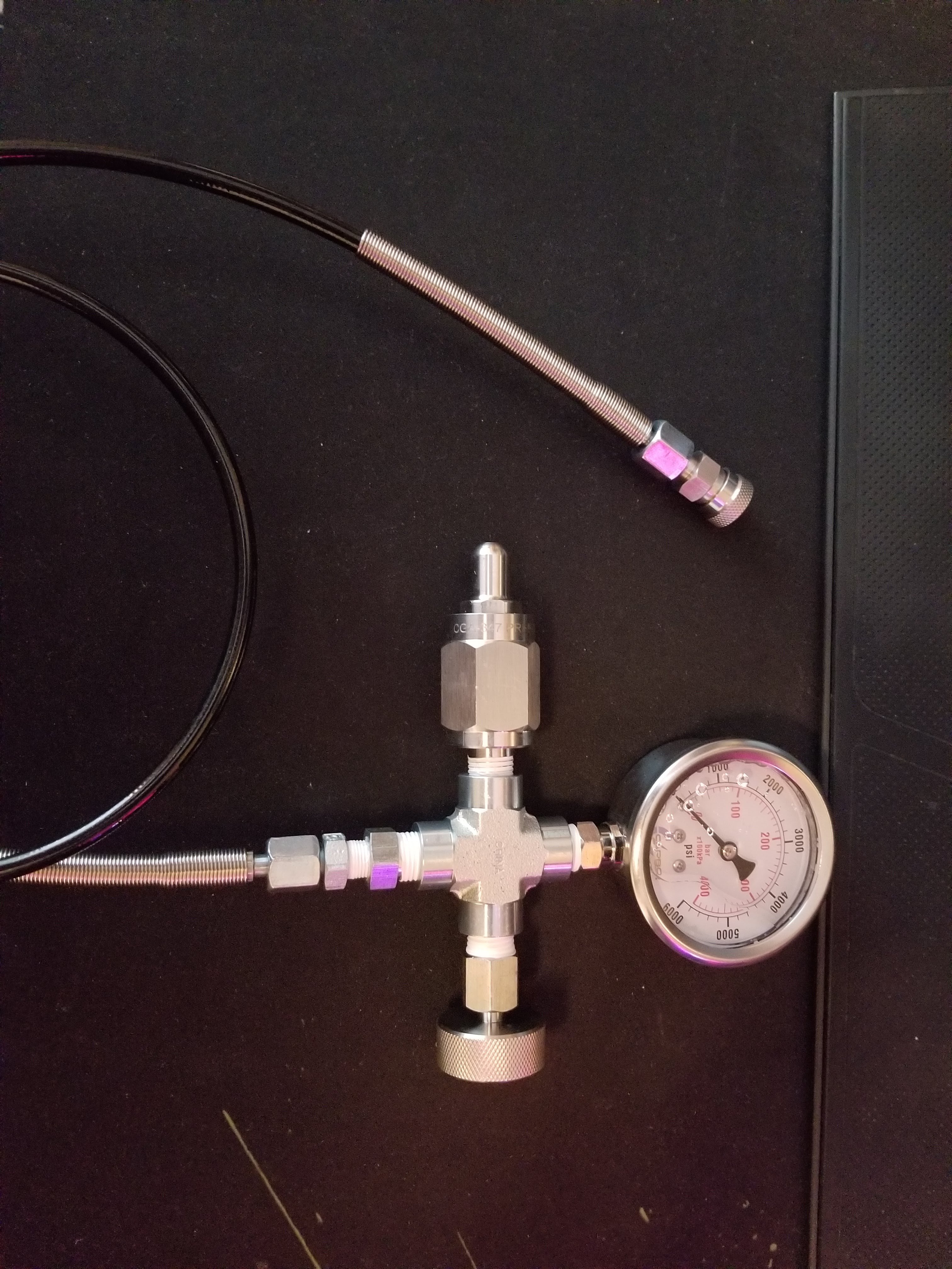

If I were to buy say a scott scba tank what would I need to get in order to fill it with my 4500 psi compressor and after that fill my pcp rifles.Complete everything.THANKS! I would like to get it right the first time
STAINLESS STEEL Female DIN300 (SCUBA) to Hand Tight STAINLESS STEEL Female SCBA / CGA347 Fitting. For filling SCBA tanks/valves at a SCUBA Dive Shop! MADE IN USA!
www.topgun-airguns.com
To fill your gun....has a gauge, bleed valve and hose....

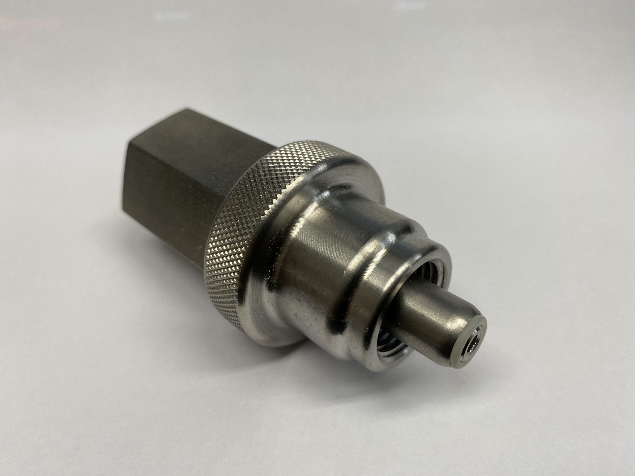

If you get a Scott you'll need a CGA347 fill adapter (if it has a standard SCOTT valve). Check ebay & search "CGA347 fill adapter", you'll find MANY. You might want to put in the words "hand tighten" to find the ones that don't need a wrench (ROUND tank valve nut as opposed to hex). Most come from China where quality control isn't great but I've NEVER gotten one that was so bad it wouldn't work by replacing an o-ring or smoothing a burr. I'd much rather spend 40 some dollars than $100+ at other places, but that's me.
