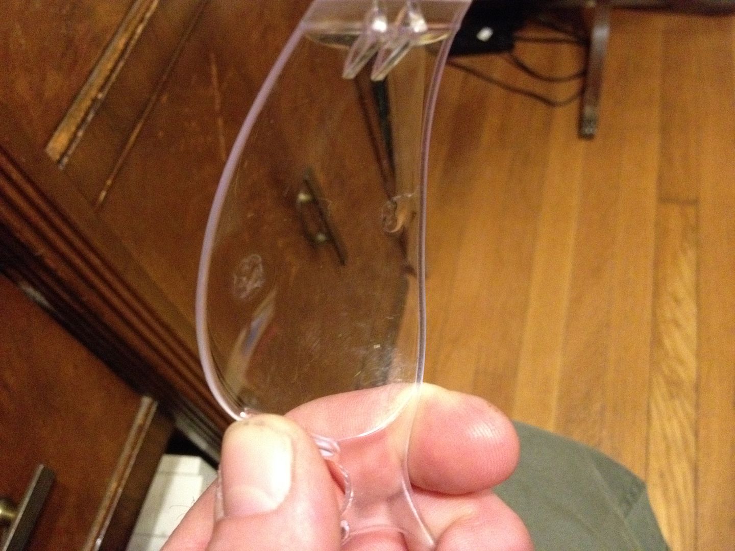

I recently worked on a project with my son's Cub Scout Pack that required safety glasses for everyone, so I purchased a bunch from Harbor Freight for 99¢/ea. I thought I'd try shooting a pair to see if they'd really stop anything. It's hard to get a good photo, but this is the result of the damage done from a .22 round from my P-Rod at about 5 yards. There's nothing special about my P-Rod. It's functionally a stock config. It's enough to kill squirrels, so I'd imagine it would do the same to your eyes if you're unlucky. So in summary, yes, if you're wearing safety glasses, they could actually very well save your eyes. I shot the glasses twice and it simply made a little dent. It did break an arm off of the glasses though.
Thanks for testing. An actual ricocheted pellet would have considerably less energy than a direct hit. So that would simulate a ricochet hit from a 30 FPE .22, IMO.
