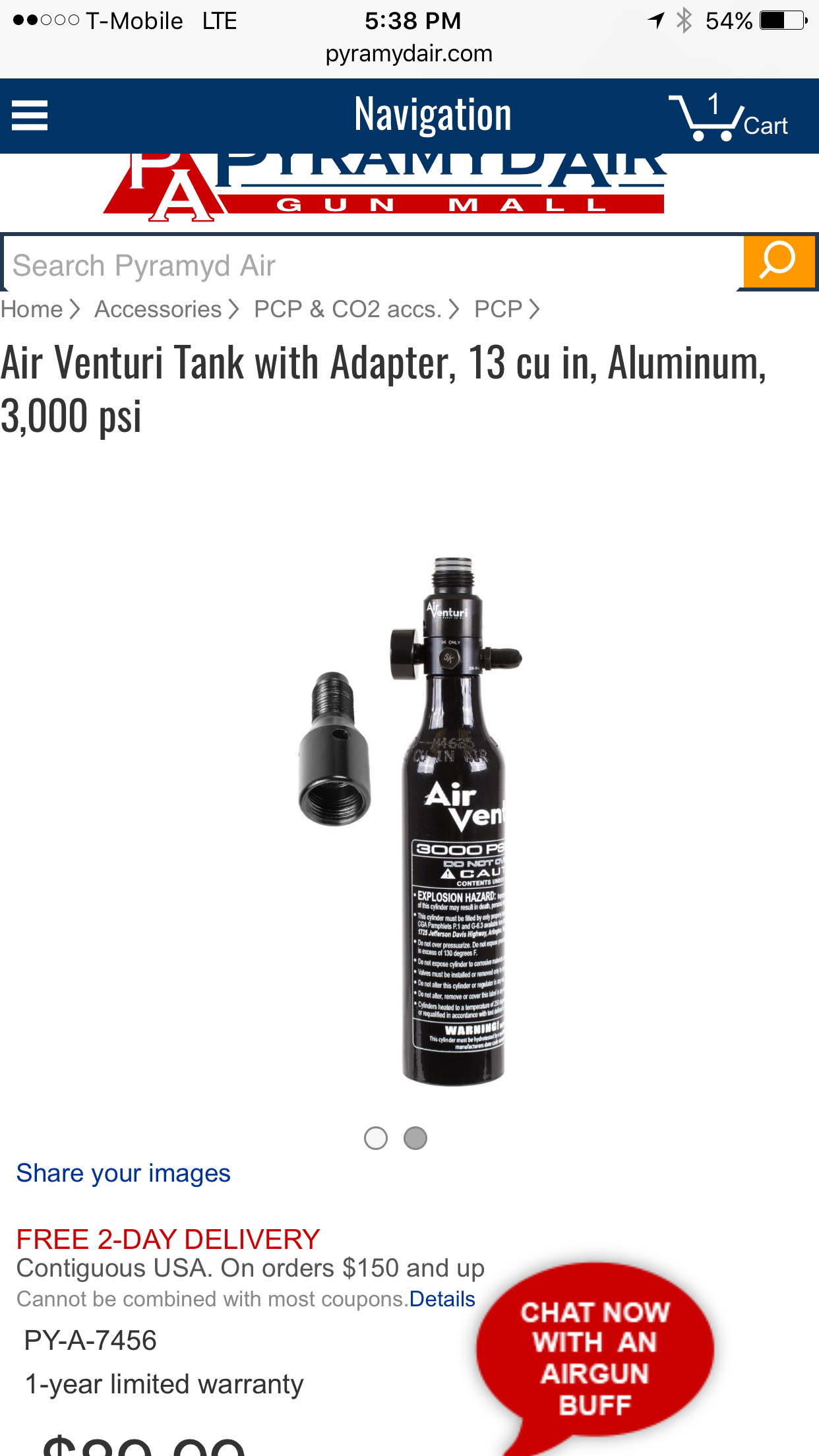

Hi All,
I have a stock 850 in 177 and I'd like to convert it HPA. Is this all I need??
Or am I missing something?
The tank is regulated to 1100 psi output will I be ok without modding internals??
I've read on the forums some people mention a spring from Roald at the 850 store?
Anyone with a similar setup that might be able to tell me what kind of shot count and fpe energy should be expected??

Hi Erik,
I have an 850. I'm pretty sure that will fit with the adapter it comes with. Only thing is that it's not very high pressure. You're not going to get much of an increase in energy. Of course, it won't be affected by temperature the way CO2 is.
I think these Air Venturi tanks are about $100, yes? For $250 more you could get it converted to HPA by Roald, which also includes the full tune. Will be shooting the 15.89 gr JSB's at 900 fps+ for 75 - 80 shots and it's regulated. Check out his web site, The 850 Store.

No, because his is .177. He might get more shots though.

Erik, the Air Venturi bottle will fit with the adapter in terms of threads, but with the fill nipple sticking out like that, I think you'd have to cut some of the plastic on the stock away. Power will be about the same as CO2.
Agree with Smaug that a Roald conversion would be better, unfortunately, he's not doing HPA conversions on 850's anymore as he can't get the parts.
