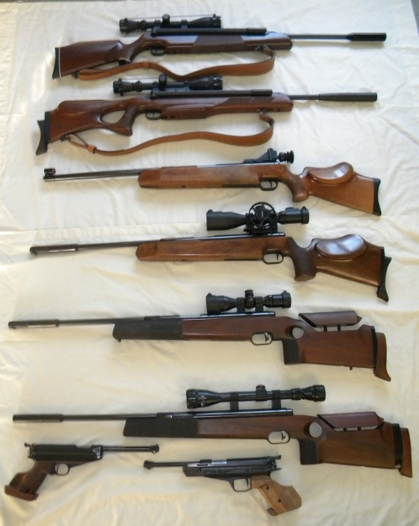

Here are some of my sidelever recoiless.
1541024213_12440630765bda29d5e42d10.54895956_147 Side levers- RWS54, 56, FWB 150T, 300ST, 300S...JPG
Not to threadjack but...
I have and love both as well. They are the same from a noise aspect. The 56 may be easier to mount a moderator to since it has a threaded end. My 56 was tuned and setup by Hector Medina and I will likely be putting it up for sale to pay for another PCP I probably shouldn't have purchased. Hit me up via text at 707-362-7711 if interested.
