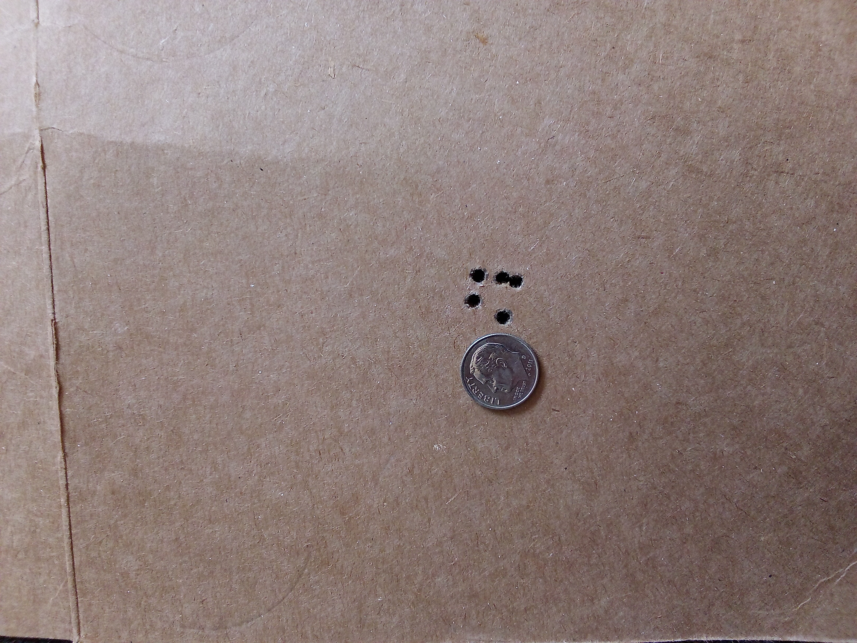

I've been experimenting with 177 slugs off and on with my RTI compact. Not getting to serious about it. I done some barrel work and had JSB KO 10.3 or 13gr shooting pretty good but not as well as it shoot pellets. I thought that was good enough and took it pesting. It done a good job but I thought maybe I could get it to shoot slugs better. I removed the barrel and went to polishing it a bit more. Concentrating on a tight spot I found just up from the breech and a bit on the choke. Meanwhile I had ordered some 13gr zan slugs I wanted to try (already had 13gr JSB KO slugs) the zan slugs came in and I had time today to shoot/tune my rifle to see if zan slugs shot good.. today was a bit windy. I went for it anyway. Zan slugs shoot great! Even the JSB KO groups improved. They both seem to prefer the reg set at 120 bar (don't remember HS setting) giving me 920fps. I had it shooting a bit more hot (980fps) but it just sounded better at present tune (920fps) I now have a great 177 slug shooter... this is my 80 yard group from earlier this afternoon. Starlings beware!!

I've been experimenting with 177 slugs off and on with my RTI compact. Not getting to serious about it. I done some barrel work and had JSB KO 10.3 or 13gr shooting pretty good but not as well as it shoot pellets. I thought that was good enough and took it pesting. It done a good job but I thought maybe I could get it to shoot slugs better. I removed the barrel and went to polishing it a bit more. Concentrating on a tight spot I found just up from the breech and a bit on the choke. Meanwhile I had ordered some 13gr zan slugs I wanted to try (already had 13gr JSB KO slugs) the zan slugs came in and I had time today to shoot/tune my rifle to see if zan slugs shot good.. today was a bit windy. I went for it anyway. Zan slugs shoot great! Even the JSB KO groups improved. They both seem to prefer the reg set at 120 bar (don't remember HS setting) giving me 920fps. I had it shooting a bit more hot (980fps) but it just sounded better at present tune (920fps) I now have a great 177 slug shooter... this is my 80 yard group from earlier this afternoon. Starlings beware!! View attachment 335348

I honestly don't know... I originally bought it as a 25cal with the 400mm long barrel (RTI compact). Sooo... Possibly a 4mm. I also swap on a 510mm 22cal barrel.. ( I prefer a 22 for small game and pesting) but the 177 shooting slugs has proven to be very capable. My barrel is the LW that had a tight choke.. I used bore paste and bore polish to open up the choke some..and take care of a right spot near the breach.. ( it took a while to do as I was taking my time) I tend to use my adjustable regs to find what bar I need for a give pellet/slug to shoot well. With 13gr zan slugs my rifle preferred it at 120-125 bar.. once I know this I ordered a fix reg for it. ( I have 3 RTI rifles and use fixed regs on them all. I have a lot less creep with a fixed reg) in my early experiments with slugs I read and watched videos of people cranking up the pressure to 150+ for slug shooting.. i couldn't get mine to shoot well with it cranked up so high .. I possibly could have if I had added some weight to the hammer to make it work but it worked out very well with a factory hammer weight and spring with a 125 bar reg setting.
