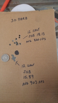

Its Looking better !
i took my gun completely apart today and some things I found after looking at a fx diagram. The hammer adjuster they call it in diagram was in backwards . it's the long bolt looking piece the spring goes over .it was at the hammer end of the spring instead of adjusting end . worked fine that way without the regulator but dumped way to much air with the reg .
i think I may be able to get it better but I'm pretty happy with it right now . I also found the valve the hammer hits was sticking a little. Maybe that was Nothing when spring and stuff was together but it would catch when sliding it in and out while tore apart.
after inspecting it better I could see a scratch on the fat end of the stem . I just chucked it up in my drill and polished it with 600 grit sandpaper. Slid free after that. Insides of gun was pretty dirty to.
looked like the lead dust you see inside your moderator ?
This was the 1st time I had it this far apart . I bought it used about a year ago .
anyway here's what I got with it today .
