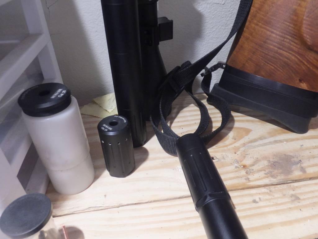

The shroud on those is not very far off of the muzzle. The muzzle should have 1/2"-20 threads. I have one of those barrels, and wish it was shorter. Putting a mod directly on it at an efficient length makes it quite long indeed. One option would be a huma mod. You can make them VERY short. I mean about 2.4" if you want. And if you only need a bit of sound reduction it will absolutely do the job.
