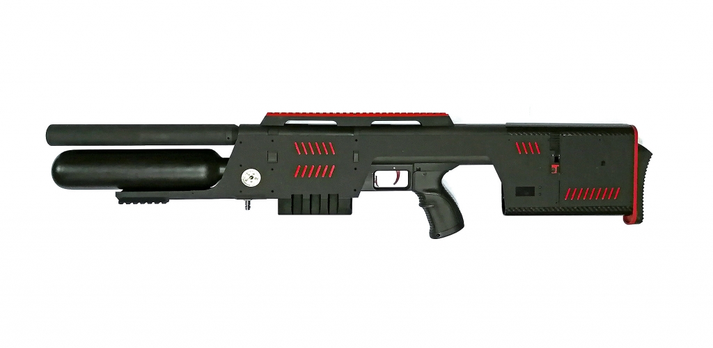

This is the very first mass-produced model of Gorilla PCP. Model index B16S.
Gorilla is the first pneumatic SMARTGUN in the world. You can shoot slugs and pellets in single, semiauto, full auto mode. It has elecronic regulator and hammer, all adjustments of this airgun is made with mobile app. Adjusting the settings from slugs to pellets (and all other settings) are made in few seconds with your smartphone application. You can save up to 10 setups of fire - for example in .22 caliber (1) for 1,03g pellets, (2) for 1,645g pellets, (3) for 2,0g slus and (4) for 2,6g slugs.
After saving all the setups you need - you can use your Gorilla without any smartphone - change the modes by clicking the buttons on Gorilla.
It has different fire modes - single fire mode for singletray shooting, semi-auto, full auto with adjustable cut-offs (from 2 to 10). The magazine in .22 caliber includes 26 chamber for pellets or slugs. Regulated power available for .22 caliber above 125 Joules. The speed of full auto shooting is 480-520 shots per minute.

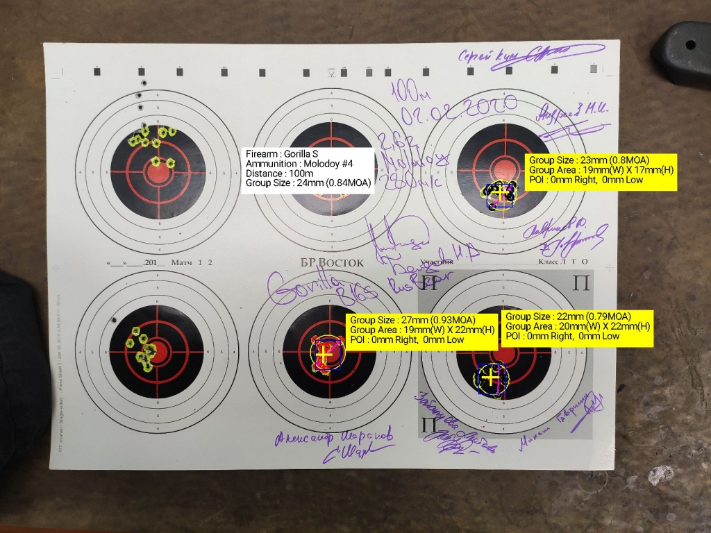

Semiauto mode, 40gr slugs, 110 yards, three ten shots groups - 0,84 MOA average. A lot of witnesses were there, because we understand that the result is unbelievable.

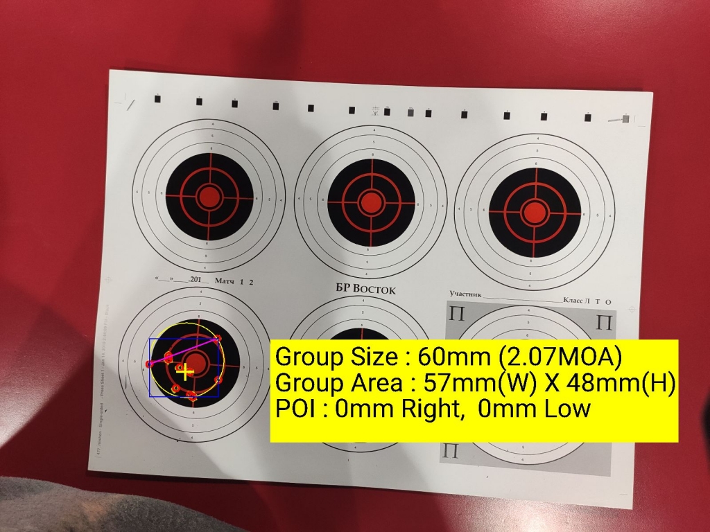

Full auto mode, 2 shots cut-off. 40gr slugs, 110 yards, 5 groups to 1 target (10 total shots) - 2.07 MOA.

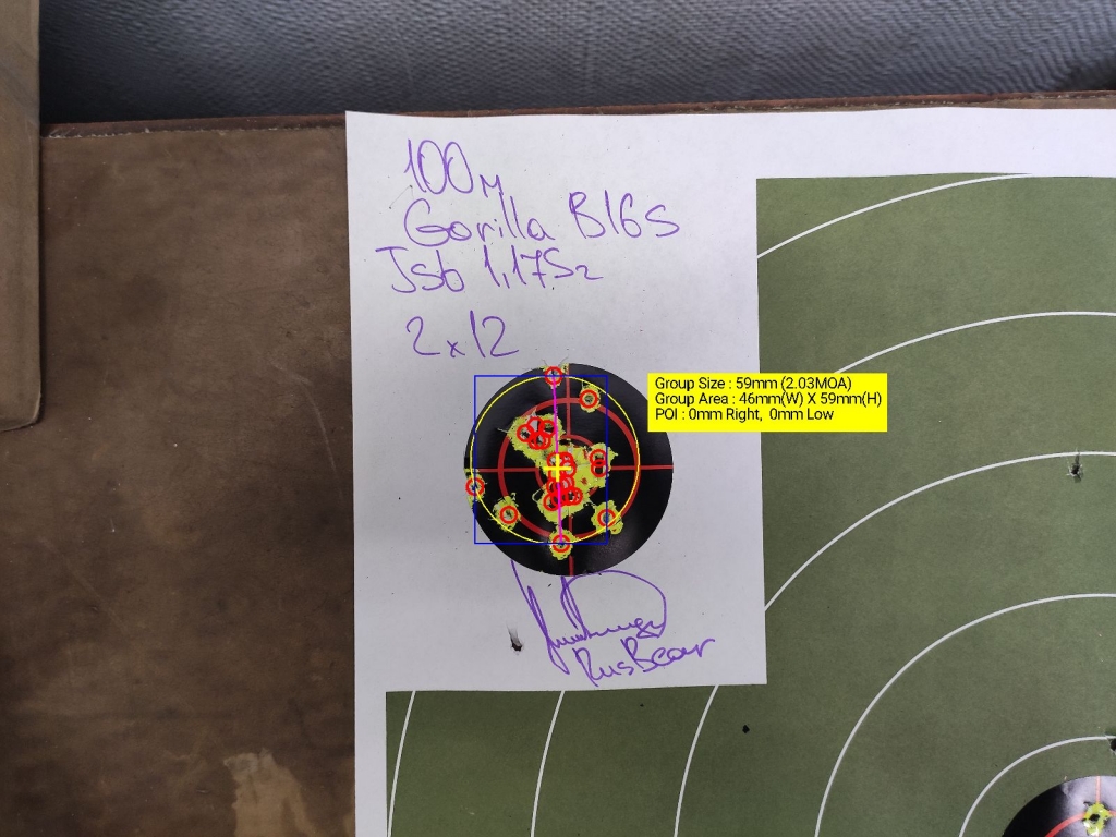

Full auto mode, 2 shots cut-off. 18gr pellets, 110 yards, 12 groups to 1 target (24 total shots) - 2.03 MOA.

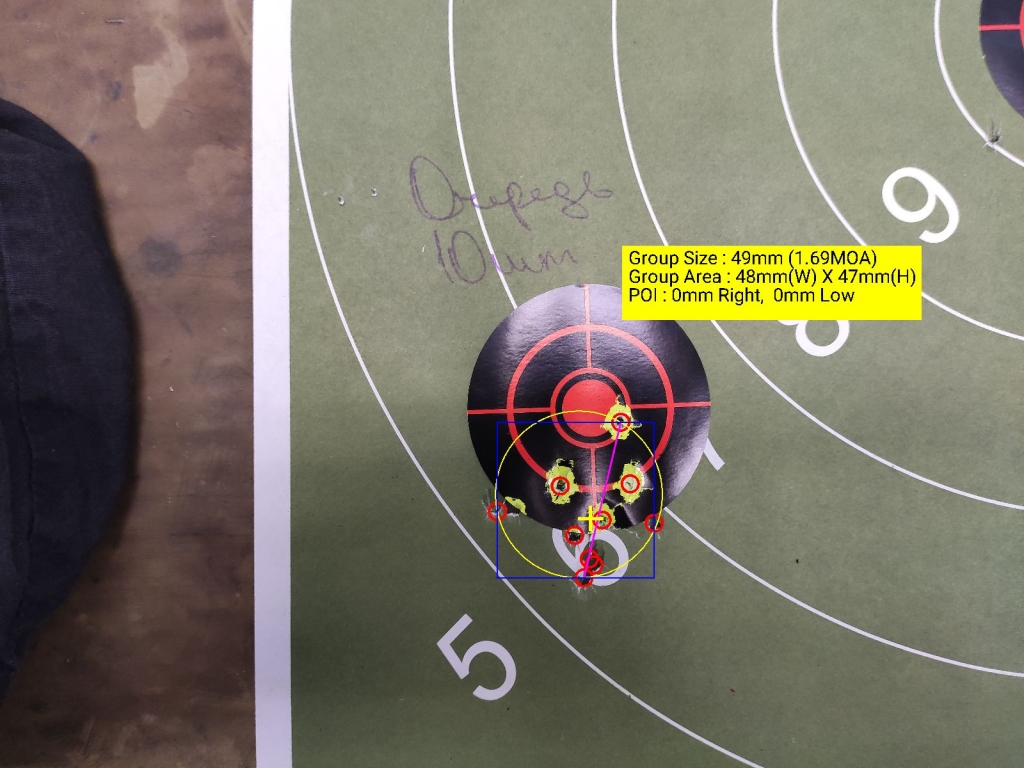

Full auto mode, 10 shots cut-off. 18gr pellets, 110 yards - 1.69 MOA !!!

This is S (sports) modification for Benchrest shooting and it is rather heavy - about 9-10 pounds without the score. But as you, probably, remember my EBR gun weight was about 2 times heavier, and it didn't bother me shooting Field Target on EBR.
This gun has no choke. I've prepared it's barrel myself (all barrels on S models will be prepared so) and it is really good and universal. To tell you the truth I didn't expect it to be so good with slugs and pellets at the same time.

Whats the thing that is hanging down between the bottle and trigger? What is the rectangular hole in the butt?
